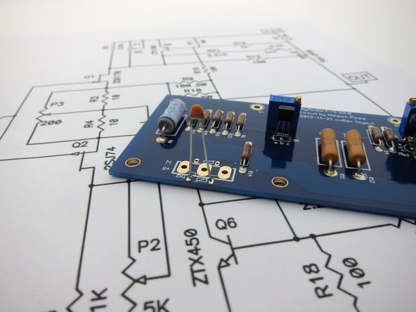

  1. Print this out and have in front of you at all times. Image 1) This is the schematic for the amplifier section.
    • Print this out and have in front of you at all times.
    • Image 1) This is the schematic for the amplifier section.
    • Image 2) Schematic for the PSU section.

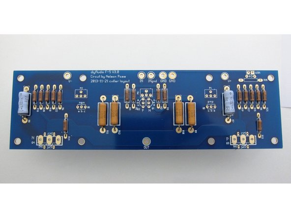

  2. Photo 1) The current F5 PCB from the diyAudio store. It has the inclusion of potentiometer P3, and is the third revision of this board, hence "F5v3" Photo 2) Right - PCB bag. Left - Kit of F5 parts. Photo 3) The parts kit includes everting for the amp PCBs except the input Jfets and the LED
    • Photo 1) The current F5 PCB from the diyAudio store. It has the inclusion of potentiometer P3, and is the third revision of this board, hence "F5v3"
    • Photo 2) Right - PCB bag. Left - Kit of F5 parts.
    • Photo 3) The parts kit includes everting for the amp PCBs except the input Jfets and the LED

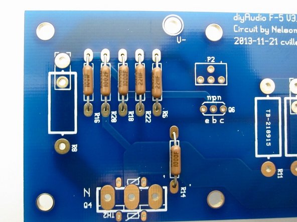

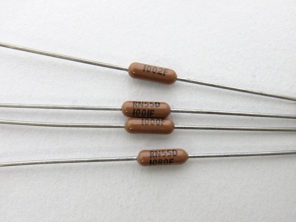

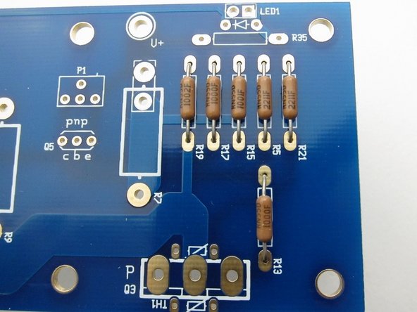

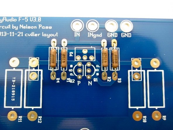

  3. The Dale resistors have thier value printed on the side, the code is 3-digit + multiplier at values greater than 100ohm, and below 100ohm the "R" is the decimal. So, from top to bottom you see  10K (100+2 zeros, 10000ohm) 1K (100+1 zero, 1000ohm) 100 ohm (100+0 zeros, 100ohm) 10.0 ohm (10R0, 10.0 ohm) Lead spacing for all small resistors is .5inch (12.7mm) Measure all resistors before inserting into the board. This greatly reduces errors.
    • The Dale resistors have thier value printed on the side, the code is 3-digit + multiplier at values greater than 100ohm, and below 100ohm the "R" is the decimal. So, from top to bottom you see 10K (100+2 zeros, 10000ohm) 1K (100+1 zero, 1000ohm) 100 ohm (100+0 zeros, 100ohm) 10.0 ohm (10R0, 10.0 ohm)
    • Lead spacing for all small resistors is .5inch (12.7mm)
    • Measure all resistors before inserting into the board. This greatly reduces errors.
  4. Take the time to bend all the leads so the value is visible, and align them all the same way for easy reading. Photo 1) left side Photo 2) center
    • Take the time to bend all the leads so the value is visible, and align them all the same way for easy reading.
    • Photo 1) left side
    • Photo 2) center
    • Photo 3) right side

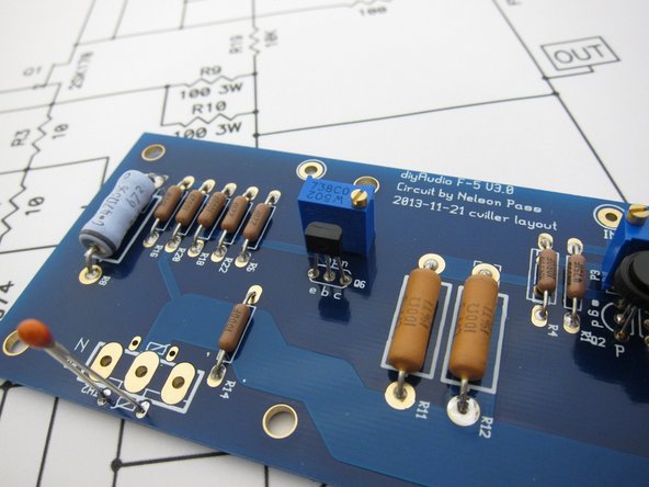

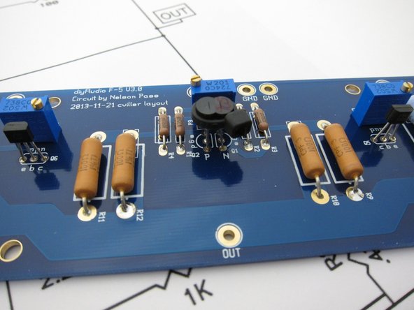

  5. Big resistors installed. Blue are 0.47ohm 3W, Orange are 100ohm 3W. Values printed clearly on the side of each resistor. Photo 2) PCB with just small resistors.
    • Big resistors installed. Blue are 0.47ohm 3W, Orange are 100ohm 3W. Values printed clearly on the side of each resistor.
    • Photo 2) PCB with just small resistors.

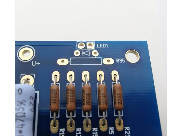

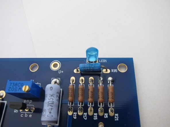

  6. Note that the parts kit does not include the LED or it's resistor, this is so you can choose that you prefer. I used blue and a 15K resistor
    • Note that the parts kit does not include the LED or it's resistor, this is so you can choose that you prefer.
    • I used blue and a 15K resistor

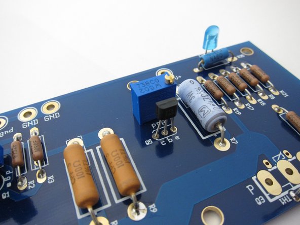

  7. Install the 5K pot and the ZTX450 on this side (Q6). Note the orientation of the transistor. The potentiometer value is almost the same code as the resistors - 502 is 50+2 zeros , 5000 ohms Q5 is the ZTX550, note orientation, and use another 5K pot here. The 200ohm pot mounts in the center, and the Jfets install as shown. The K170 is the N-channel, the J74 is the P-channel.
    • Install the 5K pot and the ZTX450 on this side (Q6). Note the orientation of the transistor. The potentiometer value is almost the same code as the resistors - 502 is 50+2 zeros , 5000 ohms
    • Q5 is the ZTX550, note orientation, and use another 5K pot here.
    • The 200ohm pot mounts in the center, and the Jfets install as shown. The K170 is the N-channel, the J74 is the P-channel.

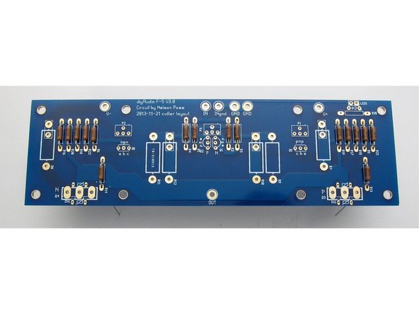

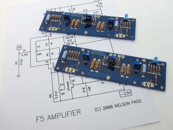

  9. At this point the amplifier PCBs should look like this - all components stuffed except power transistors, and the thermistors not bent.
    • At this point the amplifier PCBs should look like this - all components stuffed except power transistors, and the thermistors not bent.

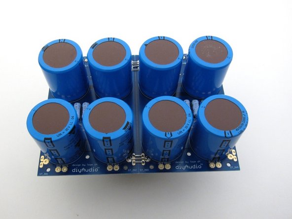

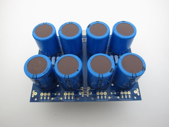

  10. This is the PSU board from the store, the diode section is snapped off and chassis mount diode bridges will be used to save space. Photo 1) input side Photo 2) center
    • This is the PSU board from the store, the diode section is snapped off and chassis mount diode bridges will be used to save space.
    • Photo 1) input side
    • Photo 2) center
    • Photo 3) output side

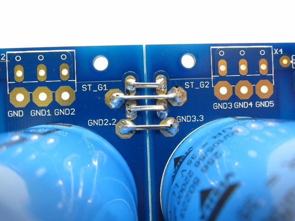

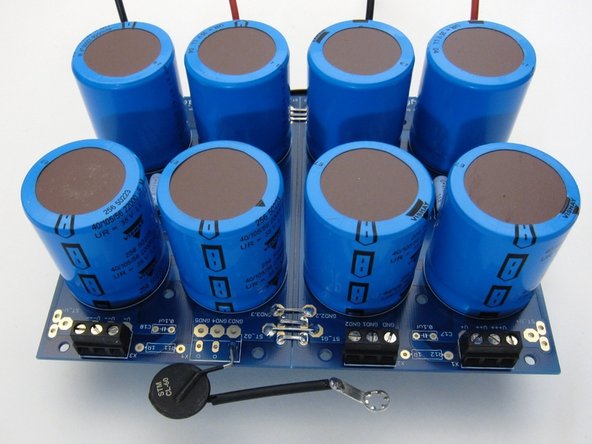

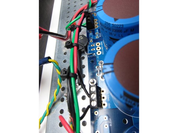

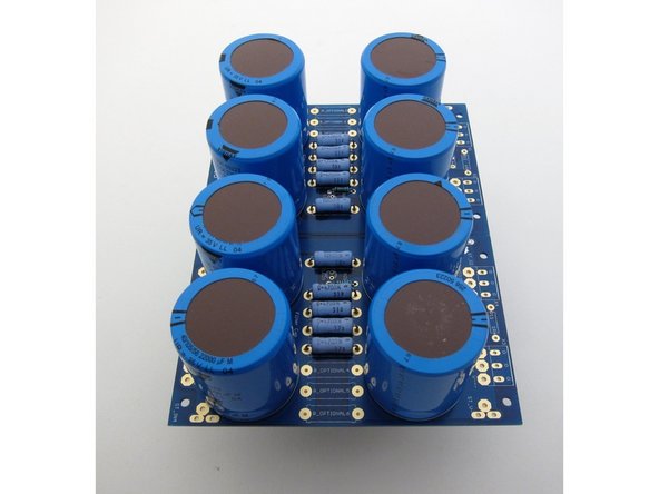

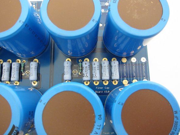

  11. Photo 1) Please connect the two sides of the ground as shown - it won't work properly without it. Use a few wires or lead cut-offs, to insure a solid, quiet, and low-impedance ground. Photo 2) Filter resistors, bleeder resistor, LED resistor. LED not stuffed, choose whichever color you like,  you could color code V+ and V-, or make them bright blue to fill the vent holes with color, it's up to you. You can stuff both connector blocks on ground, but if you use one, you will have all the grounds closer to the same place, acting somewhat as a 'star ground'.
    • Photo 1) Please connect the two sides of the ground as shown - it won't work properly without it. Use a few wires or lead cut-offs, to insure a solid, quiet, and low-impedance ground.
    • Photo 2) Filter resistors, bleeder resistor, LED resistor. LED not stuffed, choose whichever color you like, you could color code V+ and V-, or make them bright blue to fill the vent holes with color, it's up to you.
    • You can stuff both connector blocks on ground, but if you use one, you will have all the grounds closer to the same place, acting somewhat as a 'star ground'.
    • The CL-60 is acting as a ground loop breaker, elevating the amplifier circuit with a resistance above mains earth, but can flow current if there's a fault.

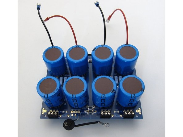

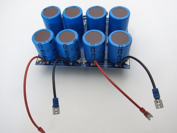

  12. PSU ready for installation. Blocks installed, wires to connect to diodes ready, thermistor with star washer. PSU ready for installation. Blocks installed, wires to connect to diodes ready, thermistor with star washer.
    • PSU ready for installation. Blocks installed, wires to connect to diodes ready, thermistor with star washer.

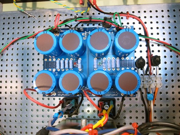

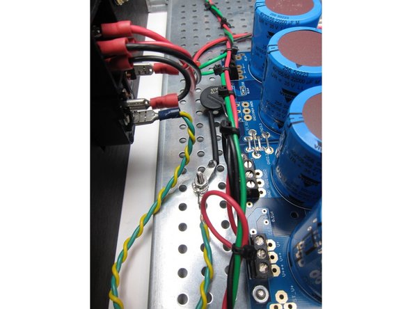

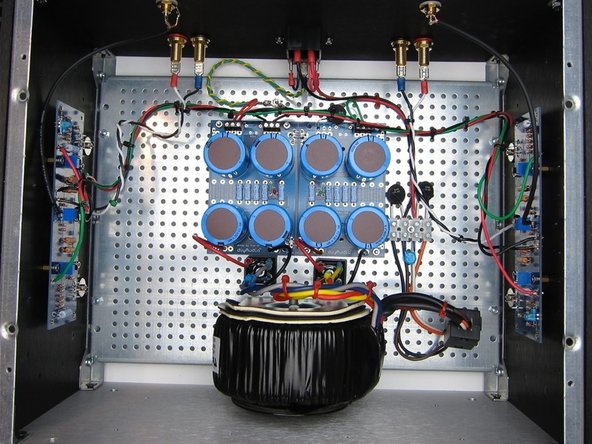

  14. Safety earth (Green Yellow) is connected from the power switch module to the chassis. Use a star washer to ensure a solid connection. Safety earth (Green Yellow) is connected from the power switch module to the chassis. Use a star washer to ensure a solid connection.
    • Safety earth (Green Yellow) is connected from the power switch module to the chassis. Use a star washer to ensure a solid connection.

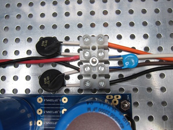

  15. Terminal block. 120VAC wiring shown. AC from switch in from left (Red Black) CL-60's, the blue disc is the X1/Y1 rated capacitor, and transformer primaries are out the right.
    • Terminal block. 120VAC wiring shown. AC from switch in from left (Red Black) CL-60's, the blue disc is the X1/Y1 rated capacitor, and transformer primaries are out the right.

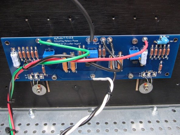

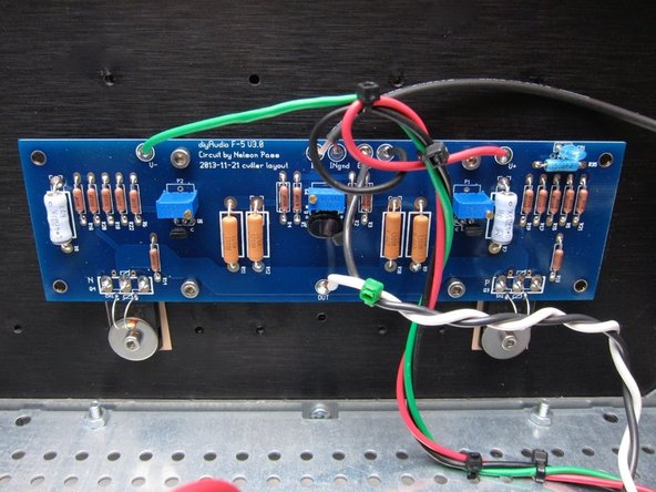

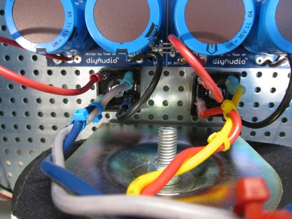

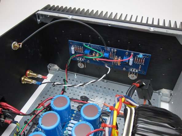

  16. Connections from amp PCB to back panel. Try to arrange the wires so they are not in the way of the potentiometers. Zip-ties are your friend! Note the small thermistors are bent down now and touch the washers holding the Mosfets.
    • Connections from amp PCB to back panel.
    • Try to arrange the wires so they are not in the way of the potentiometers. Zip-ties are your friend!
    • Note the small thermistors are bent down now and touch the washers holding the Mosfets.

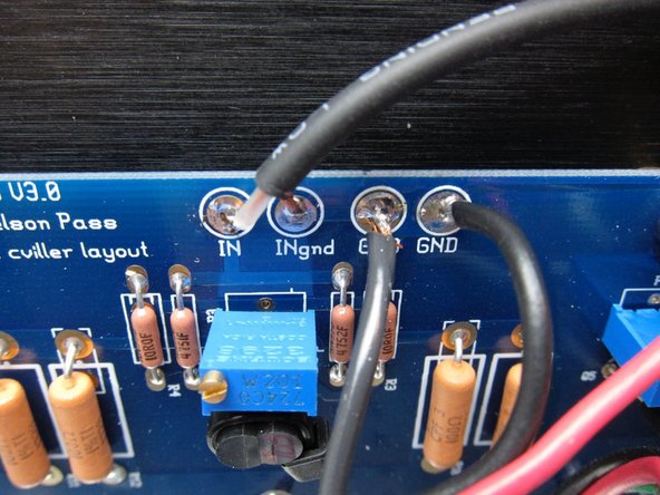

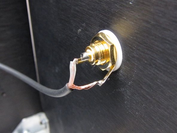

  17. The PCB connections to GND are all tied together, but it's still nice to have individual holes for the wires. Input ground from the RCA jack, speaker, PSU. Photo 2) RCA wiring
    • The PCB connections to GND are all tied together, but it's still nice to have individual holes for the wires. Input ground from the RCA jack, speaker, PSU.
    • Photo 2) RCA wiring

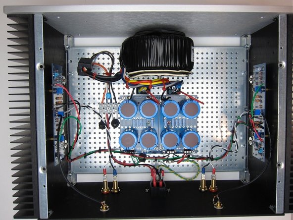

  18. Photo of completed amp. Photo of completed amp.
    • Photo of completed amp.
