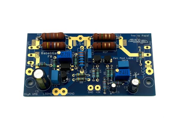

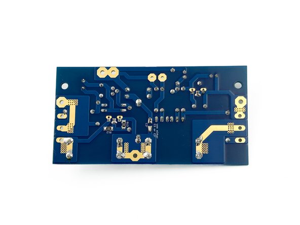

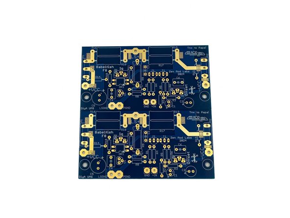

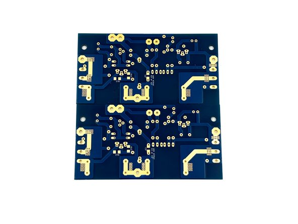

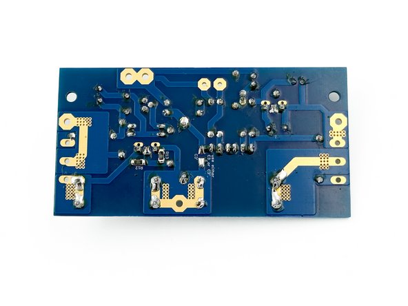

  4. Look over your boards and get familiar with the parts placement.  Check the board against the schematic. Both boards are identical. Image 1 - Front view of the PCBs.
    • Look over your boards and get familiar with the parts placement. Check the board against the schematic. Both boards are identical.
    • Image 1 - Front view of the PCBs.
    • Image 2 - Back view of the PCBs, sometimes referred to as the solder side. You will install two SMD resistors on the back of the board.
    • Clean both sides of the board with isopropyl alcohol or your favorite PCB cleaner. A dust and oil free board helps the solder to flow nicely.
    • Ambitious DIYers may trace the board with a DMM in continuity mode against the schematic. It's not necessary, we've done it for you, but give it a try.

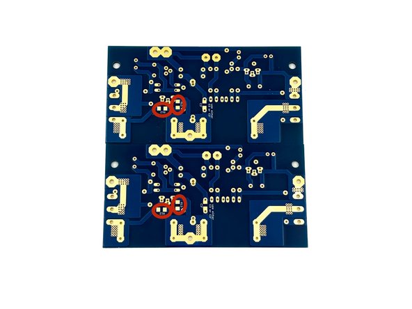

  5. Installing the SMD resistors (R12 and R13) is not as challenging as many people think. Take your time. If you do not have a preferred SMD installation method, the steps that follow work perfectly for many people.
    • Installing the SMD resistors (R12 and R13) is not as challenging as many people think. Take your time. If you do not have a preferred SMD installation method, the steps that follow work perfectly for many people.
    • Magnification and good lighting are critical to success.
    • For these pads and resistors of this size, micro-sized iron tips and ultra-thin solder are not necessary. The video demonstrates using Cardas Quad Eutectic solder and a typical chisel tip used for through-hole soldering.
    • Be very careful when opening the strip of parts. It is recommended to carefully open one part at time over a mat or into a bowl.
    • Photo 1 - The parts go on the back of the boards
    • Wet one of the pads for each resistor with a small amount of solder.
    • Using tweezers, gently place the part next to the pad, maintaining control of the part. One common error is squeezing the tweezers too tightly. A very light pressure is all that is needed.
    • Heat the solder, and slide the part into the molten solder.
    • Ensure the part is placed to your satisfaction before moving forward. If the part needs a small adjustment, reheat the pad and adjust the part.
    • The parts do not need to be perfectly aligned.
    • Once the part is oriented to your satisfaction and covering both pads, solder the other side of the part to the open pad.
    • Touch up the original joints if necessary. If you've used a solder with a lower percentage of flux / rosin, adding liquid flux / rosin may be appropriate to ensure perfect joints.
    • Video 1 - Installation of R12 and R13

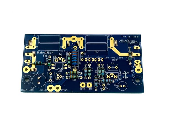

  6. Remember to measure the resistance for every part before installation.
    • Remember to measure the resistance for every part before installation.
    • It is helpful to use a lead forming tool. The pitch for the small resistors is 10mm. The pitch for R9 is 15 or 18mm. Use either set of pads for R9.
    • Having all the resistors oriented the same way helps tremendously with troubleshooting. In this build, the bands will read from left to right or bottom to top. The thick brown band is "band 5" for these resistors.
    • Install all the small resistors along with R9. It's not strictly necessary, but leaving a small amount of space between R9 and the PCB is a good idea.
    • Photo 1 - The boards should look like this.

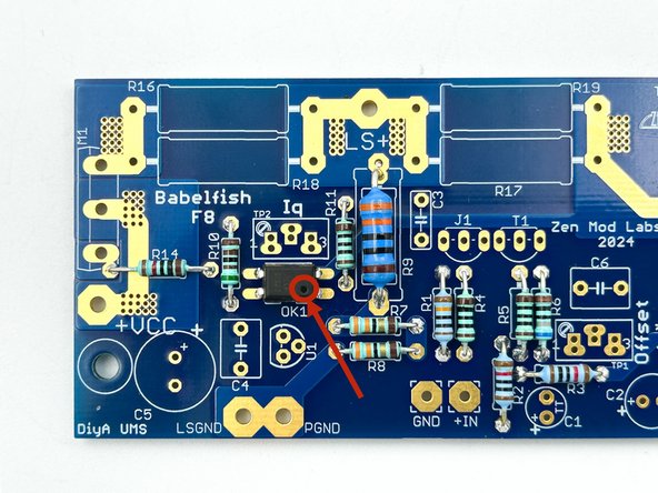

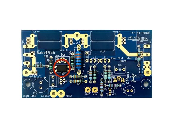

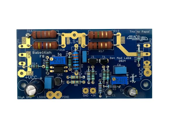

  7. Ensure you pay attention to the small dot on the PCB and the optoisolator. They must be aligned. Photo 1 - Notice the location of the dot (Pin 1).
    • Ensure you pay attention to the small dot on the PCB and the optoisolator. They must be aligned.
    • Photo 1 - Notice the location of the dot (Pin 1).
    • Install OK1 on both boards.
    • Photo 2 - OK1 installed

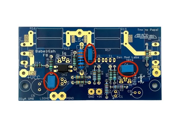

  8. There are two values of film capacitors. They should be very simple to sort by size and quantity.
    • There are two values of film capacitors. They should be very simple to sort by size and quantity.
    • Install C3, C4, and C6
    • Photo 1 - Film Caps Installed

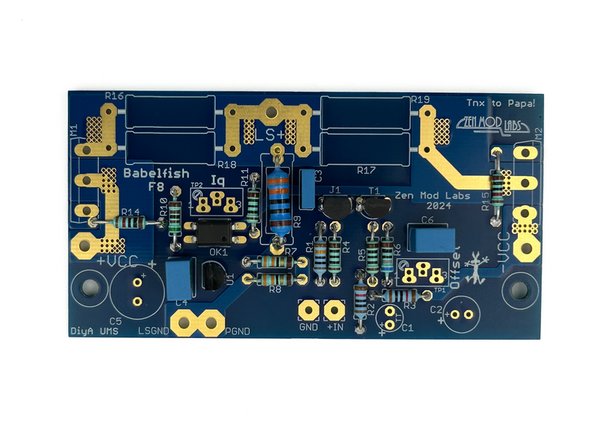

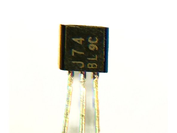

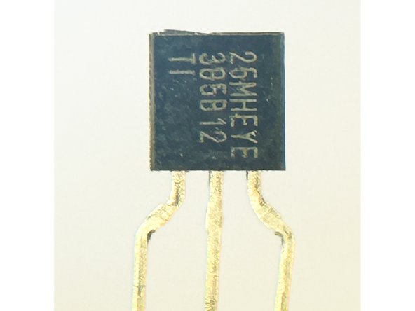

  9. The kit comes with 3 types of transistors in a TO-92 package. It is critical to separate them and install them in the proper locations. Using any appropriate magnification, separate the transistors. Key markings are J74, B556, and 385B12 Photo 1 - 2SJ74 - P-channel JFET
    • The kit comes with 3 types of transistors in a TO-92 package. It is critical to separate them and install them in the proper locations.
    • Using any appropriate magnification, separate the transistors. Key markings are J74, B556, and 385B12
    • Photo 1 - 2SJ74 - P-channel JFET
    • Photo 2 - B556 - PNP BJT
    • Photo 3 - LM385 1V2 Voltage reference
    • Note - Lot codes and date codes will differ
  10. Note the shape of the part outline on the PCB. Install the parts in alignment with the silkscreen.
    • Note the shape of the part outline on the PCB. Install the parts in alignment with the silkscreen.
    • Install the parts marked J74 for J1
    • Note - You may choose to install your JFETs further above the boards. This will allow you to more easily reuse them, if you ever decide to use them in another project.
    • Install the parts marked B556 for T1
    • Install the parts marked 385B12 for U1
    • Photo 1 - All TO-92 package devices installed

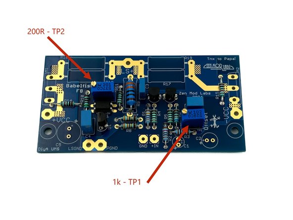

  11. It is critical to identify and separate the two values of the potentiometers.
    • It is critical to identify and separate the two values of the potentiometers.
    • The potentiometer marked with a "102" is the 1k pot.
    • The potentiometer marked with a "201" is the 200R pot.
    • Install the 1k pot for TP1
    • Install the 200R pot for TP2
    • Photo 3 - Pots Installed

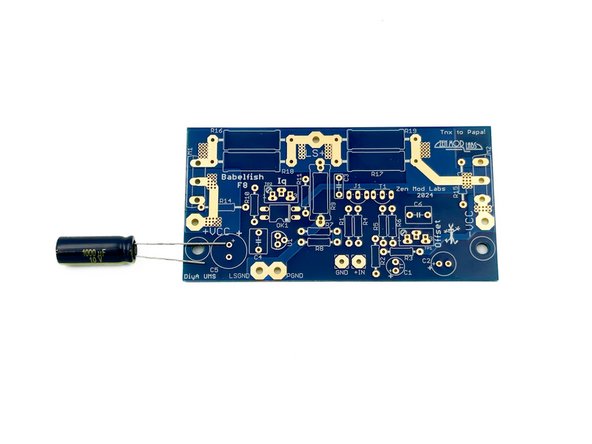

  12. Verify the orientation of the electrolytic capacitors!  The negative side a.k.a. the cathode is indicated with a band.  The cathode lead is the shorter of the two leads.  The positive side a.k.a. the anode is the longer of the two leads. Photo 1 - Long lead goes into the hole marked with the +.
    • Verify the orientation of the electrolytic capacitors! The negative side a.k.a. the cathode is indicated with a band. The cathode lead is the shorter of the two leads. The positive side a.k.a. the anode is the longer of the two leads.
    • Photo 1 - Long lead goes into the hole marked with the +.
    • Install C1, C2, and C5
    • Photo 2 - Electrolytic caps installed
  13. If you do not have a precision DMM known to work at lower resistances, it is recommended to trust the color bands on the resistors.
    • If you do not have a precision DMM known to work at lower resistances, it is recommended to trust the color bands on the resistors.
    • It is advised to raise the 3W resistors above the board a few mm. Use anything you may have available as a spacer.
    • Install R17 - Brown, Black, Gold, Gold - 1R
    • Install R18 - Yellow, Purple, Silver, Gold - 0R47
    • Install R19 - Brown, Green, Gold, Gold - 1R5
    • Install R16 - Blue, Gray, Silver, Gold - 0R68
    • Photo 1 - Large resistors installed.

    • By this point, if you haven't already, take a break and triple check your work.
    • Wise and careful builders will have noted that each and every part except the output MOSFETs have been verified, installed, and inspected.
    • This is also a perfect time to clean the back of the boards if you haven't been meticulously cleaning each joint as part of your inspection process. If you're using most popular solders, the boards don't strictly require cleaning, but it is much easier to inspect the joints if they're clean. Plus, it looks nice.
    • Note - 99%+ Isopropyl Alcohol and Kimwipes were used to clean the boards in the photo; nothing aggressive or toxic.
    • Photo 1 - Dirty
    • Photo 2 - Clean.

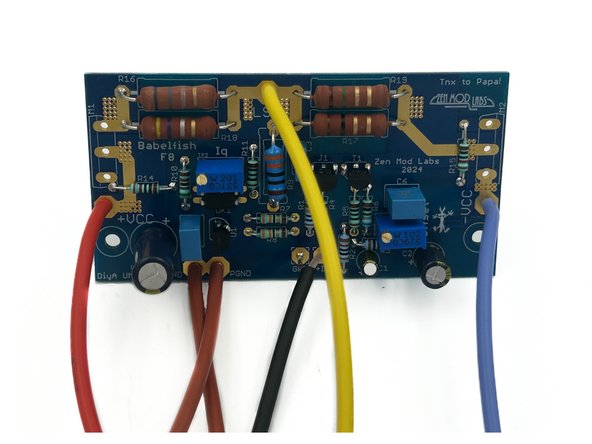

    • Wire can be a controversial subject. Choose your favorite, and others will do the same. The recommendations below are excellent choices if you don't already have a favorite.
    • DC Supply and Speaker Wiring
    • Stranded 18AWG or larger. Solid core wire is not recommended. The boards will comfortably allow 16AWG.
    • Silicon or PTFE insulation is nice to have in the case of a wandering soldering iron tip. Silicon tends to be more flexible at the expense of twists wanting to untwist. PTFE tends to be a bit more stiff, but twisted wires will generally retain their shape.
    • Input - 20 to 30 AWG. Copper or Silver. Twisted pair or shielded coax. Solid Core or Stranded. A common choice that works well is salvaged CAT5 / CAT6 etc. from spare ethernet cables.
    • Choose your wire types and colors. It is wise to choose and use consistent colors that you can remember across your many future builds, particularly for power wiring. This example uses:
    • 16 AWG multistrand with silicon insulation:
    • Red for +VCC (Positive DC Rail or V+)
    • Blue for -VCC (Negative DC Rail or V-)
    • Brown for LSGND and PGND (Loudspeaker Ground and Power Ground)
    • Yellow for LS+ (Loudspeaker Signal)
    • Mogami 2330 for +In and GND (Input Signal and GND)

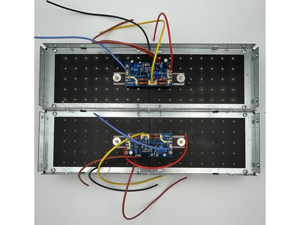

  15. You may want to do an initial layout with your chassis and PSU to estimate wire length. As one example, builders using the Universal PSU will require longer PSU wiring than those using the Simple Linear Bipolar Power Supply.
    • You may want to do an initial layout with your chassis and PSU to estimate wire length. As one example, builders using the Universal PSU will require longer PSU wiring than those using the Simple Linear Bipolar Power Supply.
    • Cut your wires roughly to length and solder them to the amp PCBs. Err on the side of caution for wire length, and remember some wires will be twisted. Wire stretchers do not work well.
    • Photo 1 - All wires installed

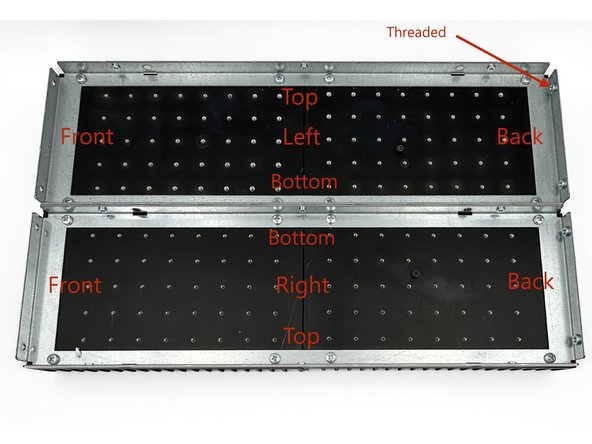

  17. The heatsinks have a back and front.   Once you choose left and right, they now have a top and bottom. It is generally preferred to have the input wiring toward the top. The threaded holes in the brackets are for mounting the back panel. Photo 1 - Heatsink orientation.
    • The heatsinks have a back and front. Once you choose left and right, they now have a top and bottom. It is generally preferred to have the input wiring toward the top. The threaded holes in the brackets are for mounting the back panel.
    • Photo 1 - Heatsink orientation.

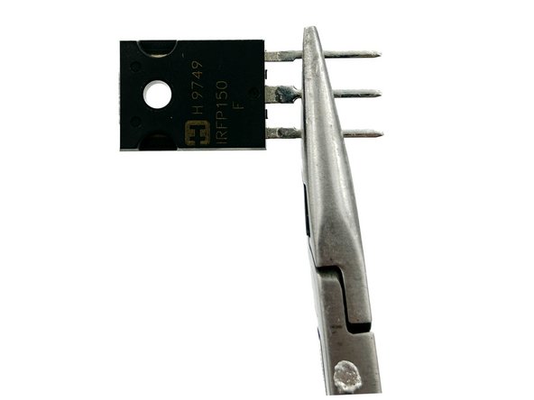

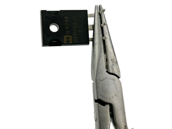

  18. Photos 1, 2, and 3 - It is simple to get a proper bend in the MOSFET legs, but care must be taken.  These photos illustrate a proper sequence.  The part is held just below the narrowing point in the legs, and the legs are bent to 90 degrees. Ensure that the lettering is up and the metal tab is down.  You will bend toward the lettering.  It is easy to adjust the angle slightly, but bending them back in the entire opposite direction may result in premature failure due to metal fatigue. Bend all three leads of your MOSFETs to a 90 degree angle as shown.  They don't need to be perfectly 90 degrees.  Just get it close.
    • Photos 1, 2, and 3 - It is simple to get a proper bend in the MOSFET legs, but care must be taken. These photos illustrate a proper sequence. The part is held just below the narrowing point in the legs, and the legs are bent to 90 degrees.
    • Ensure that the lettering is up and the metal tab is down. You will bend toward the lettering. It is easy to adjust the angle slightly, but bending them back in the entire opposite direction may result in premature failure due to metal fatigue.
    • Bend all three leads of your MOSFETs to a 90 degree angle as shown. They don't need to be perfectly 90 degrees. Just get it close.

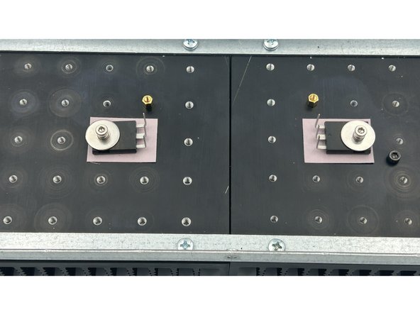

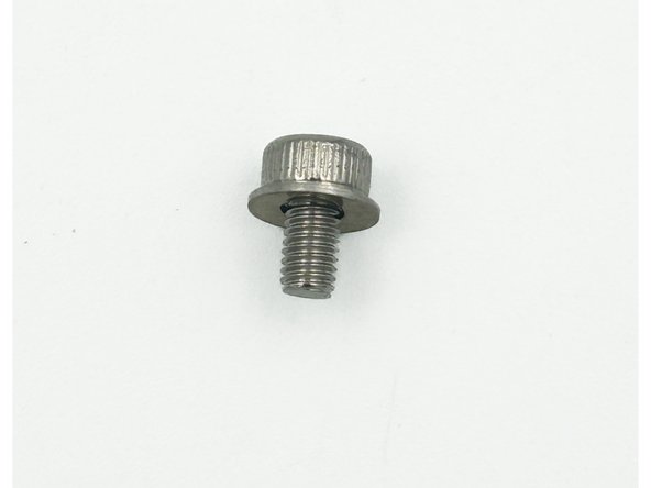

  19. The MOSFETs are mounted to the heatsinks using M3 bolts, fender washers, and split washers from the back panel parts kit. Keratherm is the insulator of choice. The correct MOSFET mounting holes can be found by laying the PCB onto the standoffs and inserting a MOSFET. All builders have their own sequence. One that works well for many is:
    • The MOSFETs are mounted to the heatsinks using M3 bolts, fender washers, and split washers from the back panel parts kit. Keratherm is the insulator of choice. The correct MOSFET mounting holes can be found by laying the PCB onto the standoffs and inserting a MOSFET.
    • All builders have their own sequence. One that works well for many is:
    • Place the split washer and the fender washer over the bolt.
    • Photo 1 - The split washer sits against the head of the bolt.
    • Place the MOSFET over the bolt with the tips of the legs toward the head of the bolt.
    • Gently place a piece of Keratherm over the bolt.
    • Gently thread the bolt into the heatsink. Align the Keratherm under the MOSFET. Tighten the bolt leaving it loose enough to rotate the MOSFET.

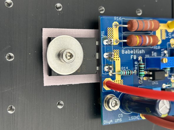

    • Photo 2 - MOSFETs mounted loosely to the heatsinks.
  20. Gently slide the PCBs over the MOSFET legs. Mount the PCBs to the standoffs using the short M3 bolts in the back panel parts kit and an M3 washer. There is no reason to over-tighten.
    • Gently slide the PCBs over the MOSFET legs.
    • Mount the PCBs to the standoffs using the short M3 bolts in the back panel parts kit and an M3 washer. There is no reason to over-tighten.
    • Photo 1 - Short M3 bolt and M3 washer.
    • Tighten the MOSFET mounting bolts ensuring that the Keratherm pads stay completely under the MOSFETs.
    • Avid DIYers that check spec sheets and have every tool available will use a torque wrench and tighten the bolts to precisely 1.1Nm. 0.9Nm to 1.2Nm is common. Most DIYers will tighten them to just over finger tight until the split washer compresses. It's not as tight as you may think. Don't overdo it.
    • Photo 2 - Boards Mounted and MOSFETs secured

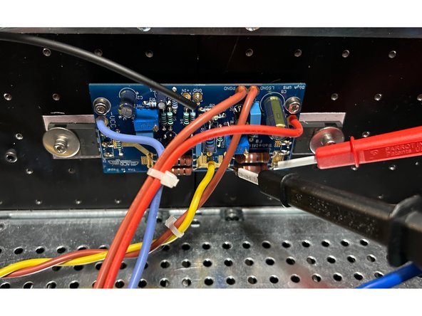

    • It is critical to check the resistance from the heatsink (chassis / mains earth) to each pin of the MOSFETs prior to soldering them into place. The metal back of the MOSFET is the drain, and it must be electrically isolated from the heatsink.
    • Check the resistance between the two bolts mounting the MOSFETs. It should be less than a few Ohms. If not, DO NOT proceed.
    • Photo 1 - Meter set to resistance. Probes placed between MOSFET mounting screws.
    • Note - You are measuring to ensure that the two heatsink sections are connected electrically to what will be established as "chassis ground" / mains earth. This is critical to safety.
    • Check the resistance from all 3 of the legs for both MOSFETs to the head of the screw mounting the MOSFET.
    • If the reading is not O.L (over limit) or in the MOhm range, check that your insulating pads are covering the entire base of the MOSFETs. DO NOT proceed if you do not measure in the MOhm range or your meter does not read O.L. (over limit).
    • Photo 2 - Meter set to resistance. Probes placed on mounting screw (mains earth / chassis GND) and pin 2 (drain). O.L (A very high resistance) is a proper result.

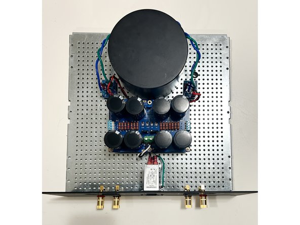

  24. The PSU used for this guide is the Simple Linear Bipolar Power Supply. For more information, check the diyAudiostore and review the build guide.
    • The PSU used for this guide is the Simple Linear Bipolar Power Supply. For more information, check the diyAudiostore and review the build guide.
    • PSU assembly and testing is not included in this guide. It is advisable to use at least 150VA of transformer power per channel, with 18+18Vac or 36Vct secondaries. This will result in +/-24Vdc rails nominally with no load and result ending somewhere at +/- 22V5dc. A little higher or lower is no issue.
    • Ensure that your power supply is fully tested and meets all requirements before proceeding.
    • Using any linear PSU of this type involves potential exposure to mains AC. Exposure to mains AC can be lethal. It is critical to follow proper safety procedures. If you are unsure how to proceed, seek qualified assistance.
    • Photo 1 - The Simple Linear Bipolar Power Supply mounted securely to the perforated base plate. The back panel is fully assembled minus the input RCA jacks.

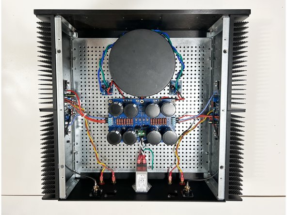

  25. Everyone develops their own build sequence and chooses whether they will use terminations or direct solder their wiring. For this guide, bootlace ferrules and Euroblocks were used for the PSU connections. Female blade connectors were used for the binding posts. The inputs were direct soldered. Collect the heatsink / amplifier board assemblies. Mount the heatsinks to the perforated baseplate using the hardware provided with the chassis.
    • Everyone develops their own build sequence and chooses whether they will use terminations or direct solder their wiring. For this guide, bootlace ferrules and Euroblocks were used for the PSU connections. Female blade connectors were used for the binding posts. The inputs were direct soldered.

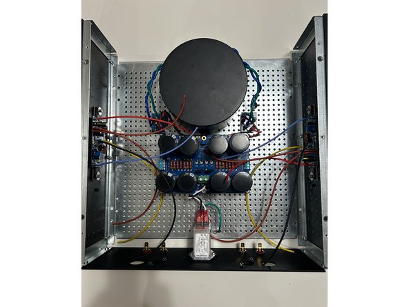

    • Collect the heatsink / amplifier board assemblies. Mount the heatsinks to the perforated baseplate using the hardware provided with the chassis.
    • Photo 1 - Initial wiring with longer-than-necessary wiring.
    • Estimate the wire lengths from the amp boards to the PSU and to the speaker binding posts. You can try to get it exact if you like, but it is safer to have a little excess wire. Trim and terminate (as appropriate) the +VCC, -VCC, LS+, and both GND wires.
    • Estimate the wire length from the amp boards to the RCA input jacks. Solder the input wiring to the RCA input jacks. Install the input jacks to the back panel. Install the back panel to the heatsinks using the hardware provided with the chassis.
    • Connect all wiring to the power supply and binding posts as appropriate. Those that choose to direct solder each wire on both ends will likely want to wait until each amplifier board is tested separately before soldering the wiring to the PSU. See step 39.
    • Be extremely mindful of the +VCC (V+) and -VCC (V-) connections to the PSU. Reversing them will result in "magic smoke".
    • Photo 2 - All wiring in place. Perforated base plate and back panel attached to heatsinks.

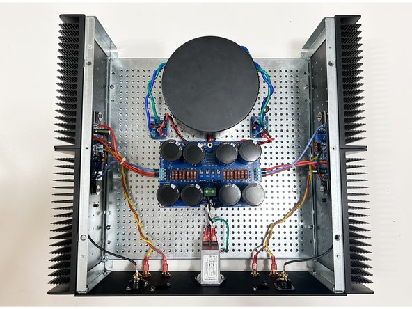

  26. If you have a brand new chassis, the feet should be installed prior to attaching the bottom panel to the heatsinks.
    • If you have a brand new chassis, the feet should be installed prior to attaching the bottom panel to the heatsinks.
    • If you're going to have LEDs on your front panel, now is a great time to check the wiring length and finalize any connections.
    • Attach the front panel and bottom panel to the heatsinks using the hardware provided with the chassis.
    • Note - In this guide 4 x M4 threaded rods (commonly available) were used along with Keps nuts to secure the front panel to the heatsinks. The standard M4 bolts provided with the chassis work wonderfully, but some may find alternate hardware easier to access and tighten securely depending on the build sequence and choices that may restrict space.
    • Photo 1 - The amplifier is essentially complete (minus the top panel).
    • Triple check all wiring / connections paying particular attention to the PSU wiring.

    • Adjust TP2 in both directions. The voltage across R18 should increase and decrease. Note which direction of rotation results in the absolute value of the voltage increasing and decreasing
    • Continue increasing the voltage from the variable transformer until you reach full mains voltage. If the voltage across R18 exceeds 500mV before full mains is reached, adjust TP2 until it is below 500mV.
    • Adjust TP1 in both directions. The voltage across the binding posts should change. Note which direction results in the voltage going more positive or more negative.

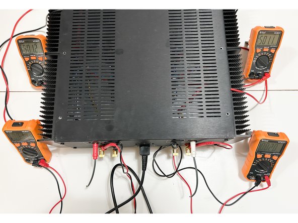

    • If 4 DMMs are available, connect additional DMMs across R18 and across the binding posts of the 2nd amplifier board.
    • Triple check that V+, V-, and GND are connected properly for both boards.
    • Remove the variable transformer or DBT (as applicable). Full voltage mains power should be connected directly to the PEM.
    • Place the top cover gently on top of the amplifier taking care to not pull on your DMM leads. Turn on the amplifier.

    • The goal of this step is to set the final bias and offset. It is wonderful if you have 4, DMMs. If not, it will just take you a little longer.
    • PLEASE DO NOT RUSH. IT IS NOT RECOMMENDED TO MOVE PROBES BETWEEN CHANNELS WITH THE AMPLIFIER UNDER POWER. IF YOU DON'T HAVE 4 DMMs, PLEASE DO ONE CHANNEL AT A TIME
    • As mentioned, the bias current is very stable. However, the offset will change as the output devices warm up. The amplifier must be at thermal equilibrium.
    • Turn on the amplifier.
    • Allow the amplifier to come to temperature for at least 30 minutes while monitoring the DMMs to ensure the voltage across R18 does not exceed 550mV. If the voltage begins to approach 550mV adjust TP2 to reduce the voltage.
    • Remove the lid. Carefully and quickly adjust TP2 until the voltage across R18 is as close to 500mV as you can achieve. Put the lid back on. Wait at least another 5 to 10 minutes. Remove the lid. Tweak. Replace the lid. Repeat until the voltage does not wander outside the set tolerances or until you're happy.
    • Remove the lid. Carefully and quickly adjust TP1 until the voltage across the binding posts is as close to 0V as you can achieve. Put the lid back on. Wait at least another 5 to 10 minutes. Remove the lid. Tweak. Repeat until the voltage does not wander outside the set tolerances or until you're happy.
    • Photo 1 - Close enough to 500mV on both channels and less than 10mV of offset. No changes in bias or offset for over 20 minutes. Success!
