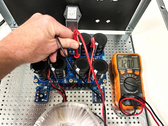

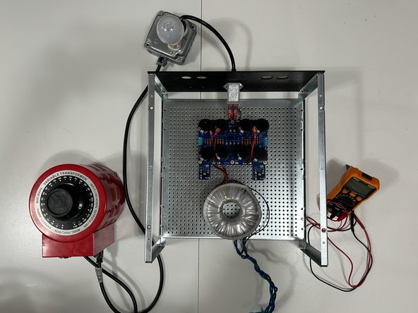

    • Before handling the PCB or any part of the PSU assembly, you MUST ensure that the circuit is de-energized, i.e. that the mains power is disconnected and that capacitors are discharged.
    • DO NOT use the PSU as an assembly in a project until it has passed all checks.
    • Use clip leads for your DMM as appropriate. Attach and remove the leads with the circuit de-energized when possible. Disconnect the mains power whenever it is not strictly required for testing.
    • Wear proper Personal Protective Equipment (PPE) including rubber-soled shoes and safety glasses. Work on a concrete or hardwood floor. DO NOT work around water or other liquids.
    • The thermistors used for inrush current limiting will get VERY hot in normal use. DO NOT TOUCH them until it is verified that they have cooled to ambient temperature!

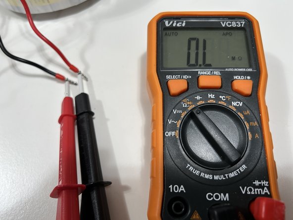

    • DMM issues can lead to frustration.
    • Check the batteries. When in doubt, replace the batteries.

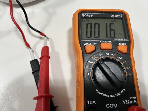

    • Make sure your probes are reading "0 Ohms" resistance probe to probe or are appropriately compensated.
    • Make sure your probes are connected properly. For this guide, the polarity of the voltage being read is critical; so always observe and report polarity.

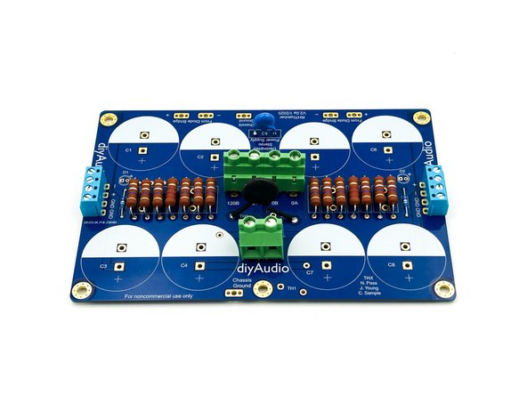

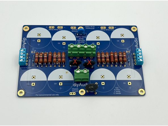

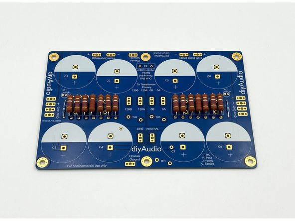

  4. Look over your boards and get familiar with the parts placement.  Compare a board to the parts placement document. Image 1 - Front view of the PCB.
    • Look over your boards and get familiar with the parts placement. Compare a board to the parts placement document.
    • Image 1 - Front view of the PCB.
    • You will not stuff every component. The PCBs include options for various power supply configurations.
    • Image 2 - Back view of the PCB, sometimes referred to as the solder side. There are options for installing some of the terminal blocks on the back of the PCB depending on your personal choice for layout.
    • Main PCB Dimensions - 170mm x 112mm +/- 0.02mm
    • Rectifier / Snubber PCB Dimensions - 30mm x 39mm +/- 0.02mm
    • There are a number of options for builders. This is a very versatile PCB.
    • If you already have a project for which the PSU will be used, it is strongly advised to determine your initial layout. This will allow you to choose mounting options and terminations.
    • Note your mains voltage. You should have either 115VAC mains or 230VAC mains. This is not a regulated power supply. So, fluctuations in mains voltage will affect the output voltage. It is critical to build the power supply in accordance with your mains voltage and your transformer configuration.
    • The kit from diyAudiostore.com comes with terminal blocks to connect mains wiring and the transformer primaries along with the amplifier boards. The board will also accept standard male spades, or you can solder the wiring directly.
    • Determine the orientation of the PSU in the chassis and where the transformer will sit relative to the PSU along with your expected wire routing. Choose whether you would like to mount any connections on the bottom of the board.
    • The author likes the mains connections and transformer primary connections on the bottom of the board in some situations. It makes for a clean look and tidy wire routing.
    • Open the bags of parts, verify them against your packing list and get to know what they look like.
    • Place all of your parts carefully in a bowl or somewhere they will not get lost, knocked onto the floor, accidentally spread around your workbench, or mixed in with other parts not associated with this project.
    • Many people like to separate their parts by type. For this project, it's not necessary, but choose whatever method works best for you. It's fairly simple to keep all the parts together and select only what is required for a particular step.
    • Tidy up your workspace. Keep in mind that you'll be working with a very hot soldering iron, and it can be easy to misplace parts.
    • Clean both sides of the boards with isopropyl alcohol or your favorite PCB cleaner. A dust and oil free board helps the solder to flow nicely. Plus, they're very pretty. Yes, that's real gold.

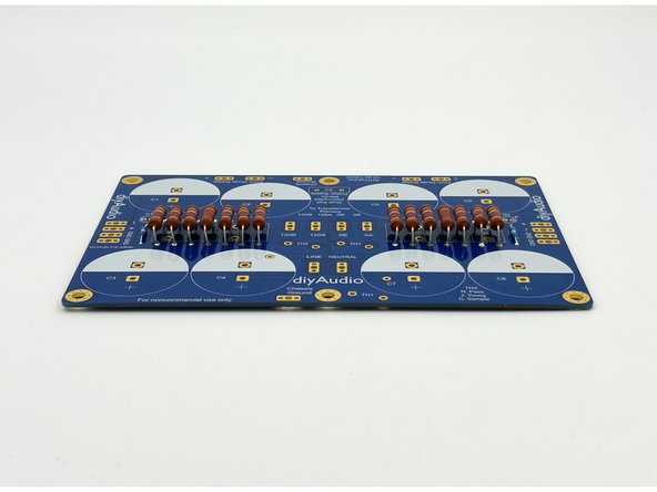

  5. There are only two types of resistors and 3 values.  If you are building a +- 24V PSU, appropriate LED current limiting resistors are included with the kit.  If you are using different voltages and/or like your LEDs at a specific brightness, feel free to use your own, or none at all. (Optional) Install R15 and R16, the LED current limiting resistors.
    • There are only two types of resistors and 3 values. If you are building a +- 24V PSU, appropriate LED current limiting resistors are included with the kit. If you are using different voltages and/or like your LEDs at a specific brightness, feel free to use your own, or none at all.
    • (Optional) Install R15 and R16, the LED current limiting resistors.
    • The 3W filter resistors will get quite warm. Mounting them a few mm above the board allows better air flow. The bleeder resistor should not get hot, but it looks nice when they are mounted at the same height.
    • Install R7 and R14, the 2k2 bleeder resistors.
    • Install R1-R6 and R8-R13, the 0R47 filter resistors.
    • Photo 1 - Resistors installed.
    • Photo 2 - Elevated 3W resistors.
    • Based on your desires, LEDs can be installed on the main PCB and/or you can attach wires to use them as front panel power indicators. They're completely optional.
    • The "flat" side of the LED is indicated on the silkscreen noting the negative side of the LED, the cathode. There is also a (+) on the PCB noting the positive side of the LED, the anode. Do not use the pad shape as a polarity designator.
    • The LEDs included in the kit do not have a flat edge. The longer of the two leads is the positive lead, the anode.

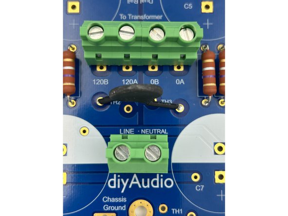

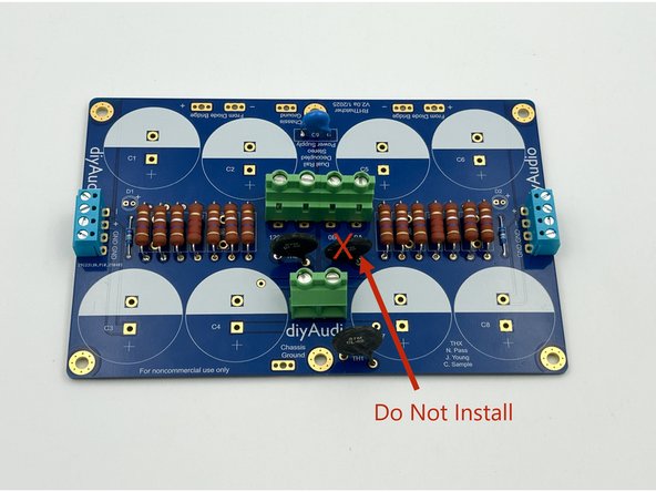

  6. Install C9 - This is a safety-rated cap for spark suppression at turn-on. Do Not Install TH2 or TH3 at this time!
    • Install C9 - This is a safety-rated cap for spark suppression at turn-on.
    • Do Not Install TH2 or TH3 at this time!
    • (Optional) Install TH1 (ground lift). TH1 is marked CL-60. For all First Watt amplifier projects sold through diyAudiostore.com, the ground lift is recommended. If you unsure, seek the advice of the circuit designer for your amplifier.
    • (Optional) Install the blue terminal blocks. They can be installed on the top or bottom of the board based on the build plan. They come attached in pairs in the kit. If they happen to slide, simply press them until they are level. You may also choose to direct solder wiring or use typical male spades.
    • (Optional) Install the green terminal blocks. Simply slide the pair together for the transformer primary connections. These can be installed on the top or the bottom of the PCB based on build plans. You may also choose to direct solder wiring or use typical male spades.
    • Photo 1 - DC Terminal Blocks (Blue), Mains and Transformer Primary Terminal Blocks (Green) installed on the top of the board. Builders with limited chassis height may choose this configuration.
    • Photo 2 - Mains and transformer primary terminal blocks installed on the bottom of the board. This allows easier access (particularly to the transformer primary wiring). It also allows slightly better wire routing in a lot of circumstances.

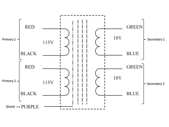

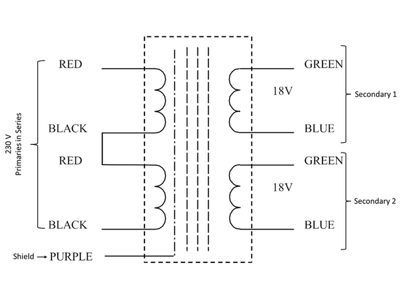

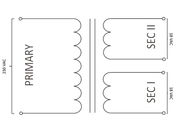

    • If you unfamiliar with your transformer, please skip ahead to step 29 before installing TH2 / TH3
    • You should clearly know:
    • Mains Voltage at the location where the PSU will be used: 115V or 230V
    • If the transformer has a single primary or dual primary windings
    • If the transformer secondary output voltage is determined by 115V or 230V mains connected to the primary winding(s).
    • If you are not 100% certain about any of those parameters. STOP! Seek assistance. DO NOT GUESS!
    • For 115V Mains and a transformer with a single 115V primary; proceed to step 21
    • For 115V Mains and a transformer with dual 115V primaries; proceed to step 22

    • Install TH2 - Double check the part marking. It should read "MS22"
    • Reminder - The thermistors used for inrush current limiting will get VERY hot in normal use. DO NOT TOUCH them until it is verified that they have cooled to ambient temperature!
    • Do not install TH3
    • Photo 1 - Install TH2. Do not install TH3
    • Skip to Step 25

  10. This step applies to 230V mains using a transformer with a dual 115V primaries Install a single thermistor across the outer pads for TH2 and TH3. Use a small piece of high-temperature rated heatshrink tubing or a piece of wire insulation on the bare portion of each leg to ensure the legs cannot short against adjacent pads. Double check the part marking.  It should read "MS22".
    • This step applies to 230V mains using a transformer with a dual 115V primaries
    • Install a single thermistor across the outer pads for TH2 and TH3. Use a small piece of high-temperature rated heatshrink tubing or a piece of wire insulation on the bare portion of each leg to ensure the legs cannot short against adjacent pads. Double check the part marking. It should read "MS22".
    • Photo 1 and 2 - Thermistor installed across the outer pads for TH2 and TH3
  11. Verify the orientation of the electrolytic capacitors!  The negative side is indicated with a band.  The band aligns with the filled, white side of the silkscreen. The capacitors provided in the kits snap in. Simply align the tips of the leads with the holes, give them a gentle press, and give them a slight twist to lock them into place. They also need to be soldered to the pads. The leads do not need to be clipped.
    • Verify the orientation of the electrolytic capacitors! The negative side is indicated with a band. The band aligns with the filled, white side of the silkscreen.
    • The capacitors provided in the kits snap in. Simply align the tips of the leads with the holes, give them a gentle press, and give them a slight twist to lock them into place. They also need to be soldered to the pads. The leads do not need to be clipped.
    • Install C1-C8.
    • Photo 1 - Capacitor orientation
    • Photo 2 - Main PCB Complete.

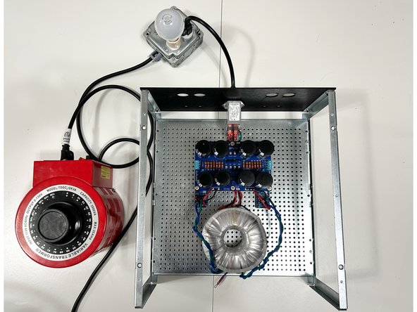

    • It is highly advised to use a variable transformer and/or a dim bulb tester (DBT) for the initial testing of your power supply. This guide will demonstrate the use of both.
    • For testing an unloaded power supply, a simple dim bulb tester may prevent catastrophic failure and is strongly recommended. If you are unfamiliar with DBTs, seek assistance. It is out of scope for this guide.
    • A variable transformer is also nice to have to slowly ramp up the voltage and observe the behavior of the circuit.

  13. The Antek AS-4218 is a dual primary transformer. It can be used for both 115VAC input and 230VAC input when wired appropriately. Antek's codes are fairly simple.  S is for Shielded. 4 is 400VA. 2 is dual secondary. 18 is the secondary voltage. Image 1 - Primary windings in parallel when used for 115 VAC mains voltage.
    • The Antek AS-4218 is a dual primary transformer. It can be used for both 115VAC input and 230VAC input when wired appropriately. Antek's codes are fairly simple. S is for Shielded. 4 is 400VA. 2 is dual secondary. 18 is the secondary voltage.
    • Image 1 - Primary windings in parallel when used for 115 VAC mains voltage.
    • Image 2 - Primary windings in series when used for 230VAC mains. Connecting the primaries in series effectively creates a single primary. This works because the input voltage is doubled from 115V, and therefore the resulting winding ratio results in the same 18VAC output.

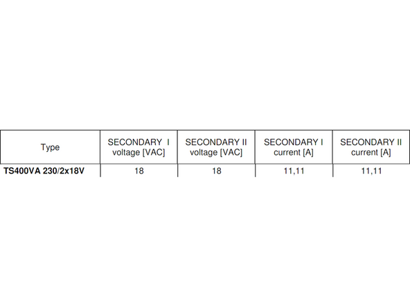

  14. Toroidy transformers are popular in countries with 230VAC mains. The Toroidy TS-400 series transformers are a single primary. They are only suitable (unless custom ordered) for 230VAC mains. Image 1 - Basic Schematic of the single primary / dual secondary transformer with 230VAC input and 18VAC output on each secondary
    • Toroidy transformers are popular in countries with 230VAC mains. The Toroidy TS-400 series transformers are a single primary. They are only suitable (unless custom ordered) for 230VAC mains.
    • Image 1 - Basic Schematic of the single primary / dual secondary transformer with 230VAC input and 18VAC output on each secondary
    • Image 2 - Toroidy's identification system is fairly straight forward. 400VA - 230V primary and 2 x 18 V secondaries.
  15. It is fairly simple to identify transformer primaries and secondaries. All that is needed is the datasheet and a DMM. The datasheet for the Antek AS-4218 shows that each primary is a red/black pair; each secondary is a green/blue pair, and the shield is purple. There is rarely consistency among manufacturers for color coding. Manufacturers may use different color coding across models and/or may change their coding over time. Ensure you check the specifications and/or the markings on the transformer itself. With a DMM set to continuity or resistance, identify which pairs are two ends of the same wire. Separate them, and label them. The primaries will have a resistance typically of a few Ohms. The secondaries will have a resistance typically below 1 Ohm.
    • It is fairly simple to identify transformer primaries and secondaries. All that is needed is the datasheet and a DMM. The datasheet for the Antek AS-4218 shows that each primary is a red/black pair; each secondary is a green/blue pair, and the shield is purple.
    • There is rarely consistency among manufacturers for color coding. Manufacturers may use different color coding across models and/or may change their coding over time. Ensure you check the specifications and/or the markings on the transformer itself.
    • With a DMM set to continuity or resistance, identify which pairs are two ends of the same wire. Separate them, and label them. The primaries will have a resistance typically of a few Ohms. The secondaries will have a resistance typically below 1 Ohm.
    • Photo 1 - Two ends of the same primary winding. Low resistance. They should be paired and labeled.
    • Photo 2 - Two ends of the same secondary winding. Low resistance. They should be paired and labeled.
    • Photo 3 - These are not two ends of the same primary winding. Note that the resistance is over limit. They should not be paired.

    • Photo 1 - Ready for initial checks
    • The first checks are to determine that there are no unintentional shorts, validate the mains voltage at the main board, and validate the transformer secondary voltages.
    • If at any point you smell smoke, see sparks or have any concerns whatsoever, immediately switch off the power to the unit. Exercise proper precautions when inserting and removing probes including but not limited to ensuring that you do not short your probes to each other.
    • If you are using a DBT, and you see the bulb glow at all, shut off the power. There is no significant current draw at this stage.

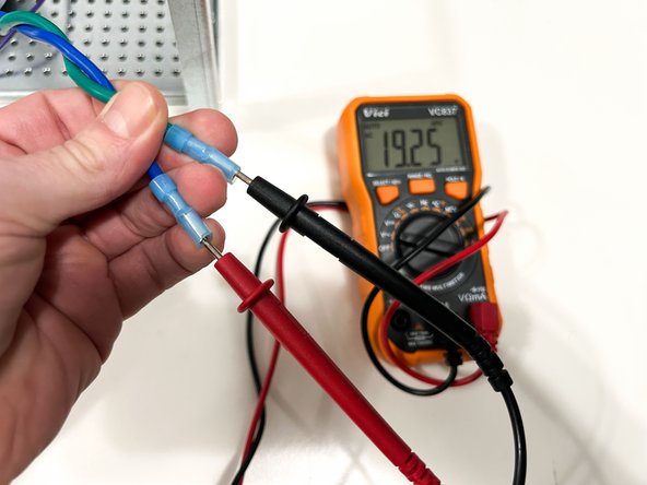

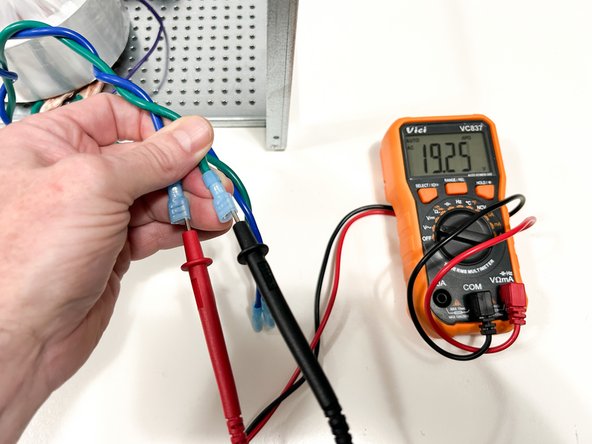

  23. Set a DMM to measure AC voltage at an appropriate range (in this demonstration approximately 10VAC to 130VAC) Turn on the mains voltage (or slowly increase it using the variable transformer). Once full mains voltage is reached, check it at the main board where the transformer primaries are connected. If it does not match your expected mains voltage, stop immediately and turn off the mains power.
    • Set a DMM to measure AC voltage at an appropriate range (in this demonstration approximately 10VAC to 130VAC)
    • Turn on the mains voltage (or slowly increase it using the variable transformer).
    • Once full mains voltage is reached, check it at the main board where the transformer primaries are connected. If it does not match your expected mains voltage, stop immediately and turn off the mains power.
    • Check the AC voltage across each of the transformer secondaries. It will likely be slightly higher than the voltage noted. As an example for a typical 18VAC transformer, it will measure between 19 and 20VAC unloaded at standard rated mains.
    • Turn off the mains power.
    • Photo 1 - Approximately 120VAC at the transformer primaries. DO NOT hold both probes with one hand. This photo was taken to better demonstrate the location of the probes.
    • Photo 2 - Approximately 19-20VAC at transformer secondary 1
    • Photo 3 - Identical voltage at transformer secondary 2. Don't worry if they differ by a even a few tenths of a volt. If the voltages differ by 0.5V or more, troubleshooting is necessary.

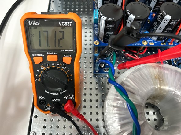

  25. Many builders are unsure of results when they measure the voltage at the rectifiers using a basic hand-held DMM. Because the voltage at the rectifiers has not been 'smoothed' or 'filtered', it is not 'Perfect DC'. There is a significant amount of AC ripple. Turn on the mains power.
    • Many builders are unsure of results when they measure the voltage at the rectifiers using a basic hand-held DMM. Because the voltage at the rectifiers has not been 'smoothed' or 'filtered', it is not 'Perfect DC'. There is a significant amount of AC ripple.
    • Turn on the mains power.
    • With the DMM set to measure DCV, measure the voltage across the (+) and (-) tabs of both rectifiers. The results will vary widely by the DMM used, but anything above 10VDC would be acceptable at this point. It does not matter if the voltages at both rectifiers are even close.
    • (optional) - With the DMM set to measure ACV, measure the voltage across the (+) and (-) tabs of both rectifiers. Notice how there may still be a fairly high AC component displayed. This measurement is only for amusement / learning. The AC and DC voltages will not sum to the final DC output voltage of the PSU.
    • Photo 1 - DC Voltage at one rectifier.
    • Photo 2 - AC Voltage at the same rectifier.

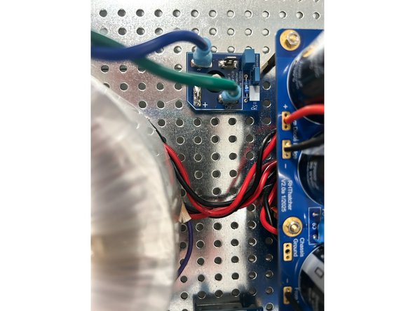

  26. The rectifier PCBs are clearly marked with a (+) and a (-). In addition, for every rectifier of this style, the (+) terminal will be the terminal oriented 90 degrees off of the other three. Connect the main PCB to the rectifiers.
    • The rectifier PCBs are clearly marked with a (+) and a (-). In addition, for every rectifier of this style, the (+) terminal will be the terminal oriented 90 degrees off of the other three.
    • Connect the main PCB to the rectifiers.
    • It is critical to ensure the proper connections to the rectifiers. Triple check your work to ensure the (+) and (-) pads from the main PCB attach to the corresponding (+) and (-) terminals on the rectifiers.
    • Photo 1 - Rectifier connected properly to the main PCB.
    • Photo 2 - The fully-assembled unit may look something like this.
