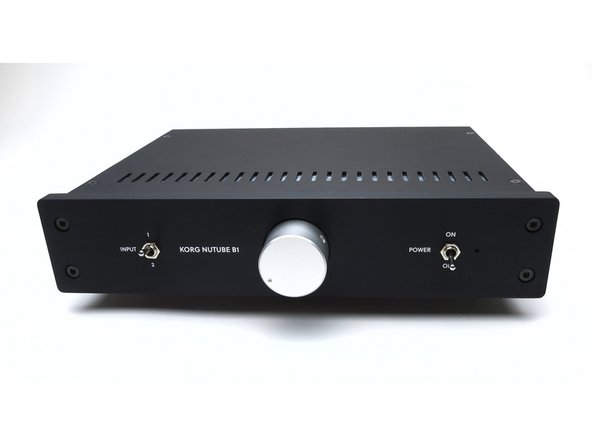

This is the build guide for the Korg Nutube B1
Please note:
The photos in this guide were made using the pioneer batch chassis which had vents in the covers. The production run of B1K chassis has upgraded covers without vents. This is an intended improvement to the original design that helps control microphonics, based on testing and research from our pioneer batch beta testers.
The photos shown are of the components used in the pioneer batch. The components chosen for the production batch may vary from the photos. We sometimes buy Digikey/Mouser completely out of all their stock of a certain part and "same-or-better" alternates are chosen. Component appearance may vary even between batches from the same manufacturer. Always measure your components before installing them, confirming they match the value printed on the part, and trusting the schematic which is the ultimate source of truth.
If you have any comments or tips on any step please leave a comment. Please note you must first be logged in to diyAudio before you post your comment here. Your comment may be invaluable to other builders!

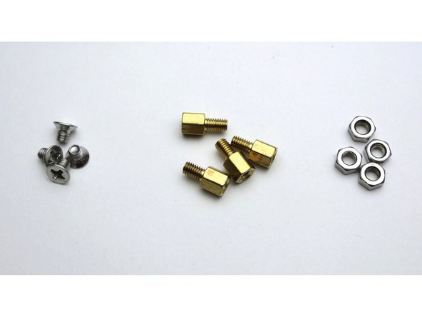

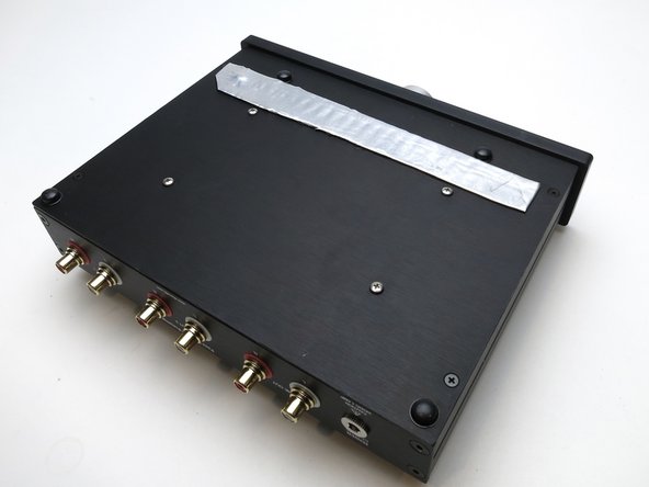

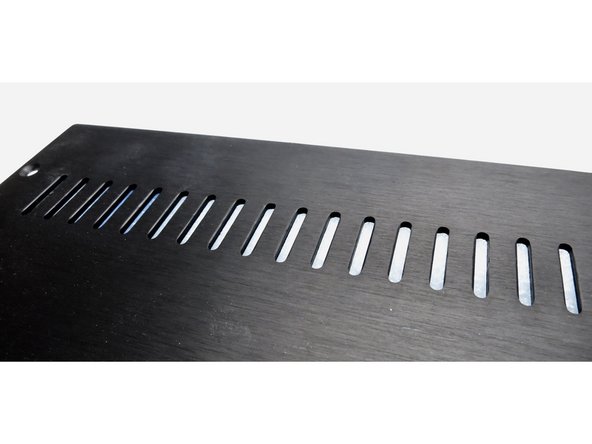

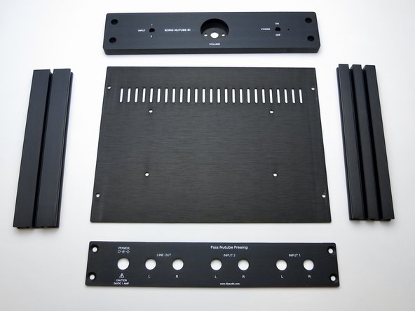

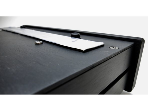

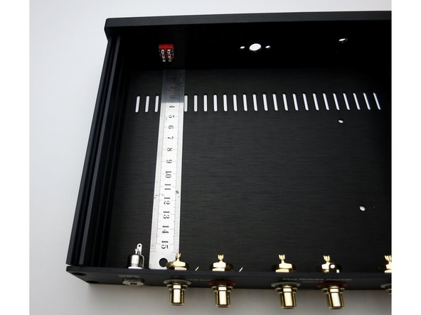

  3. Photo 3 - The bottom panel has the 4 holes drilled for the PCB standoffs The photos in this guide were made using the pioneer batch chassis which had vents in the covers. The production run of B1K chassis has upgraded covers without vents. This is an intended improvement to the original design that helps control microphonics, based on testing and research from our pioneer batch beta testers. The photos in this guide were made using the pioneer batch chassis which had vents in the covers. The production run of B1K chassis has upgraded covers without vents. This is an intended improvement to the original design that helps control microphonics, based on testing and research from our pioneer batch beta testers.
    • Photo 3 - The bottom panel has the 4 holes drilled for the PCB standoffs
    • The photos in this guide were made using the pioneer batch chassis which had vents in the covers. The production run of B1K chassis has upgraded covers without vents. This is an intended improvement to the original design that helps control microphonics, based on testing and research from our pioneer batch beta testers.

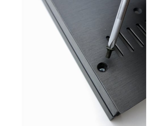

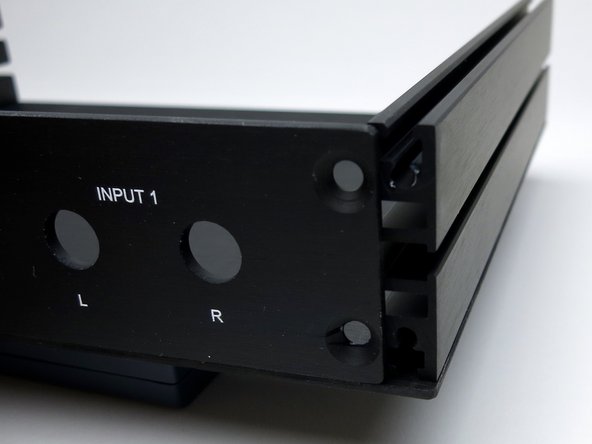

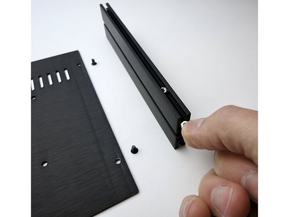

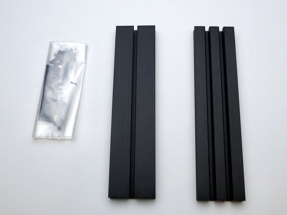

  4. Insert the nuts into the channel
    • Insert the nuts into the channel

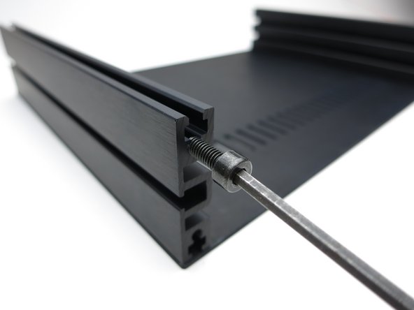

  5. Slide the nuts under the holes then attach the screws
    • Slide the nuts under the holes then attach the screws
  6. Make sure the holes are aligned with the threaded part of the aluminum extrusion, not the square channel where the nuts go.
    • Make sure the holes are aligned with the threaded part of the aluminum extrusion, not the square channel where the nuts go.

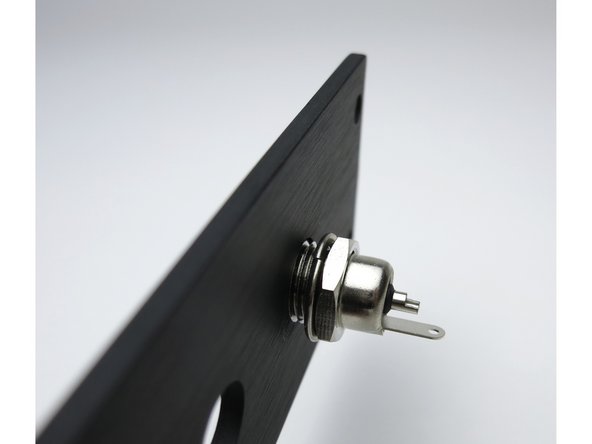

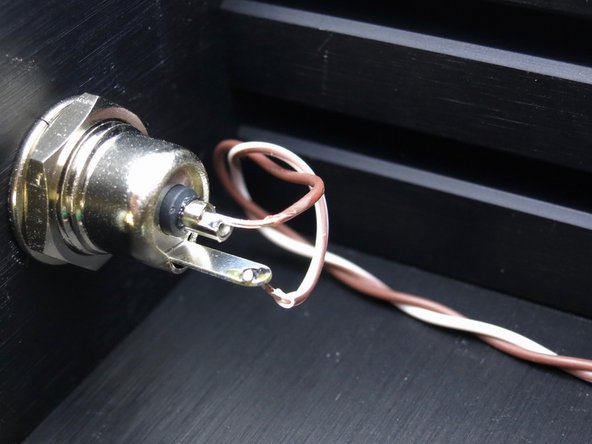

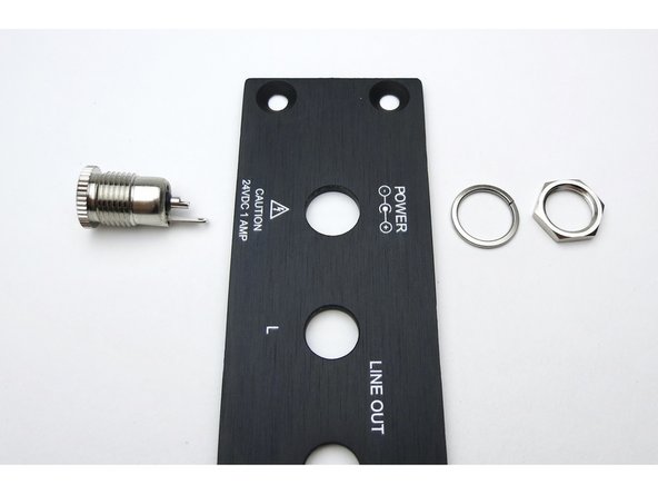

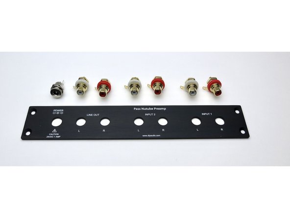

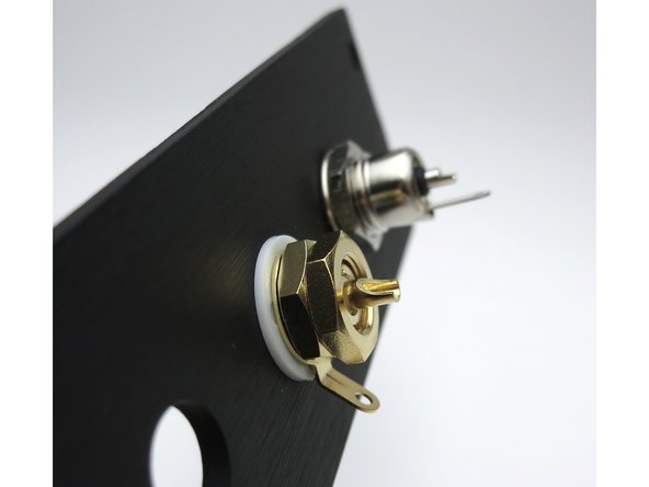

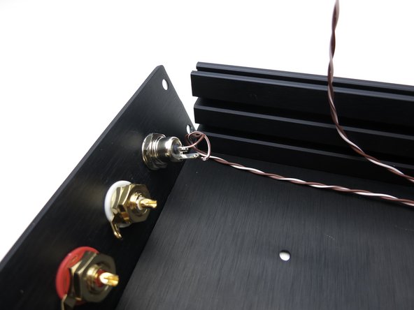

  7. Barrel jack assembly
    • Barrel jack assembly

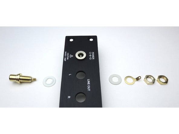

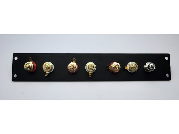

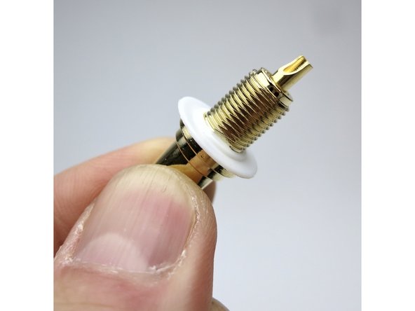

  8. RCA assembly Photo 2 - RCA  jack positioning
    • RCA assembly
    • Photo 2 - RCA jack positioning

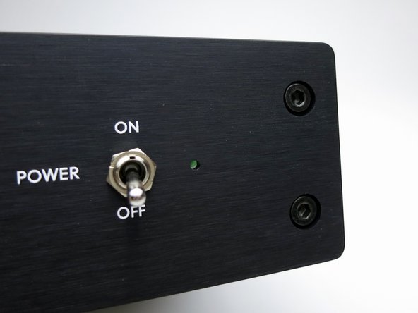

  9. Place the shoulder washer here as shown
    • Place the shoulder washer here as shown
  10. Make the leads long now and trim them to size later.
    • Make the leads long now and trim them to size later.

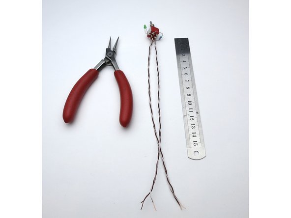

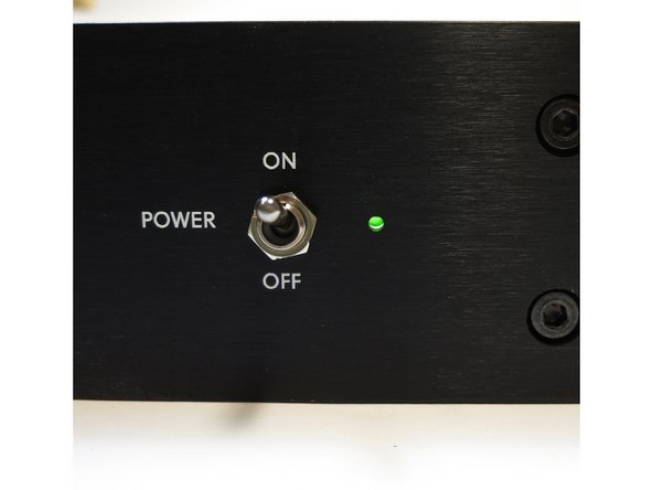

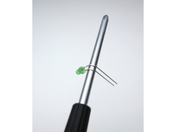

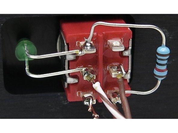

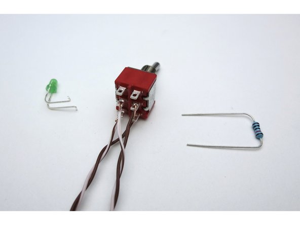

  11. Begin with the LED
    • Begin with the LED
  12. Bend the LED 90deg around the curve of a screwdriver. Long leg on top.
    • Bend the LED 90deg around the curve of a screwdriver. Long leg on top.

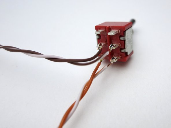

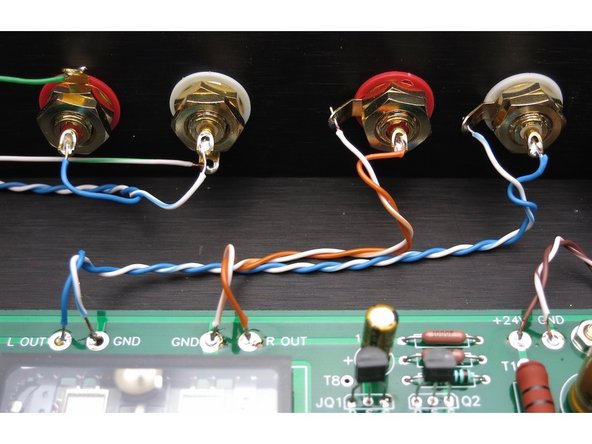

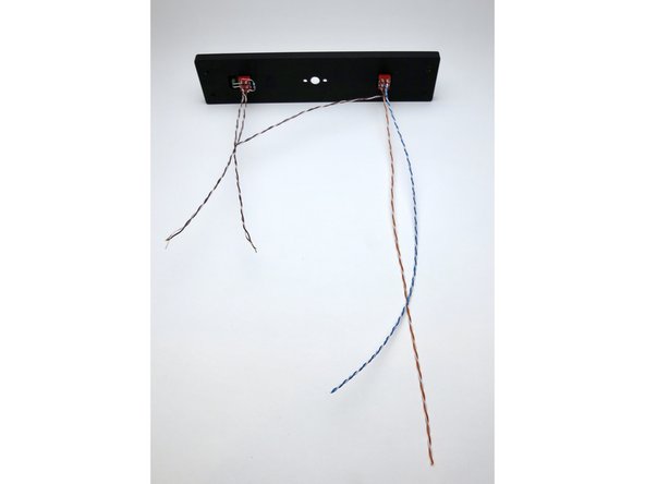

  13. Wires attached as shown
    • Wires attached as shown

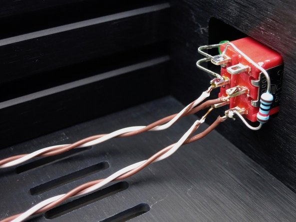

  14. LED and resistor as shown. Making a couple of bends where the LED attaches to the switch will greatly aid assembly.
    • LED and resistor as shown. Making a couple of bends where the LED attaches to the switch will greatly aid assembly.

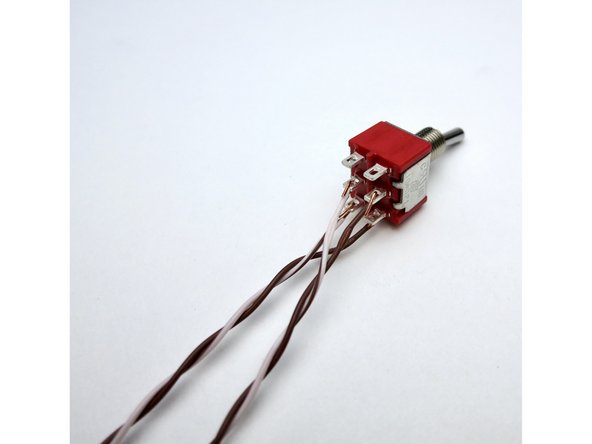

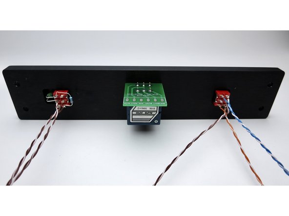

  15. Photo 1 - Assembled switch Photo 2 - LED/Resistor wiring Photo 3 - Wiring diagram
    • Photo 1 - Assembled switch
    • Photo 2 - LED/Resistor wiring
    • Photo 3 - Wiring diagram

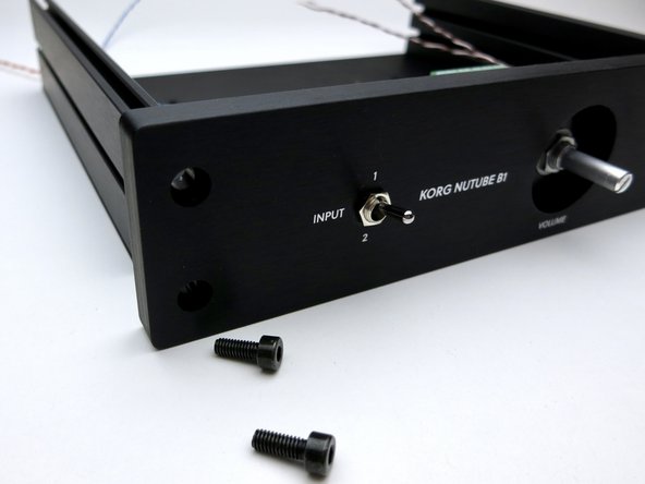

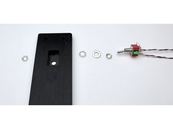

  16. Assemble switch to front panel - nut/front panel/star washer/flat washer/nut.
    • Assemble switch to front panel - nut/front panel/star washer/flat washer/nut.

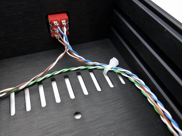

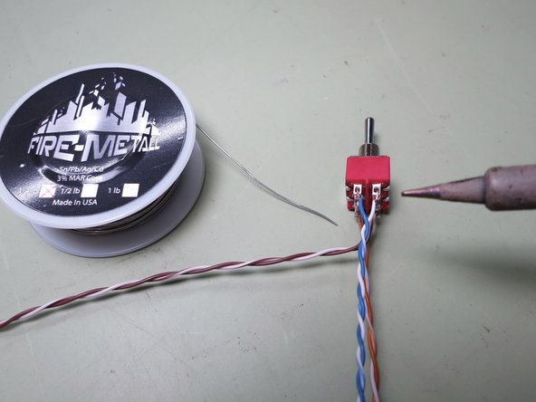

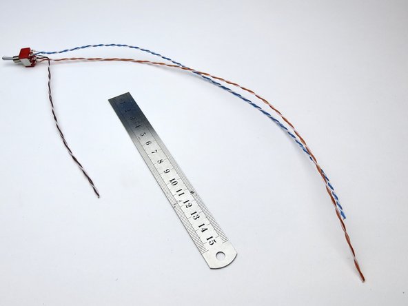

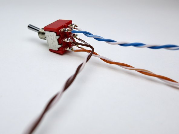

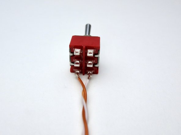

  17. It's easier to make the wires long now and trim to size when soldering. Please note that you don't have to follow my color scheme, but if you do checking things will be much easier... For that matter you can substitute other wire if you like. It's DIY, after all.
    • It's easier to make the wires long now and trim to size when soldering. Please note that you don't have to follow my color scheme, but if you do checking things will be much easier... For that matter you can substitute other wire if you like. It's DIY, after all.

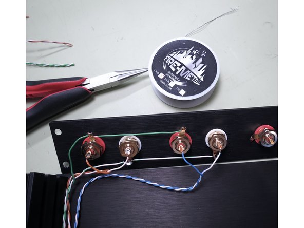

  18. Photo 1 - Solid colors on the left, white traces on the right. Begin with orange on the bottom. Note that there is no "top" or "bottom" to the switch until you attach things to it. Photo 2 - Brown in the middle, this will go to the potentiometer. Photo  3 - Blue on top. (Shameless plug: the Fire-Metall solder is absolutely the nicest I have ever used. )
    • Photo 1 - Solid colors on the left, white traces on the right. Begin with orange on the bottom. Note that there is no "top" or "bottom" to the switch until you attach things to it.
    • Photo 2 - Brown in the middle, this will go to the potentiometer.
    • Photo 3 - Blue on top. (Shameless plug: the Fire-Metall solder is absolutely the nicest I have ever used. )
    • Later, in step 52, the orange and blue pairs will be connected to inputs 1 and 2 on the rear panel
  19. Complete. Mount the selector switch into the  front panel using the same technique you used for the power switch.
    • Complete. Mount the selector switch into the front panel using the same technique you used for the power switch.

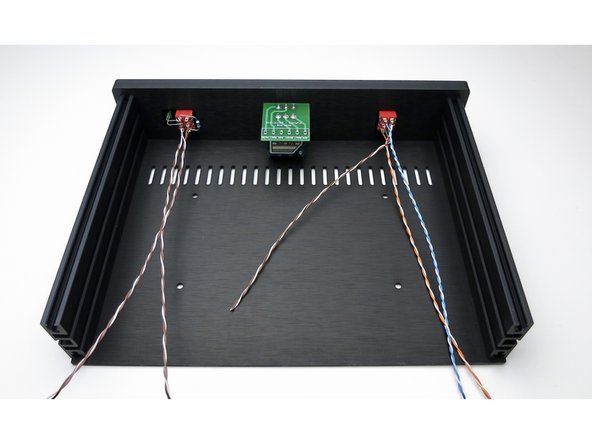

  20. Photo 3 - A little tape helps keep everything in place when soldering the PCB. Photo 3 - A little tape helps keep everything in place when soldering the PCB. Photo 3 - A little tape helps keep everything in place when soldering the PCB.
    • Photo 3 - A little tape helps keep everything in place when soldering the PCB.

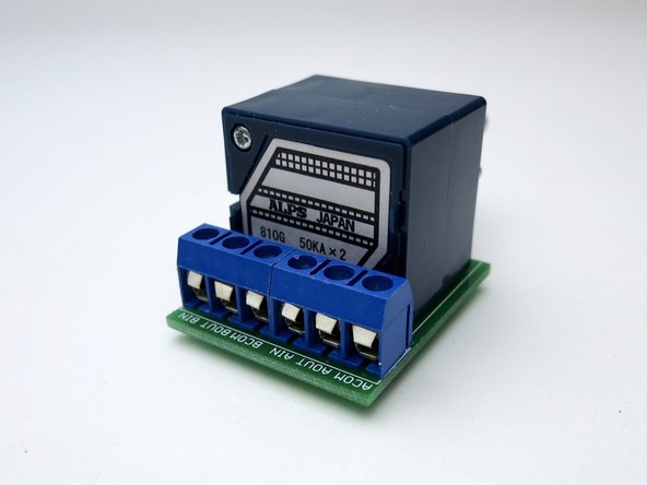

  21. Photo 2 - The screw terminals mount as shown if you want to use them. Photo 2 - The screw terminals mount as shown if you want to use them.
    • Photo 2 - The screw terminals mount as shown if you want to use them.

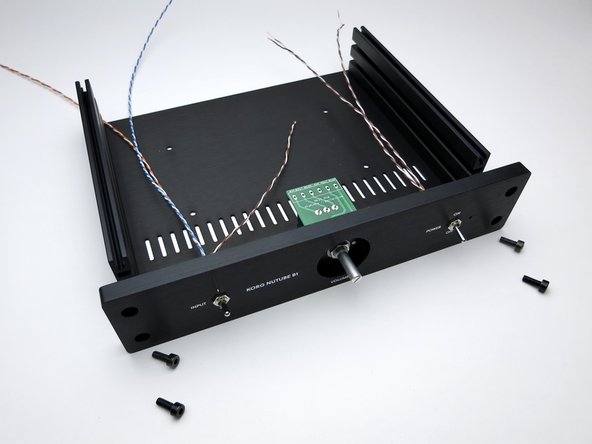

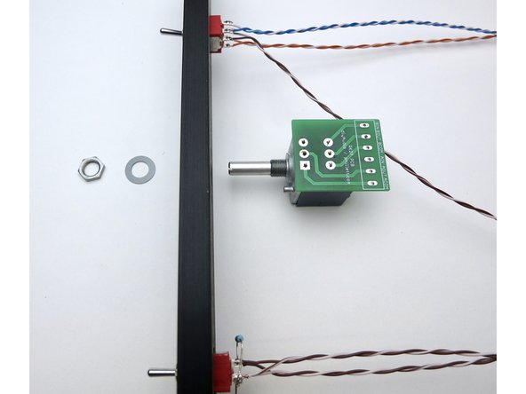

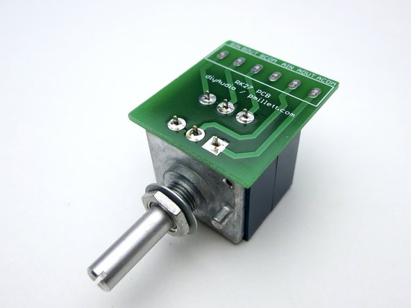

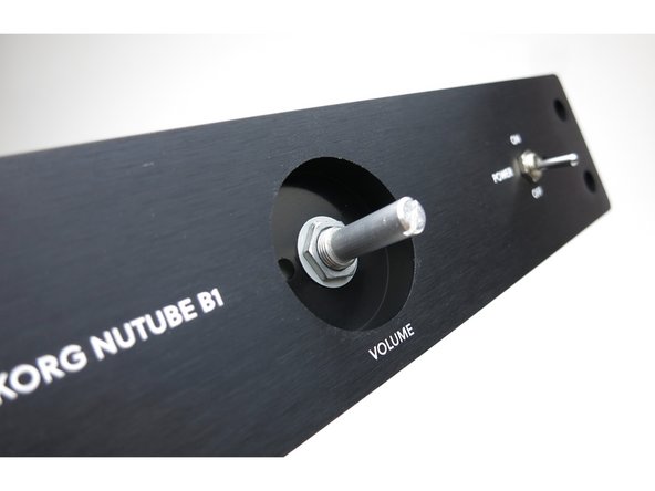

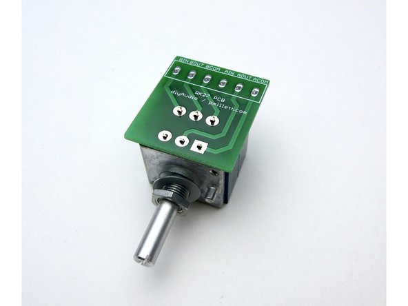

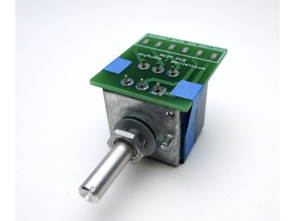

  22. Photo 1 - Install potentiometer to the front panel Photo 1 - Install potentiometer to the front panel Photo 1 - Install potentiometer to the front panel
    • Photo 1 - Install potentiometer to the front panel
  23. Photo 3 - The screws go the threaded section, not the channel where the nuts are. Photo 3 - The screws go the threaded section, not the channel where the nuts are. Photo 3 - The screws go the threaded section, not the channel where the nuts are.
    • Photo 3 - The screws go the threaded section, not the channel where the nuts are.

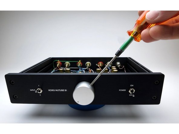

  24. Photo 1 - Front panel should look like this now. Photo 2 - Hopefully you can get your chrome nut on the switches better aligned than this.
    • Photo 1 - Front panel should look like this now.
    • Photo 2 - Hopefully you can get your chrome nut on the switches better aligned than this.

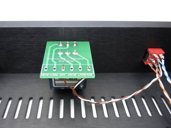

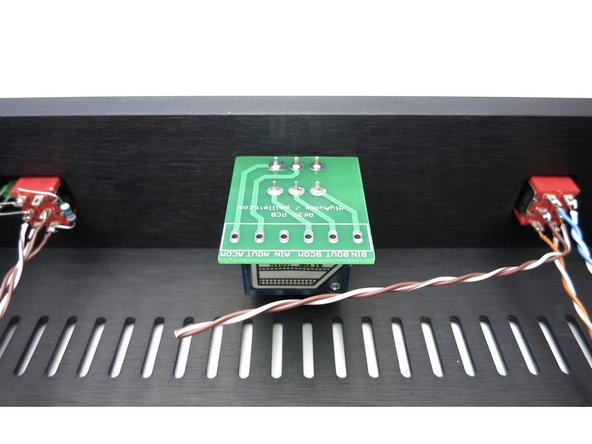

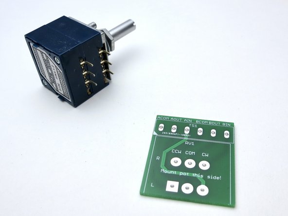

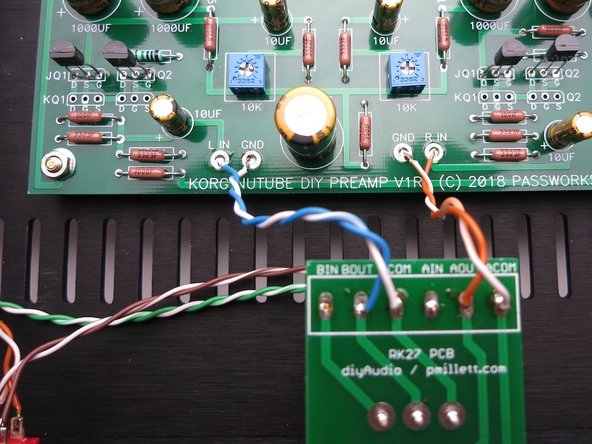

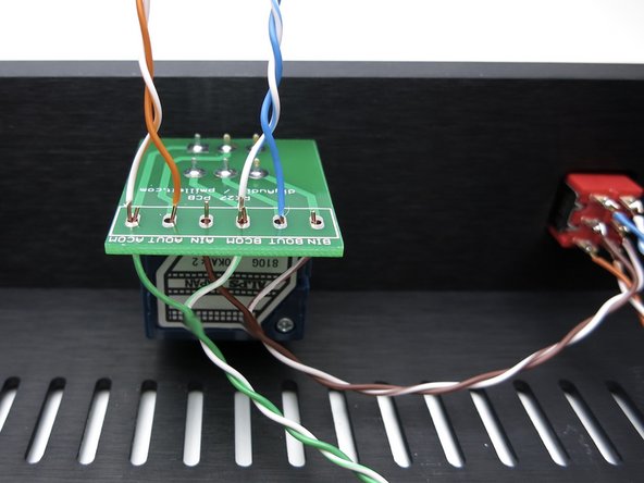

  25. Photo 2 - The middle of the switch needs to be connected to the IN pads of the pot board. In our wiring scheme so far, solid colors are right and white/trace color are left Photo 3 - Grounds are connected to the COM pads and go directly to the input RCAs, not connecting to the switch. Solid green is right, white/green left. Do not solder yet!
    • Photo 2 - The middle of the switch needs to be connected to the IN pads of the pot board. In our wiring scheme so far, solid colors are right and white/trace color are left

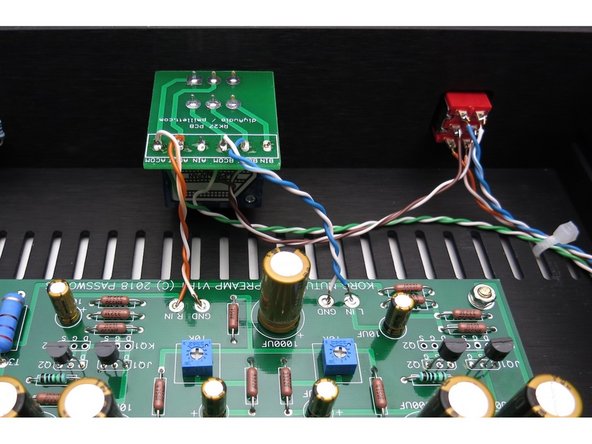

    • Photo 3 - Grounds are connected to the COM pads and go directly to the input RCAs, not connecting to the switch. Solid green is right, white/green left.
    • Do not solder yet!

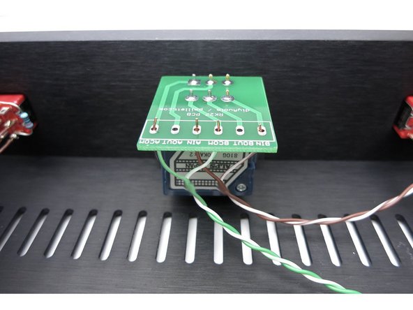

  26. Top connections, left to right in the photo:
    • Top connections, left to right in the photo:
    • ACOM: Orange/White, AOUT: Orange
    • BCOM: Blue/White, BOUT: Blue
    • Bottom connections, left to right in the photo:
    • ACOM: Green, AIN: Brown
    • BCOM: Green/White, BIN: Brown/White
    • Later, in step 52, the the pairs of orange and blue wires coming out of the top of the RK27 board will be connected to the left and right inputs on the main circuit board

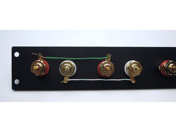

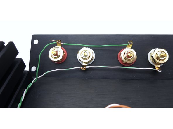

  27. Remember green is input grounds, and go directly to the potentiometer.
    • Remember green is input grounds, and go directly to the potentiometer.
  28. Photo 1 - Ground tabs tied together as shown. Solid green to right ground tabs, white/grn to left tabs. Photo 3 - Orange is input one. Solid orange to right, white/orange to left. Blue is input 2. Solid blue to right, white/blue to left. Photo 3 - Orange is input one. Solid orange to right, white/orange to left. Blue is input 2. Solid blue to right, white/blue to left.
    • Photo 1 - Ground tabs tied together as shown. Solid green to right ground tabs, white/grn to left tabs.
    • Photo 3 - Orange is input one. Solid orange to right, white/orange to left. Blue is input 2. Solid blue to right, white/blue to left.

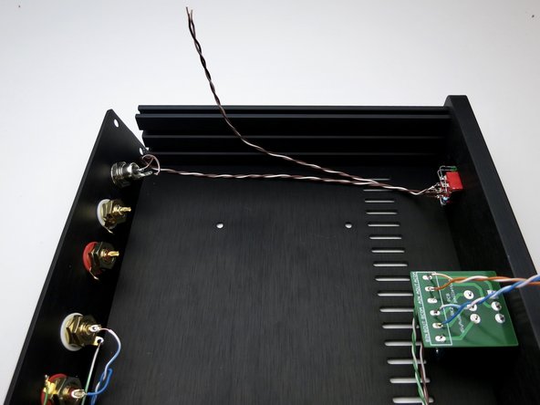

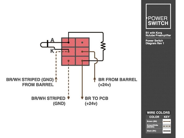

  29. Photo 1 - Wires to middle of front panel power switch. Brown is barrel center, white/brn is tab (photo 3). Photo 1 - Wires to middle of front panel power switch. Brown is barrel center, white/brn is tab (photo 3). Photo 1 - Wires to middle of front panel power switch. Brown is barrel center, white/brn is tab (photo 3).
    • Photo 1 - Wires to middle of front panel power switch. Brown is barrel center, white/brn is tab (photo 3).
  30. Wires from the bottom of this switch (photo 1) connect to the PCB (photo 2). Brown is +24V, brown/wht is GND Wires from the bottom of this switch (photo 1) connect to the PCB (photo 2). Brown is +24V, brown/wht is GND
    • Wires from the bottom of this switch (photo 1) connect to the PCB (photo 2). Brown is +24V, brown/wht is GND

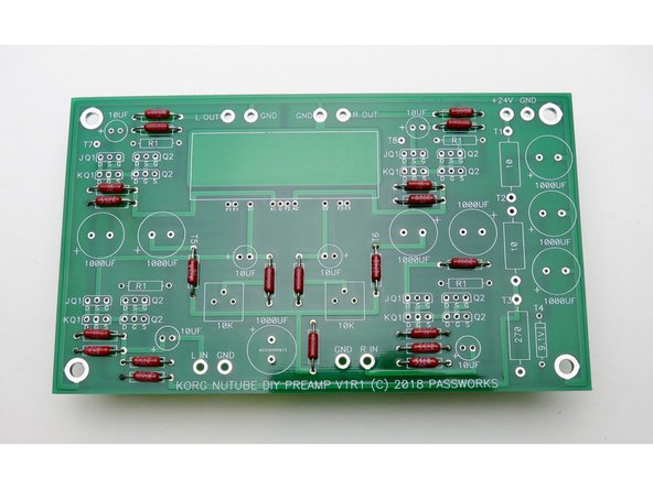

  31. The photos of the Barrel-Power Switch-PCB wiring are for clarification. PCB Stuffing, starting with the PSU is next.
    • The photos of the Barrel-Power Switch-PCB wiring are for clarification. PCB Stuffing, starting with the PSU is next.

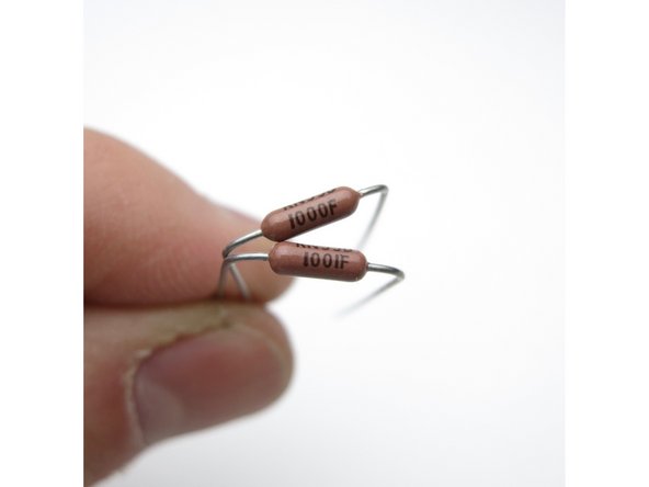

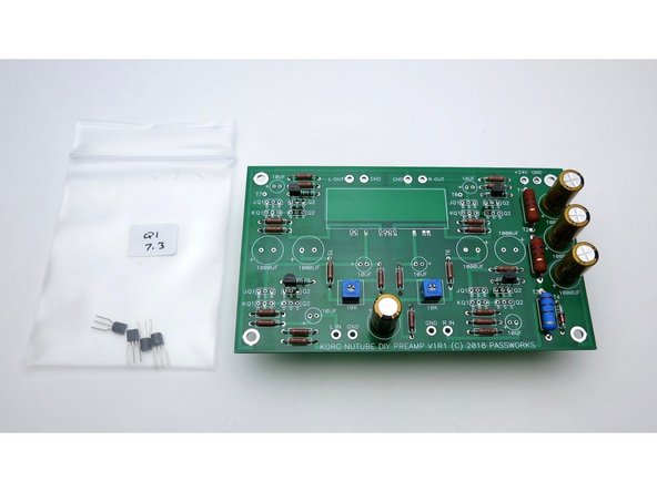

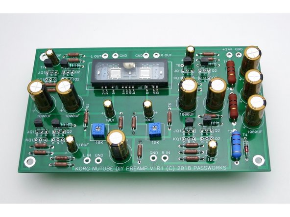

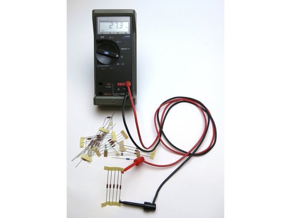

  32. Measure all resistors before inserting into the board. Measure all resistors before inserting into the board.
    • Measure all resistors before inserting into the board.

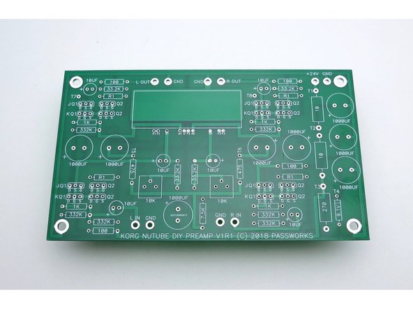

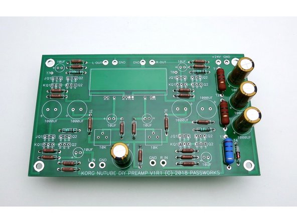

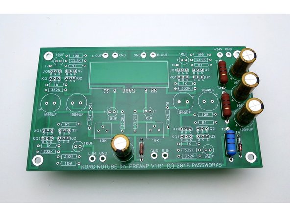

  33. PSU section is stuffed and tested first. Please do not stuff entire PCB at once.
    • PSU section is stuffed and tested first. Please do not stuff entire PCB at once.
    • Bare PCB V1R1 is the most current as of this writing (Spring 2020)

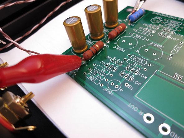

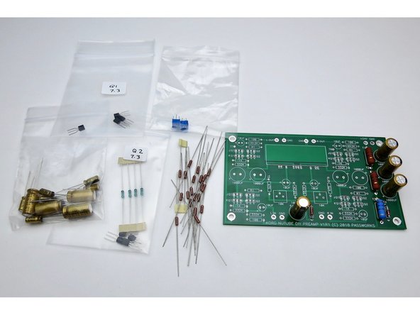

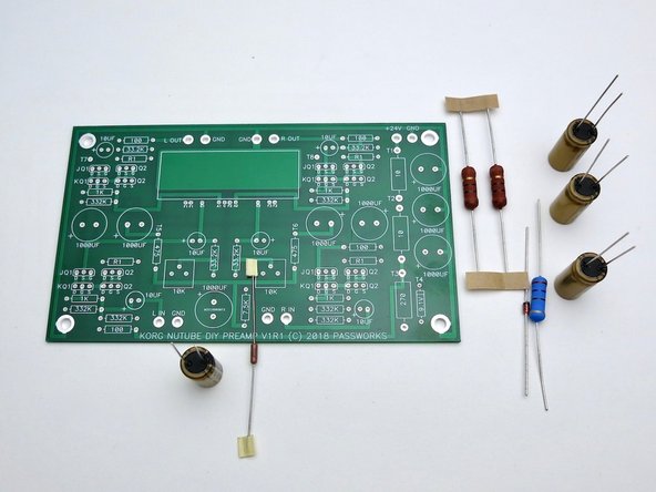

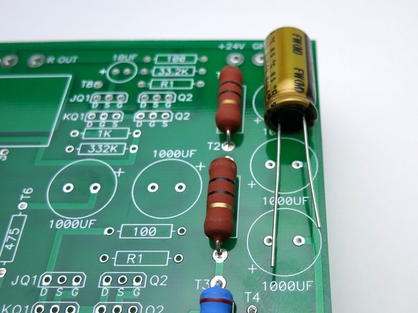

  34. We need to assemble and test the PSU first. Get these components, they are in the top part of the schematic. This section is common to both L and R channels. As always, print the schematic and have in front of you as you build.
    • We need to assemble and test the PSU first. Get these components, they are in the top part of the schematic. This section is common to both L and R channels.
    • As always, print the schematic and have in front of you as you build.
    • Photo 2 - If you have a lead bend tool, the small resistors and diode are on 0.5" spacing. The large resistors are 0.75", but you can just bend those leads straight down and it will be close enough.

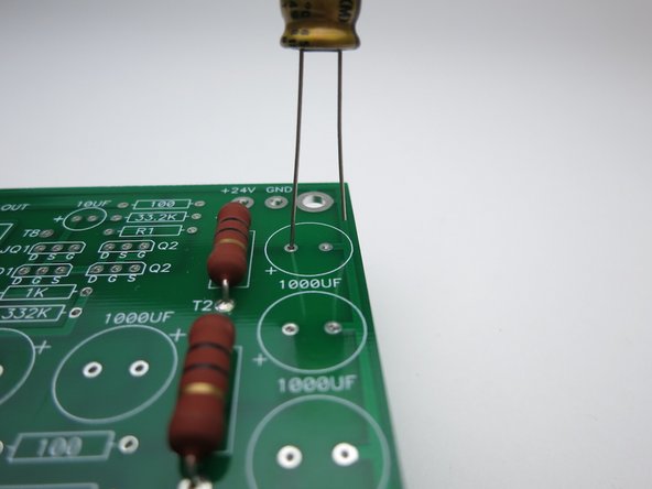

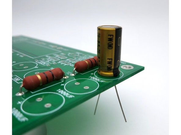

  35. Capacitors have polarity. The negative is marked on the can, and the positive is the long leg. Also note the PCB has the + marked. Photo 2 = Long leg into + Photo 3 - Bend the leads out a little to keep the components in the PCB before soldering.
    • Capacitors have polarity. The negative is marked on the can, and the positive is the long leg. Also note the PCB has the + marked.
    • Photo 2 = Long leg into +
    • Photo 3 - Bend the leads out a little to keep the components in the PCB before soldering.

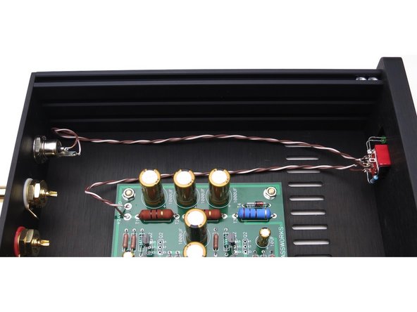

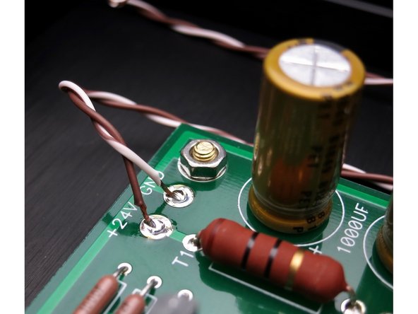

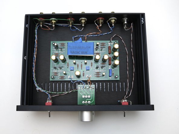

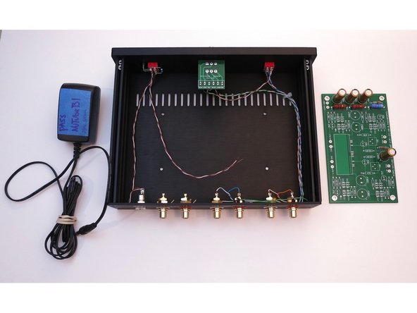

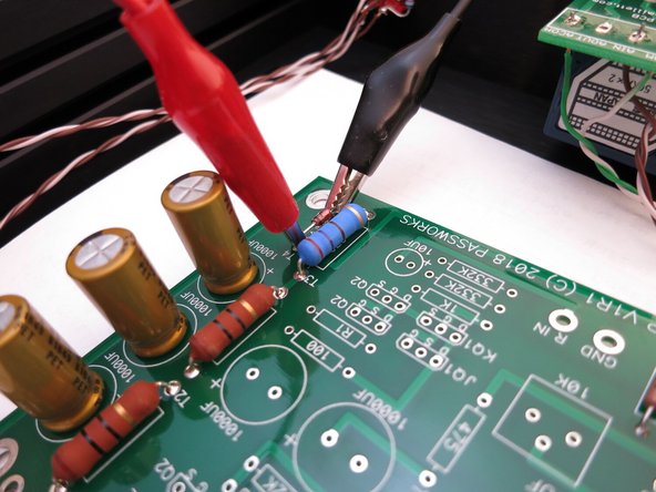

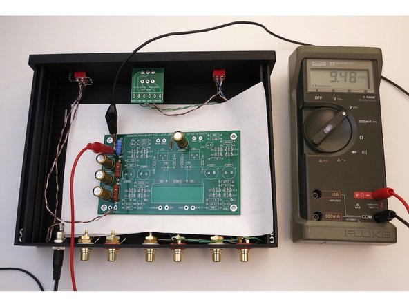

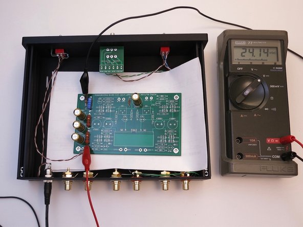

  36. Photo 2 - When you get these components stuffed stop and test the PSU. Get the wall wart, the wired chassis, a piece of paper or something non-conductive to insulate the board from the metal, and the PCB Wires from middle of power switch. Brown is barrel center, white/brn is tab. Get the wall wart, the wired chassis, a piece of paper or something non-conductive to insulate the board from the metal, and the PCB Wires from middle of power switch. Brown is barrel center, white/brn is tab.
    • Photo 2 - When you get these components stuffed stop and test the PSU.
    • Get the wall wart, the wired chassis, a piece of paper or something non-conductive to insulate the board from the metal, and the PCB Wires from middle of power switch. Brown is barrel center, white/brn is tab.
  37. Photo 1 - Wires from middle of power switch. Brown is barrel center, white/brn is tab. Photo 2 - Wires from bottom of switch to the PCB. Brown is +24V, brown/wht is GND Photo 3 - Power switch wires connected tp PCB
    • Photo 1 - Wires from middle of power switch. Brown is barrel center, white/brn is tab.
    • Photo 2 - Wires from bottom of switch to the PCB. Brown is +24V, brown/wht is GND
    • Photo 3 - Power switch wires connected tp PCB
  38. Attach PSU switch as shown. Ignore the fully stuffed PCB in the photo, it should only have PSU components on it right now!! Connect the power switch wires to the PCB (Step 40 - Photo 3) and power it on. Connect meter to places shown and you should have about 24V. Rest the PCB on a piece of paper to keep it from touching the metal chassis.
    • Attach PSU switch as shown. Ignore the fully stuffed PCB in the photo, it should only have PSU components on it right now!!
    • Connect the power switch wires to the PCB (Step 40 - Photo 3) and power it on. Connect meter to places shown and you should have about 24V.
    • Rest the PCB on a piece of paper to keep it from touching the metal chassis.
  39. Photo 1 - Also check the chassis LED Photo 2 - Move the multimeter red to the top (black band) leg of the diode and check the voltage of about 9.5V Photo 3 - If you have these readings, turn it all off, unsolder the Main PCB from the wires and continue.
    • Photo 1 - Also check the chassis LED
    • Photo 2 - Move the multimeter red to the top (black band) leg of the diode and check the voltage of about 9.5V
    • Photo 3 - If you have these readings, turn it all off, unsolder the Main PCB from the wires and continue.

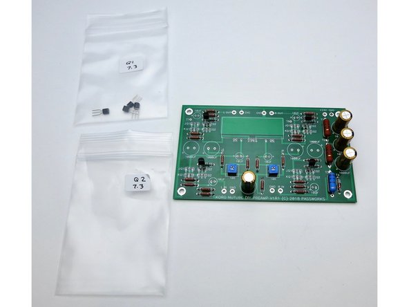

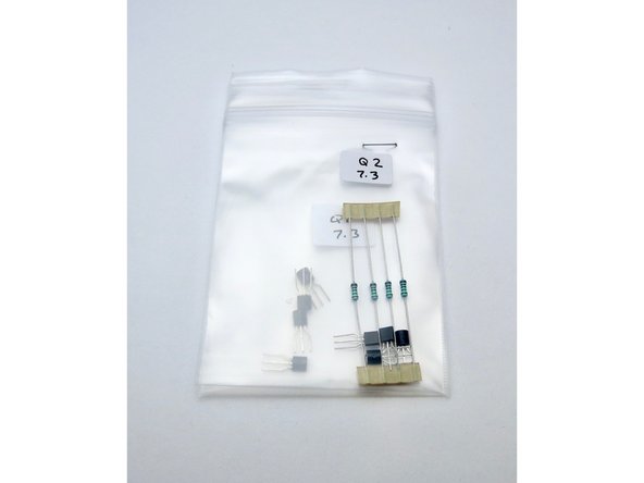

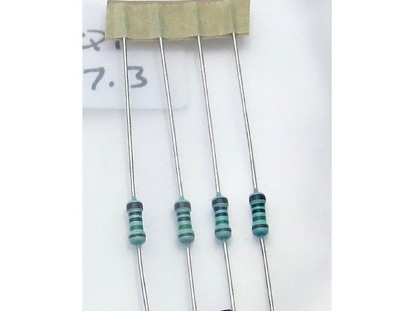

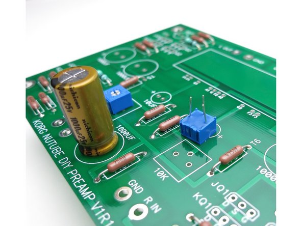

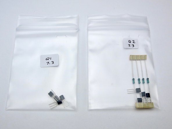

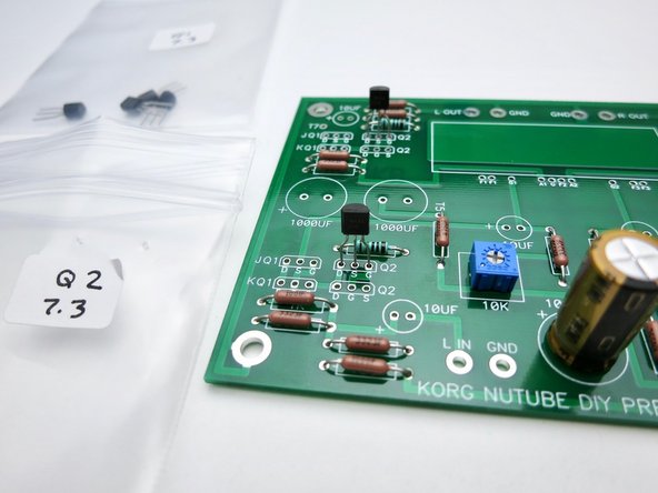

  40. The PCB kit comes with two bags with 4 transistors in each (8 total),  and 4 resistors, don't mix them up, and don't lose the resistors, as they are selected for those specific transistors, in your kit. The PCB kit comes with two bags with 4 transistors in each (8 total),  and 4 resistors, don't mix them up, and don't lose the resistors, as they are selected for those specific transistors, in your kit.
    • The PCB kit comes with two bags with 4 transistors in each (8 total), and 4 resistors, don't mix them up, and don't lose the resistors, as they are selected for those specific transistors, in your kit.

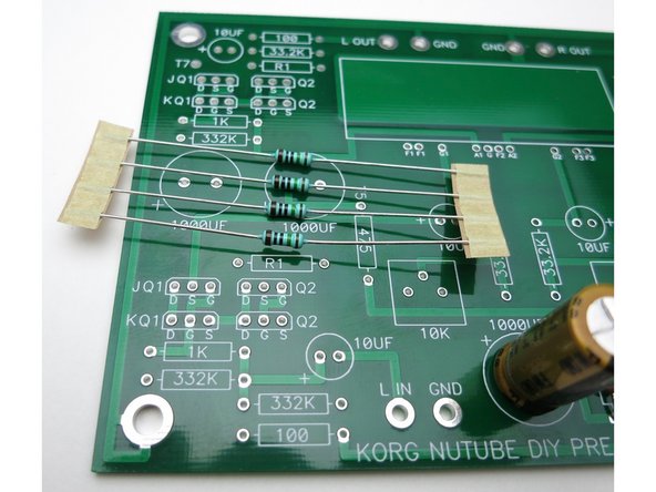

  41. The resistors go into the spot marked "R1" on the PCB, there are (4) places. Photo 1 - These locations have no value printed on them nor does the schematic have a value. They are selected to mate with the included transistors. Photo 2 - Gather the rest of the PCB parts Photo 3 - As mentioned earlier, the resistors are all on 0.5" lead spacing
    • The resistors go into the spot marked "R1" on the PCB, there are (4) places. Photo 1 - These locations have no value printed on them nor does the schematic have a value. They are selected to mate with the included transistors.
    • Photo 2 - Gather the rest of the PCB parts
    • Photo 3 - As mentioned earlier, the resistors are all on 0.5" lead spacing

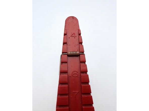

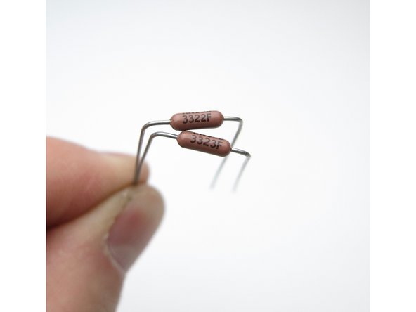

  42. Photo 1 - The Dale resistors have their value marked in digits on the side This is 3-digit+multiplier The top resistor is 100 ohms -- 100+0, or "one hundred ohms and zero zeroes" The bottom is 1K -- 100+1, "one hundred and one zero" Photo 2 - Top 33.2K "332 + two zeroes" Bottom 332K "332 + three zeroes" Photo 3 - Stuff all the resistors. The value is printed on the PCB except for the "R1" positions. Neatness counts. Bend all the leads so the value is on top and readable. Insert them into the PCB so the values read left to right or bottom to top. (On the R1s, put the thicker brown band to the right)
    • Photo 1 - The Dale resistors have their value marked in digits on the side This is 3-digit+multiplier The top resistor is 100 ohms -- 100+0, or "one hundred ohms and zero zeroes" The bottom is 1K -- 100+1, "one hundred and one zero"
    • Photo 2 - Top 33.2K "332 + two zeroes" Bottom 332K "332 + three zeroes"
    • Photo 3 - Stuff all the resistors. The value is printed on the PCB except for the "R1" positions. Neatness counts. Bend all the leads so the value is on top and readable. Insert them into the PCB so the values read left to right or bottom to top. (On the R1s, put the thicker brown band to the right)

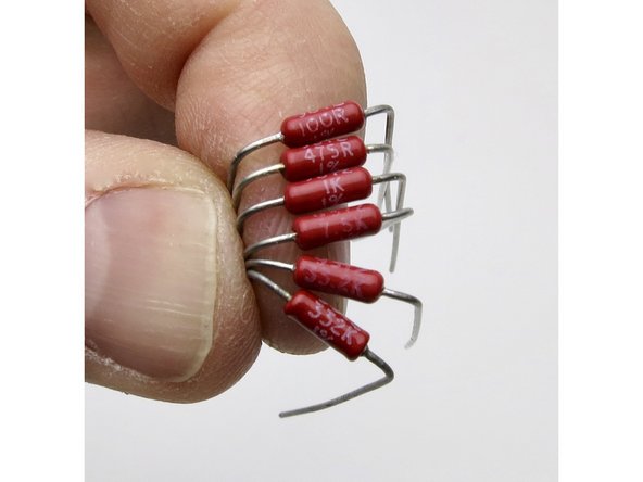

  43. The Autumn 2020 kits include PRP 9327 series resistors. These audio grade resistors are red and have the value printed directly on the body of the resistor with no code. Top to bottom, 100R, 457R, 1K, 7.5K, 33.2K, 332K.
    • The Autumn 2020 kits include PRP 9327 series resistors. These audio grade resistors are red and have the value printed directly on the body of the resistor with no code.
    • Top to bottom, 100R, 457R, 1K, 7.5K, 33.2K, 332K.
    • Photo 2 - reference of the location of the PRP (red) or Dale (tan) resistor locations.
    • Yes, the printing on the PRP can be a little tricky to see in photos. It's better in real life. The red also looks fantastic on the green PCB :)

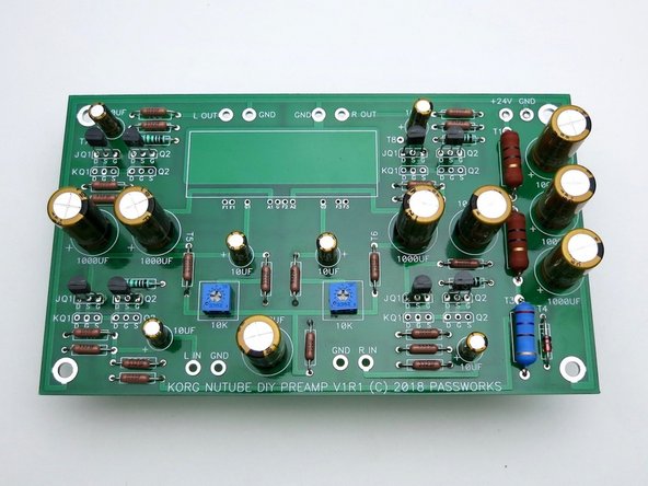

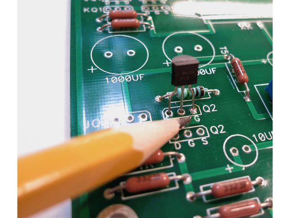

  44. Trimmer potentiometers Photo 2 - There are two rows in each position for Jfets, one marked "JQ1 Q2" the other marked "KQ1 Q2" …These boards will allow the use of different JFETs. If you purchased the full kit, ONLY stuff the locations marked with J. The rows with the J are for the J113 parts (Fairchild, included in the kits) The rows with K are for K170 parts (Toshiba, not included) Only use one or the other! You don't need to use both rows.
    • Trimmer potentiometers
    • Photo 2 - There are two rows in each position for Jfets, one marked "JQ1 Q2" the other marked "KQ1 Q2" …These boards will allow the use of different JFETs. If you purchased the full kit, ONLY stuff the locations marked with J. The rows with the J are for the J113 parts (Fairchild, included in the kits)
    • The rows with K are for K170 parts (Toshiba, not included) Only use one or the other! You don't need to use both rows.
    • Photo 3 - Kit parts use the "J" row

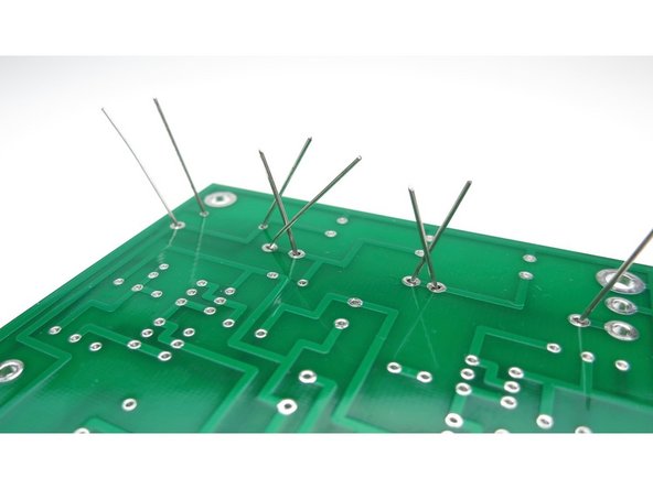

  45. Photo 1 - You can solder one leg from the top to keep them in place when you solder the bottom. Photo 2 - Stuff the other bag Photo 3 - Jfets complete
    • Photo 1 - You can solder one leg from the top to keep them in place when you solder the bottom.
    • Photo 2 - Stuff the other bag
    • Photo 3 - Jfets complete

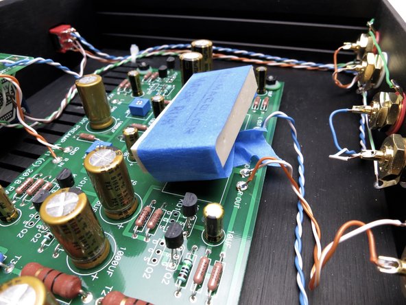

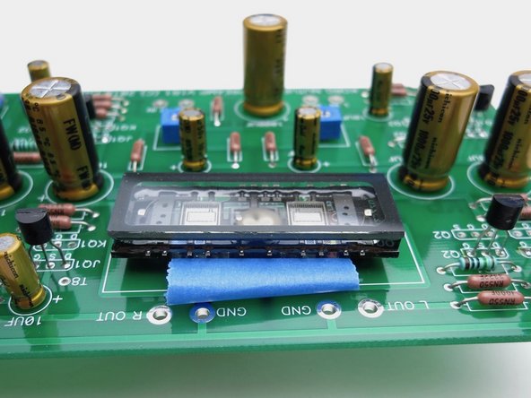

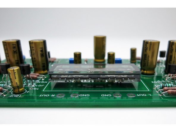

  46. Photo 1 - NuTube is next. Make a loop of tape under the NuTube to make some room above the PCB, you don't want it to touch. Solder the pins Photo 2 - Let it float above the board Photo 3 - Fully stuffed PCB
    • Photo 1 - NuTube is next. Make a loop of tape under the NuTube to make some room above the PCB, you don't want it to touch. Solder the pins
    • Photo 2 - Let it float above the board
    • Photo 3 - Fully stuffed PCB

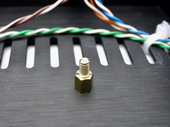

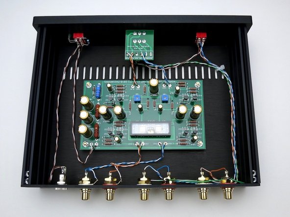

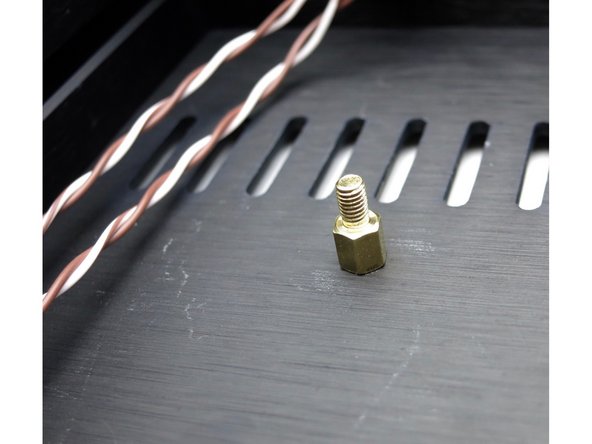

  47. The standoffs attach to the inside of the bottom panel. The standoffs attach to the inside of the bottom panel. The standoffs attach to the inside of the bottom panel.
    • The standoffs attach to the inside of the bottom panel.
  48. Attach wires from potentiometer to Korg PCB Blue and white/blue for Left.      Orange and white/orange for Right. Attach wires from potentiometer to Korg PCB Blue and white/blue for Left.      Orange and white/orange for Right. Attach wires from potentiometer to Korg PCB Blue and white/blue for Left.      Orange and white/orange for Right.
    • Attach wires from potentiometer to Korg PCB Blue and white/blue for Left. Orange and white/orange for Right.

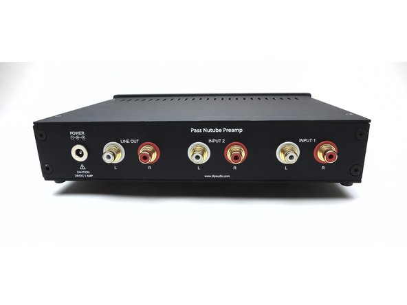

  49. Photo 1 - Attach output RCAs as shown. We will use the same colors as the short leads from the pot board to the main PCB. Photo 2 - Attach knob
    • Photo 1 - Attach output RCAs as shown. We will use the same colors as the short leads from the pot board to the main PCB.
    • Photo 2 - Attach knob
  50. Front & rear views of completed kit. Front & rear views of completed kit.
    • Front & rear views of completed kit.
  51. The Nutube can be microphonic. Everybody will hear it when they flip a switch, but some of the Nutube themselves are worse than others, it seems to be the vagaries of production. I tried a number of different solutions and the best results were to take a white latex pencil eraser to the to top of the glass, and then seal up the vent holes in the chassis. Newer chassis will not have vent holes. This is a self-adhesive rubberized material similar to Dynamat.
    • The Nutube can be microphonic. Everybody will hear it when they flip a switch, but some of the Nutube themselves are worse than others, it seems to be the vagaries of production.
    • I tried a number of different solutions and the best results were to take a white latex pencil eraser to the to top of the glass, and then seal up the vent holes in the chassis. Newer chassis will not have vent holes.
    • This is a self-adhesive rubberized material similar to Dynamat.

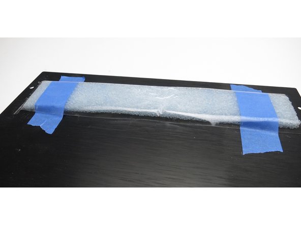

  52. If you have the production run of the B1K you can skip this step. This step is only relevant to the pioneer batch of chassis which has vents in the covers. Photo 2 - This is just some closed-cell shipping foam taped to the inside of the vents. Both it and the sticky foil-backed material worked well. Blocking it seems to be more important than absorbing or damping. If anybody has suggestions or examples of what works, please share them!
    • If you have the production run of the B1K you can skip this step. This step is only relevant to the pioneer batch of chassis which has vents in the covers.
    • Photo 2 - This is just some closed-cell shipping foam taped to the inside of the vents. Both it and the sticky foil-backed material worked well. Blocking it seems to be more important than absorbing or damping.
    • If anybody has suggestions or examples of what works, please share them!
