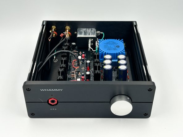

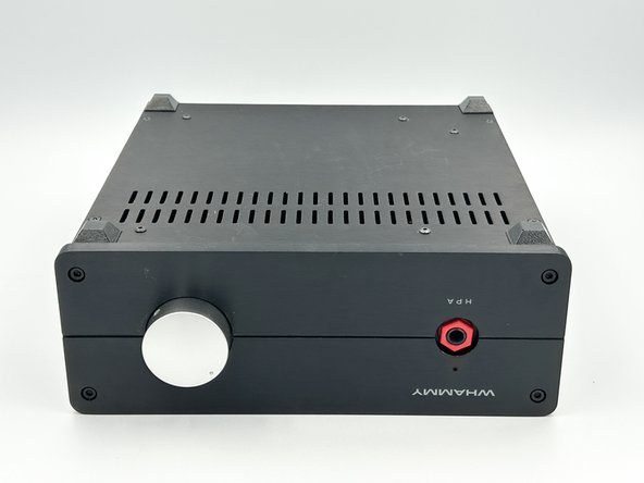

Introduction

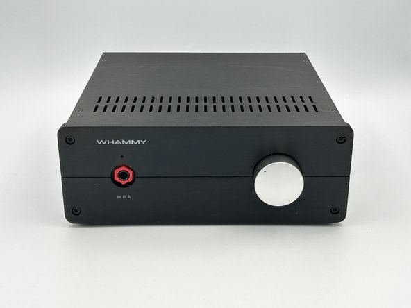

What Are We Building?
This guide covers the assembly of the:

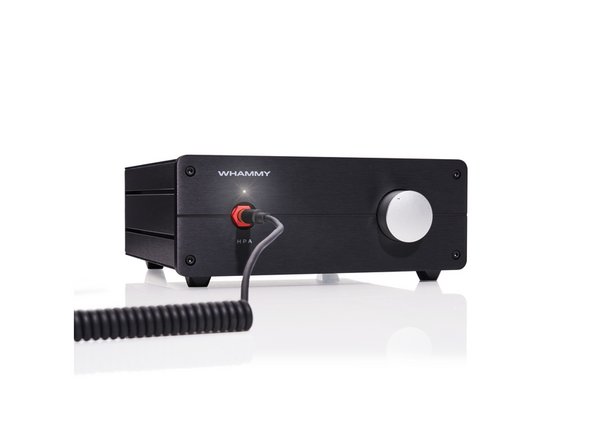

Wayne's
Headphone
Amplifier
Must
Make
Yourself
Here is a video of Wayne talking about the WHAMMY at BAF 2017: Wayne Colburn at BAF '17
100s of DIYers have built the WHAMMY. It is many people's favorite headamp for good reason.

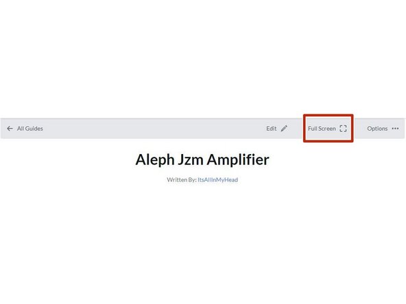

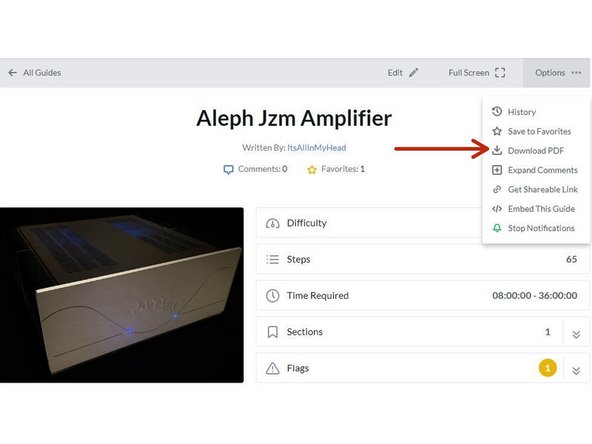

  2. Your first "real" black bullet.  You may notice that you have the option to view in "Full Screen".  I like it either way, but I prefer full screen.  This web platform works well with tablets too.  I've tested it with various monitors of various aspect ratios and tablets.  Choose what looks best to you.  The printed .pdf format is nice too. Image 1 - If you don't know how to get to "Full screen", take note of the box around "Full screen" at the top of the guide above the header / title.  That's where you click to move to Full Screen.
    • Your first "real" black bullet. You may notice that you have the option to view in "Full Screen". I like it either way, but I prefer full screen. This web platform works well with tablets too. I've tested it with various monitors of various aspect ratios and tablets. Choose what looks best to you. The printed .pdf format is nice too.
    • Image 1 - If you don't know how to get to "Full screen", take note of the box around "Full screen" at the top of the guide above the header / title. That's where you click to move to Full Screen.
    • Image 2 - If you don't know how to print the document. Note that you can download this guide as a .pdf and print it.
    • In all the on-line views, if there are multiple images and/or photos within a step, mouse-over or tap/click as appropriate to make which ever one you'd like the primary image (the biggest one).
    • Mousing over / tapping on the primary image will change the cursor to a magnifying glass. Clicking / double tapping will open a new tab or enlarge and center the image on your screen.
    • In full-screen mode, the keyboard right and left arrows or clicking the arrows in the upper right will advance or reverse one step.

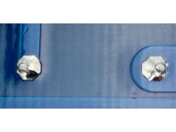

    • The most common issues with builds are mis-stuffed parts and poor solder joints.
    • Symptoms from mis-stuffed parts typically manifest quickly. For this build, pay particular attention to the voltage regulators and the output MOSFETs. The impact from an improper part placement can be benign, or you could release the "magic smoke".
    • The impact of poor soldering varies. A short/bridge that will impact your build is unlikely, but can be catastrophic. More commonly, the issues are partial coverage or a cold joint. Symptoms may not manifest until you least expect them, and they may be intermittent. Inspect each and every joint under magnification. You'll be glad you did.

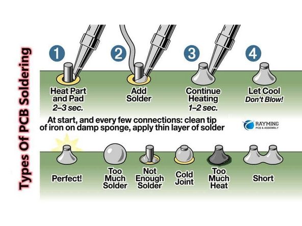

    • Cleaning and inspecting the joint. It is strongly recommended to use magnification and good lighting to inspect each and every joint.
  3. This guide does not cover how to solder / install through hole parts.  There are a variety of great ways to install a part and achieve a proper solder joint, but there are common themes throughout.  Below are a few links.  See what works best for you.  Neither diyAudio nor the author have any affiliation with any of the companies or persons linked.
    • This guide does not cover how to solder / install through hole parts. There are a variety of great ways to install a part and achieve a proper solder joint, but there are common themes throughout. Below are a few links. See what works best for you. Neither diyAudio nor the author have any affiliation with any of the companies or persons linked.
    • An Instructables Guide To Soldering
    • A Sparkfun Guide To Soldering
    • A Mr. SolderFix Video
    • A Rayming PCB Guide to Soldering
    • Image 1 - A basic soldering sequence and examples of both good and poor joints. Taken from the Rayming PCB & Assembly Guide linked above.
    • The key variables to soldering are the type of solder chosen, the tip used, and the tip temperature. These all vary widely between users and are inter-related. If you are new to electronics, the best solution is practice. Scrap electronics and inexpensive parts are a wonderful way to learn.
    • Leaving the iron tip on the joint for longer than around 5 seconds is not a substitute for too small an iron tip or too low a temperature. If you need to reflow a joint, or if the solder isn't flowing, flux is your friend.
    • The builder must ensure all terminations are done properly for safe and trouble-free operation.

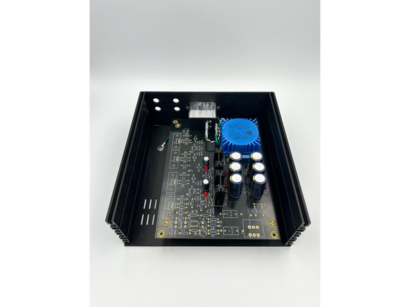

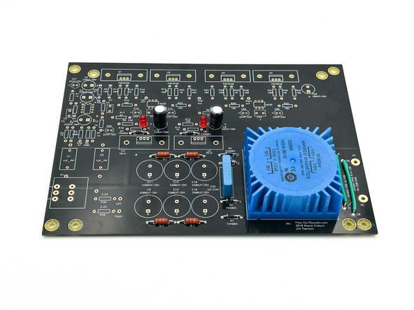

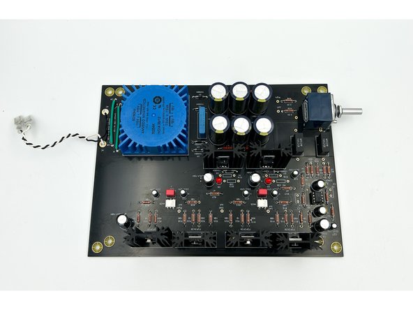

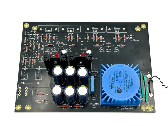

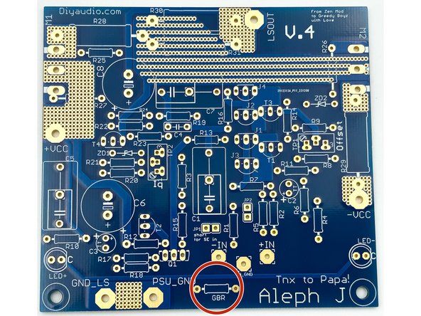

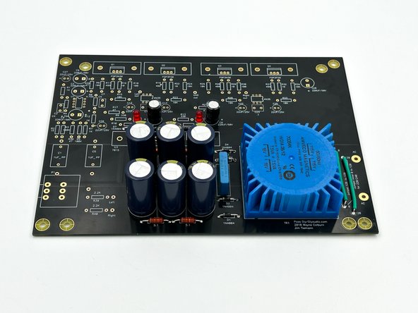

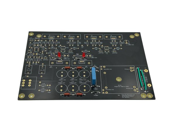

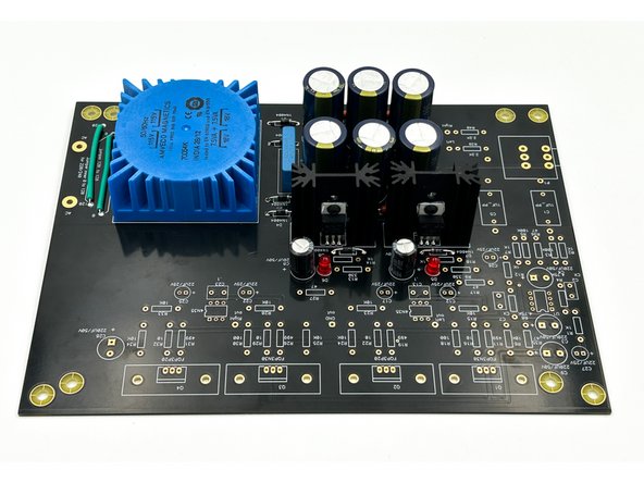

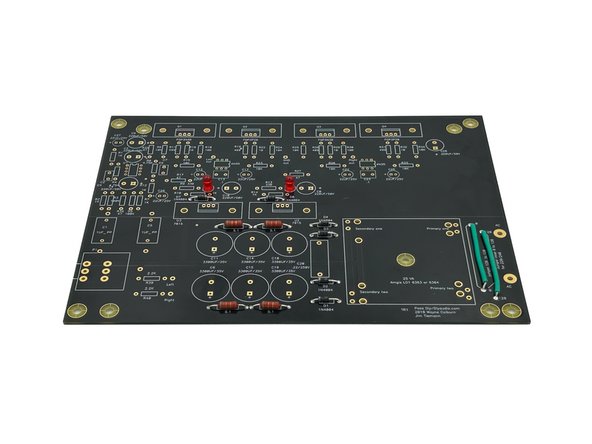

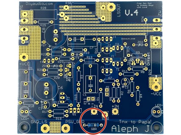

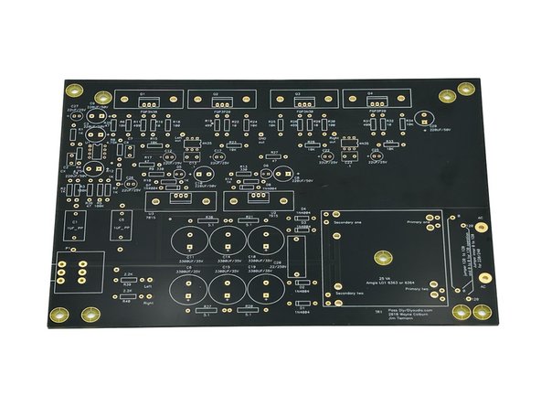

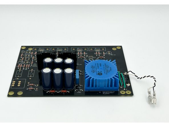

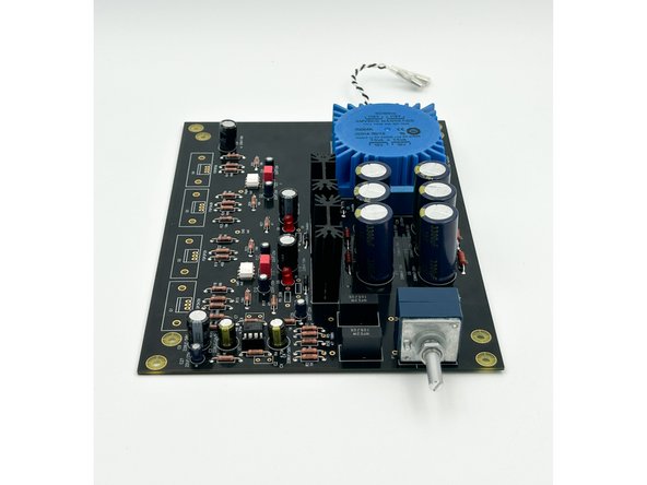

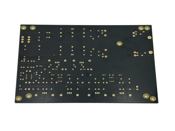

  4. Look over your boards and get familiar with the parts placement. Image 1 - Front view of the PCB, sometimes referred to as the component side.
    • Look over your boards and get familiar with the parts placement.
    • Image 1 - Front view of the PCB, sometimes referred to as the component side.
    • You will not stuff every component. The PCBs include options for various power supply configurations. This guide covers the most popular configuration.
    • Image 2 - Back view of the PCB, sometimes referred to as the solder side. You will not install any components on the back of the board for a typical build. However, there are one or two notes for more advanced builders that may want to install components on the back of the board. This will not be demonstrated in the guide.
    • Generally, we prefer the flow of installing the shortest parts to the tallest. However, for this build, since it is a single PCB, the recommended sequence deviates slightly. The PSU segment will be assembled and tested first. Once the PSU is verified, the rest of the components can be installed.
    • Each section of the stuffing and inspection checklist can be done together. It is not important to do each part within a section in order. As an example, it is not recommended to install the small resistors in numerical sequence. Install them in groups of the same value. That makes assembly faster and results in fewer errors.
    • The examples in Steps 14-16 are from an Aleph Jzm build, but the exact same principles apply to the WHAMMY. The steps illustrate the use of the documents to ensure the board is stuffed properly and has the highest likelihood of working properly on the first attempt. Builders are free to use their own methods and/or adapt what's been provided.

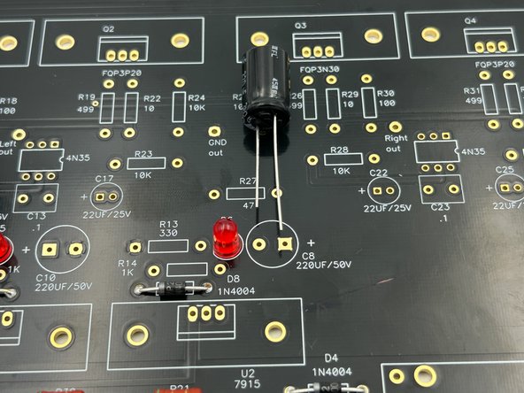

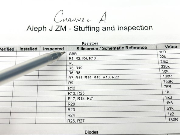

  5. It is not necessary to install all the parts  in exact order.   Within a parts group, my preference is to: Photo 1 - Remove one set of parts from the parts bag.  In this case a pair of resistors.  For the WHAMMY, many of the parts will not be on cut-tape. Builders may choose to measure, pre-sort, and label all the parts prior to installation. Photo 2 - Measure / validate the part.  In this case, measure the resistor with a DMM.
    • It is not necessary to install all the parts in exact order. Within a parts group, my preference is to:

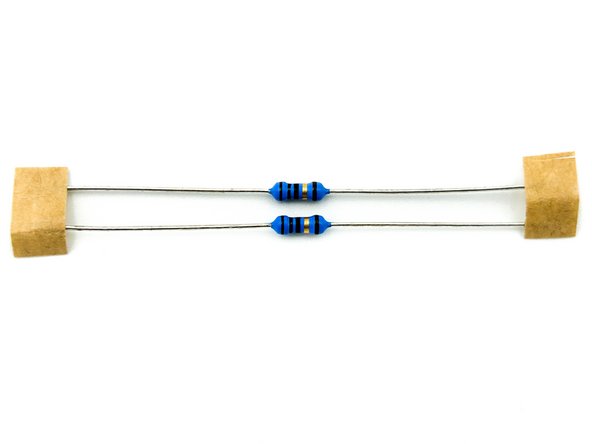

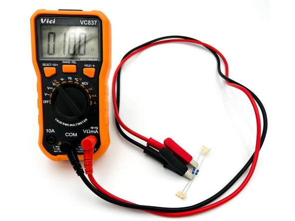

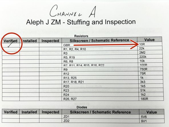

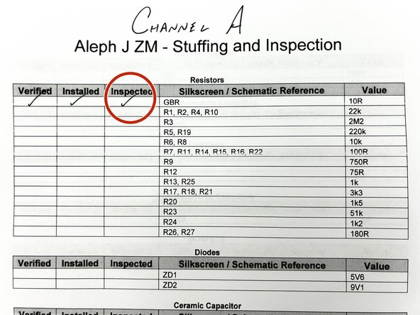

    • Photo 1 - Remove one set of parts from the parts bag. In this case a pair of resistors. For the WHAMMY, many of the parts will not be on cut-tape. Builders may choose to measure, pre-sort, and label all the parts prior to installation.
    • Photo 2 - Measure / validate the part. In this case, measure the resistor with a DMM.
    • Photo 3 - Validate which part corresponds to the part in-hand using the stuffing and inspection list.
  6. (Continued) Photo 4 - Validate that the part notation and value match the schematic and cross the part(s) off the schematic.
    • (Continued)
    • Photo 4 - Validate that the part notation and value match the schematic and cross the part(s) off the schematic.
    • Photo 5 - Note the part(s) value was verified against the schematic.

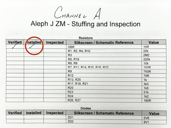

  7. (Continued) Photo 6 - Validate the part's placement on the board.
    • (Continued)
    • Photo 6 - Validate the part's placement on the board.
    • Photo 7 - Install the Part
  8. (Continued) Photo 9 - Note that the part was installed. Photo 10 - Inspect the joints.  Clean as needed.
    • (Continued)
    • Photo 9 - Note that the part was installed.
    • Photo 10 - Inspect the joints. Clean as needed.
    • Photo 11 - Once everything looks great, note that the part(s) have been inspected.
    • Open the bags of parts, verify them against your packing list and get to know what they look like.
    • Place all of your parts carefully in a bowl or somewhere they will not get lost, knocked onto the floor, accidentally spread around your workbench, or mixed in with other parts not associated with this project.
    • Many people like to separate their parts by type. For this project, it's not necessary, but choose whatever method works best for you. It's fairly simple to keep all the parts together and select only what is required for a particular step.

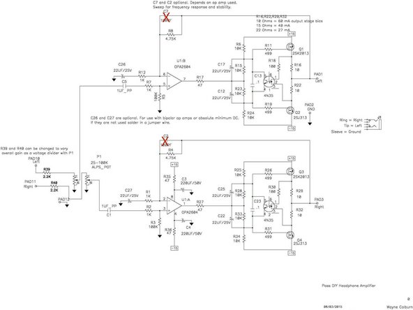

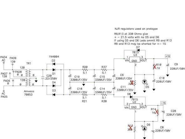

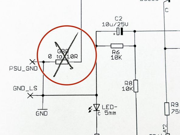

  9. If you haven't already, print the PSU schematic. The .pdf is included in the documents section.
    • If you haven't already, print the PSU schematic. The .pdf is included in the documents section.
    • Image 1 - For this build, you will not install, R9, R10, R13, or R14

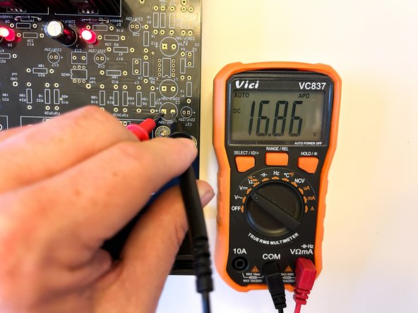

    • Ensure you have your PSU Schematic and your stuffing and inspection checklist.
    • It is important to test the power supply before installing other critical components. It will help prevent a number of potential problems later in the build.
    • This guide demonstrates the most popular option using a red LED as a voltage reference. It is the quietest option, and it functions beautifully. Advanced DIYers can explore other options separate from this guide. If you wish to explore other options, visit the WHAMMY build and discussion thread. Link to Discussion Thread
    • REMEMBER - NOT ALL COMPONENTS WILL BE INSTALLED.

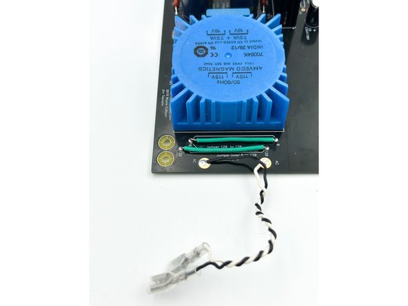

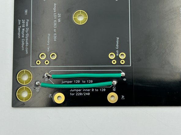

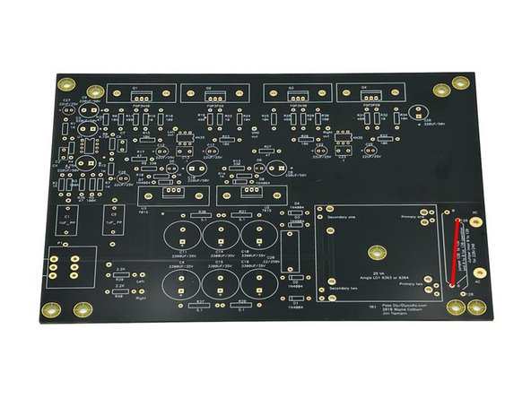

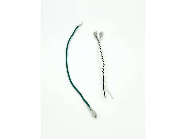

  10. The PCB is configured for both 110/115 VAC and 220/230VAC mains voltages.  Selecting the mains voltage is as simple as installing a jumper wire or two. For 110/115VAC - Cut two pieces (about 2.5" / 6.5cm) of the black or white hookup wire (it does not matter what color) and install the jumpers as shown in photo 1.  Note - The green wire included in the kits is a little large.
    • The PCB is configured for both 110/115 VAC and 220/230VAC mains voltages. Selecting the mains voltage is as simple as installing a jumper wire or two.

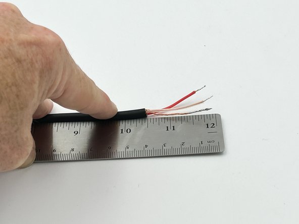

    • For 110/115VAC - Cut two pieces (about 2.5" / 6.5cm) of the black or white hookup wire (it does not matter what color) and install the jumpers as shown in photo 1. Note - The green wire included in the kits is a little large.
    • For 220/230VAC - Cut a single piece (about 3" / 7.5cm) of the black or white hookup wire (it does not matter what color) and install the jumper as shown in photo 2. Note, the green wire included in the kits is a little large.
    • Photo 1 - Install jumpers as shown for 110/120VAC (Once again - the green wire in the kits will likely be a little too large in diameter).
    • Photo 2- Install jumper as shown for 220/230VAC

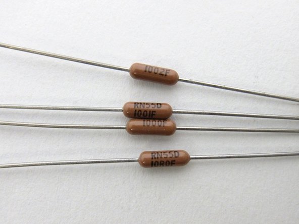

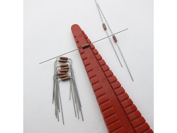

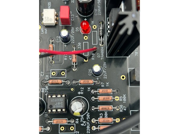

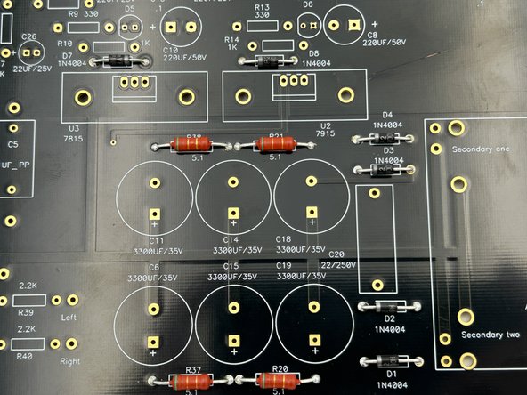

  11. Remember to measure the resistance for every part before installation and follow the validation / installation / inspection process.
    • Remember to measure the resistance for every part before installation and follow the validation / installation / inspection process.
    • It is helpful to use a lead forming tool. The pitch for the large resistors is 3/4"(19mm). The pitch for the diodes is 1/2"(13mm)

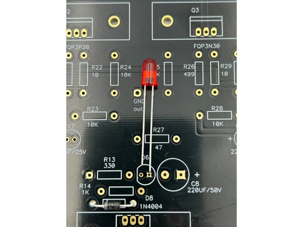

    • Install R20, R21, R37, R38 and D1, D2, D3, D4, D7, D8. Pay attention to the orientation of D7.
    • Photo 1 - Your board should look something like this. Ignore the boneheaded scratch, please.
  12. Photo 1 - The Anode (Positive, Long Leg) of the LEDs is installed with the square pad. Install D5, and D6
    • Photo 1 - The Anode (Positive, Long Leg) of the LEDs is installed with the square pad.
    • Install D5, and D6
    • Photo2 - LEDs installed.

  14. Your kit contains two types of 200uF capacitors.  One type is rated for 50V and one type is rated for 25V.  Ensure you install the 50V capacitors.  The voltage rating is marked on the package. They are physically larger than the 25V capacitors, and you can match the quantity on your parts list.
    • Your kit contains two types of 200uF capacitors. One type is rated for 50V and one type is rated for 25V. Ensure you install the 50V capacitors. The voltage rating is marked on the package. They are physically larger than the 25V capacitors, and you can match the quantity on your parts list.
    • Verify the orientation of the electrolytic capacitors! The negative side a.k.a. the cathode is indicated with a band. The cathode lead is the shorter of the two leads. The positive side a.k.a. the anode is the longer of the two leads. The anode aligns with the square pad. A (+) is also indicated on the silkscreen.
    • Photo 1 - The longer of the two leads aligns with the square pad
    • Install C8 and C10
  15. The transformer will only install into the PCB in one orientation.  If you need to bend the pins slightly, do so gently.  Do not try to force the transformer into place.
    • The transformer will only install into the PCB in one orientation. If you need to bend the pins slightly, do so gently. Do not try to force the transformer into place.
    • Install the transformer
    • Photo 1 - Transformer Installed
  16. Verify the orientation of the electrolytic capacitors!  The negative side a.k.a. the cathode is indicated with a band.  The cathode lead is the shorter of the two leads.  The positive side a.k.a. the anode is the longer of the two leads.  The anode aligns with the square pad.  A (+) is also indicated on the silkscreen.
    • Install the large capacitors, C6, C11, C14, C15, C18, and C19
    • Photo 1 - Capacitors Installed

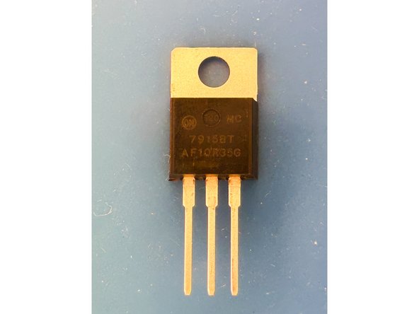

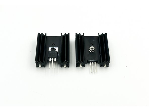

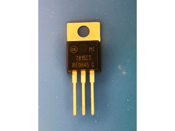

  17. Ensure that you identify the voltage regulators and separate them.  Use magnification if needed and double check the case markings. Photo 1 - 7815 Regulator
    • Ensure that you identify the voltage regulators and separate them. Use magnification if needed and double check the case markings.
    • Photo 1 - 7815 Regulator
    • Photo 2 - 7915 Regulator

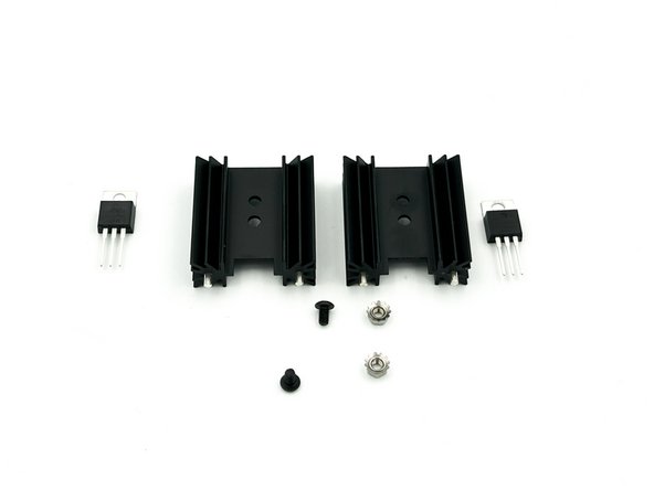

  18. 2X Heatsinks, 2X 5mm Cap Head Screws, 2X K-Nuts, and the thermal paste are required for this step. Photo 1 - Heatsinks, 2X 5mm Cap Head Screws, 2X K-Nuts Spread a small amount of thermal paste onto the back of each regulator.  A little goes a long way. Place the regulators back-to-back and wiggle them a little to spread the paste evenly.
    • 2X Heatsinks, 2X 5mm Cap Head Screws, 2X K-Nuts, and the thermal paste are required for this step.
    • Photo 1 - Heatsinks, 2X 5mm Cap Head Screws, 2X K-Nuts
    • Spread a small amount of thermal paste onto the back of each regulator. A little goes a long way. Place the regulators back-to-back and wiggle them a little to spread the paste evenly.
    • Photo 2 -Thermal paste applied
    • Install each regulator onto a heatsink using the screws and nuts. Install them regulators into the lower holes. Do not fully tighten. Ensure that the legs of the regulators align with the heatsink pins.
    • Photo 3 - Regulators loosely installed onto heatsinks (front and back).
  19. Identify one regulator assembly and slide it into the position marked U2 for the 7915 or U3 for the 7815.  Both 7915/7815 and U2/U3 are marked clearly on the silkscreen.  Double check it!
    • Identify one regulator assembly and slide it into the position marked U2 for the 7915 or U3 for the 7815. Both 7915/7815 and U2/U3 are marked clearly on the silkscreen. Double check it!
    • Solder the pins of the heatsink only to the PCB to hold the regulator assembly in place. If you have a large tip and/or a soldering station with a variable temperature control; now is the time to put a little heat to it. If you do not, just be patient. You can hold the iron to the heatsinks for quite some time without damaging anything.
    • Tighten the bolt / nut to securely hold the regulator to the heatsink. There is no need to overtighten. Just a little over 'finger-tight' is perfect.
    • Repeat the steps above for the other regulator assembly.
    • Triple check that the regulators are in the correct locations. Solder the legs of the regulators in place.
    • The legs of the regulator are soldered in place last for two reasons. 1 - To allow the builder to check, double-check, and triple-check this important operation a number of times before soldering. 2 - Tightening the assembly before soldering allows the part to be in place fully before soldering, thus reducing stress on the joint.
    • Photo 1 - Regulators Installed

  21. Cut approximately 6" of the green wire.  Crimp and/or solder one 6.3mm female spade connector to one end.  Slide the spade insulator onto the wire and over the spade. Crimp and/or solder one ring terminal to the other end.  Note - The insulation was removed from the ring terminal allowing it to be crimped and soldered. Cut approximately 6.5" of the white and black wires.  Crimp one 6.3mm female spade connector to one end of each wire.  Slide the spade insulators onto the wire and over the spades.  Twist the black and white wires together leaving approximately 1/2" on the spade end and approximately 1" on the bare end. In the USA, black is typically used to designate the live wire carrying the current to the load.  White is typically used to designate the neutral wire providing the return path.  The neutral wire will typically be connected to mains earth within the building.
    • Cut approximately 6" of the green wire. Crimp and/or solder one 6.3mm female spade connector to one end. Slide the spade insulator onto the wire and over the spade. Crimp and/or solder one ring terminal to the other end. Note - The insulation was removed from the ring terminal allowing it to be crimped and soldered.
    • Cut approximately 6.5" of the white and black wires. Crimp one 6.3mm female spade connector to one end of each wire. Slide the spade insulators onto the wire and over the spades. Twist the black and white wires together leaving approximately 1/2" on the spade end and approximately 1" on the bare end.
    • In the USA, black is typically used to designate the live wire carrying the current to the load. White is typically used to designate the neutral wire providing the return path. The neutral wire will typically be connected to mains earth within the building.
    • Photo 1 - Two wire assemblies; Mains Earth connection and AC Live and Neutral.
    • Solder the white and black wires to PCB at the positions marked "AC". Live (black) should connect to the lead winding of the primary, which is the AC pad towards the middle of the PCB. Neutral (white) should connect to the trailing lead, the AC pad closer to the corner.
    • Photo 2 - AC wiring attached to PCB
    • Note - This is a test to see if you were paying attention. The white and black leads are reversed in the photo. The written instructions are correct.

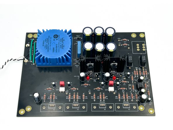

    • Photo 3 - PCB with completed PSU section.

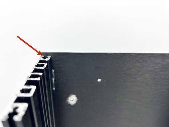

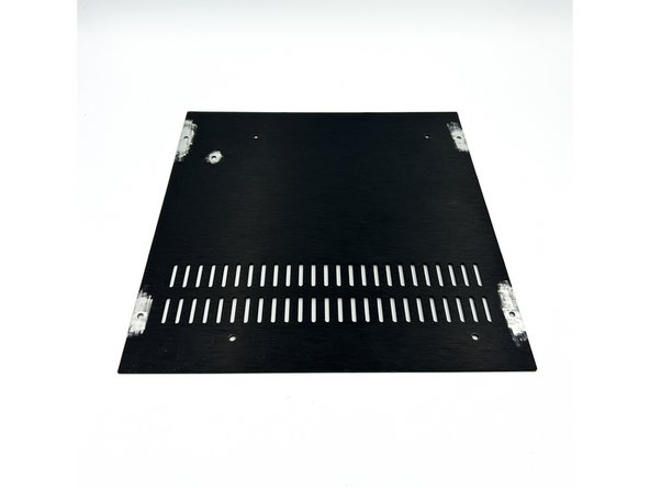

  22. Removing too much anodization will result in visible bare spots. A test fit is strongly recommended prior to removing anodization to ensure you do not remove too much. Some builders have suggested painter's tape to protect certain areas of the panels. Go slowly. Using your favorite method (a rotary tool works nicely as does a few scrapes with a razor blade) expose some bare metal by removing the anodization from the side panels in a few places where they will meet the top, bottom, front and back panels. Photo 1 - Side panels with some anodization removed.  It's a bit overkill in this example.  The 'bottom' and 'front' of the side panels (not visible) also have the anodization removed similarly.
    • Removing too much anodization will result in visible bare spots. A test fit is strongly recommended prior to removing anodization to ensure you do not remove too much. Some builders have suggested painter's tape to protect certain areas of the panels. Go slowly.
    • Using your favorite method (a rotary tool works nicely as does a few scrapes with a razor blade) expose some bare metal by removing the anodization from the side panels in a few places where they will meet the top, bottom, front and back panels.
    • Photo 1 - Side panels with some anodization removed. It's a bit overkill in this example. The 'bottom' and 'front' of the side panels (not visible) also have the anodization removed similarly.
    • Ensure you identify the "interior / exterior" surfaces of the top and bottom panels. The exterior surface has the countersunk holes for fastening to the side panels.

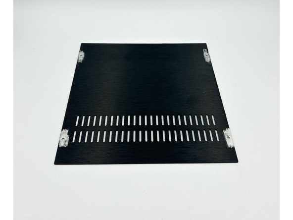

    • Remove some of the anodization on the INTERIOR surface of the top and bottom panels where they will meet the side panels along with an area around the ground mounting hole on the bottom panel.
    • Photo 2 - Bottom panel with some anodization removed.
    • Photo 3 - Top Panel with some anodization removed.

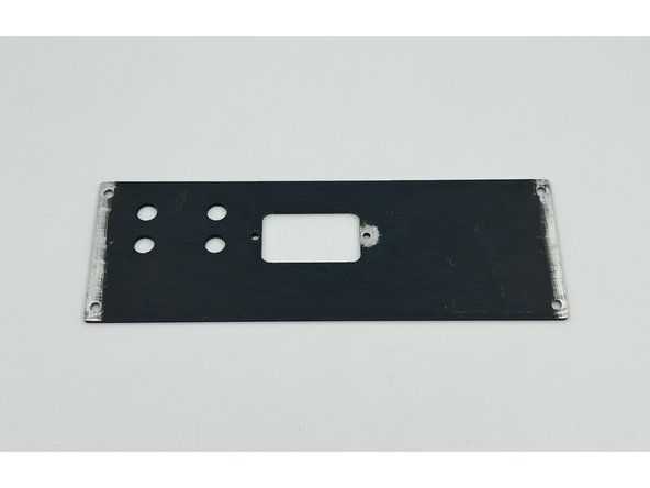

    • Remove some of the anodization on the interior surface of the back panel where it will meet the side panels along with an area around the mounting hole for the PEM closest to the earth lug. If in doubt, remove the anodization around both holes. It is critical to remove the anodization where Protective Earth connects to the chassis.
    • Photo 1 - Interior of Back Panel

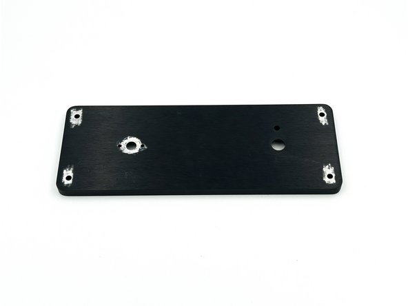

    • Remove some of the anodization on the interior of the front panel where it makes contact with the volume pot and the side panels.
    • Photo 2 - Interior of Front Panel

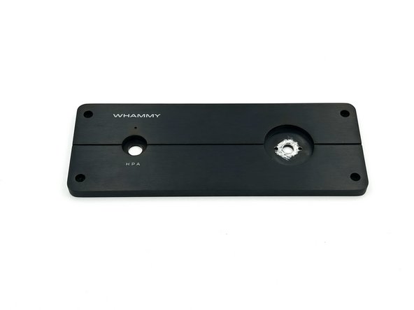

    • Remove some of the anodization on the exterior of the front panel where it makes contact with the volume pot.
    • Photo 3 - Exterior of Front Panel

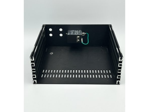

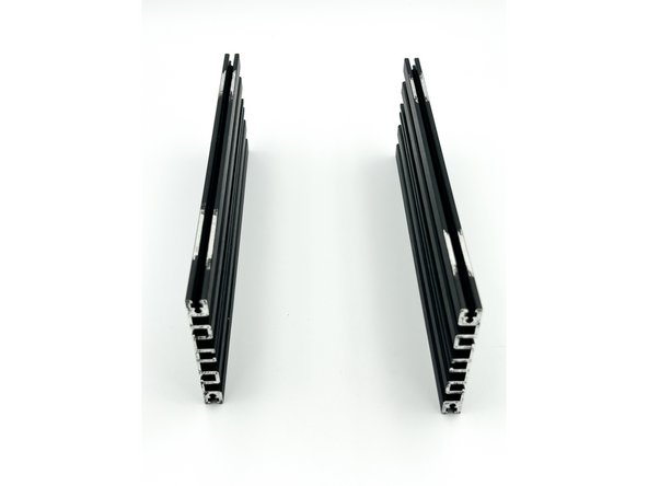

  24. Slide two of the M3 nuts included with the chassis into each of the side rails. Fasten the bottom panel to the side rails using the black flat head screws included with your chassis.  Leave them just slightly loose.  Note - the side with two slots typically faces the interior of the chassis, but choose whatever you like aesthetically. Set the side panels upright on a flat surface and allow the bottom panel to slide down leaving a slight gap at the 'top'.  Tighten the screws to the bottom panel. The bottom, top, left, right, front, and back of the chassis are now established.
    • Slide two of the M3 nuts included with the chassis into each of the side rails.
    • Fasten the bottom panel to the side rails using the black flat head screws included with your chassis. Leave them just slightly loose. Note - the side with two slots typically faces the interior of the chassis, but choose whatever you like aesthetically.
    • Set the side panels upright on a flat surface and allow the bottom panel to slide down leaving a slight gap at the 'top'. Tighten the screws to the bottom panel. The bottom, top, left, right, front, and back of the chassis are now established.
    • Photo 1 - The M3 screws slide into the top notch on each side panel. Note, this photo was taken before the anodization was removed.
    • Photo 2 - Side panels attached to the bottom panel. Placing the assembly upright on a flat surface before tightening the screws ensures the proper gap at the back of the chassis.
    • Photo 3 - Notice the gap at the top. This is the back of the chassis.
  25. Using the larger black, flat head screws included with the chassis, securely fasten the back panel to the side panels. Most people like to toggle the switch 'Up' to turn the unit on.  Make sure your orientation is the way you like it.  Slide the PEM through the back panel from the exterior.  Using a black 10mm flat head screw and a Keps nut, loosely secure the PEM to the back panel on the side furthest away from the mains earth tab on the PEM.
    • Using the larger black, flat head screws included with the chassis, securely fasten the back panel to the side panels.
    • Most people like to toggle the switch 'Up' to turn the unit on. Make sure your orientation is the way you like it. Slide the PEM through the back panel from the exterior. Using a black 10mm flat head screw and a Keps nut, loosely secure the PEM to the back panel on the side furthest away from the mains earth tab on the PEM.
    • Using a black 10mm flat head screw and a Keps nut, secure the ring termination of the green wire assembly and the PEM to the back panel. Ensure that the ring termination is making clean contact with the bare metal exposed on the rear panel.
    • Tighten both screws / nuts securely. Slide the 6.3mm female blade connector onto the PEM mains earth tab. The connection should be tight. If it is not, stop and seek assistance.
    • Photo 1 - Note the markings on the PEM indicating the connections to mains power.
    • Photo 2 - Initial "test bed".

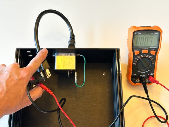

  26. With your DMM set to resistance / continuity.  Measure the resistance from your mains earth to the bare metal on each panel.  If it is more than a fraction of an Ohm, STOP!
    • With your DMM set to resistance / continuity. Measure the resistance from your mains earth to the bare metal on each panel. If it is more than a fraction of an Ohm, STOP!
    • Read the previous step again and validate that each panel has less than one Ohm resistance to the mains earth connection.
    • Photo 1 - Note the very low resistance from mains earth to the left side panel as one example. It is critical to ensure a low resistance from mains earth to all panels.

    • Using M3 nuts, mount two standoffs to the rear of of the PCB in the holes closest to center. Using black, 5mm cap screws, mount two standoffs in the front two holes of the bottom panel of the chassis.
    • Slide the PCB onto the bottom panel and the front standoffs. The PCB should slide under the PEM.
    • Slide both 6.3mm female spades from the black and white AC connection wires onto the PEM spades marked L and N. Black is live and white is neutral. The connections should be tight. If they are not, stop and seek assistance.
    • Photo 1 - PCB temporarily mounted in the chassis. Note - The mains earth configuration was altered after this photo was taken.

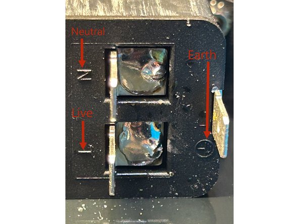

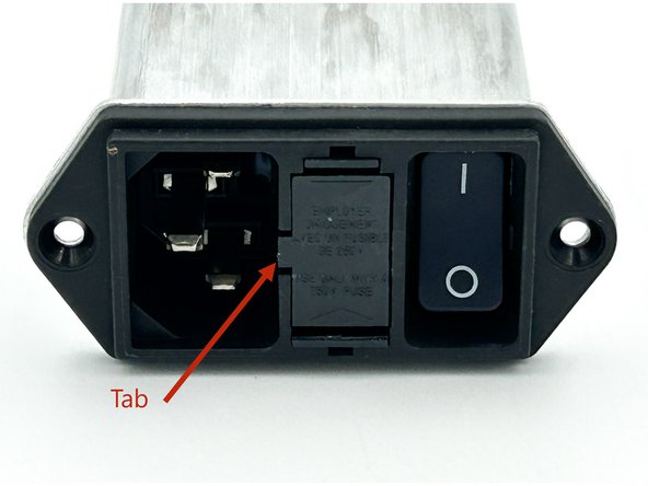

  28. The PEM provided with the kits (Schurter DD12.9111.1111) switches both live and neutral. The fuse drawer provided with the kits fuses the live connection.  Builders are responsible for understanding all applicable regulations that apply to their area.  The fuse provided with the kit is a Schurter 5x20mm, 125mA, slow-blow / time delay.  It will function for both 110/115 and 220/230 VAC.  Builders with 220/230 VAC mains may choose to purchase a 63mA fuse separately if they would like to use the lowest recommended amperage rating.
    • The PEM provided with the kits (Schurter DD12.9111.1111) switches both live and neutral. The fuse drawer provided with the kits fuses the live connection. Builders are responsible for understanding all applicable regulations that apply to their area.

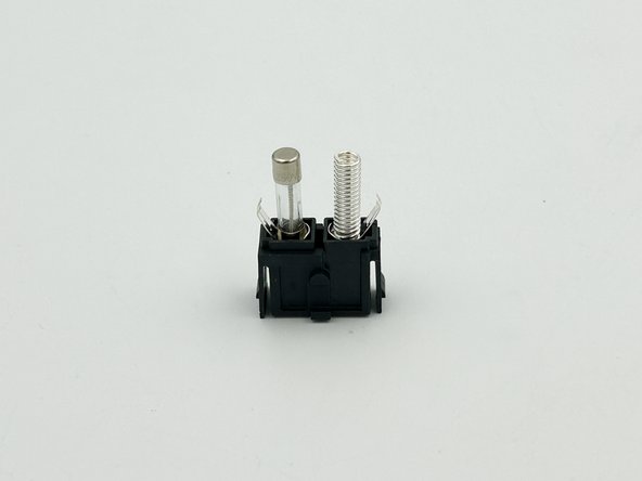

    • The fuse provided with the kit is a Schurter 5x20mm, 125mA, slow-blow / time delay. It will function for both 110/115 and 220/230 VAC. Builders with 220/230 VAC mains may choose to purchase a 63mA fuse separately if they would like to use the lowest recommended amperage rating.
    • Place the cartridge fuse into the fuse drawer as shown in photo 1.
    • Install the fuse drawer and fuse into the PEM. The tab indicates the direction. Do not force it. Just slide it in until it clicks. Note - PEM is not installed in the chassis for ease of demonstration.
    • Photo 1 - Fuse and Fuse Drawer
    • Photo 2 - Proper Installation of Fuse Drawer. Note the position of the notch.

  29. Check the PCB.  Both LEDs should be lit.
    • Check the PCB. Both LEDs should be lit.
    • If both LEDs are not lit, STOP! Troubleshoot as required. Seek assistance if necessary. Do not proceed.
    • It is critical over the next two steps that you do not touch the tips of your DMM probes together while they are in contact with the PCB. It is highly recommended to use two hands. Do not use the technique shown in the photos. A slipped probe is no fun!
    • With a DMM set for DCV, carefully place the black probe of your DMM on the circular pad for C9. Carefully place the red probe on the square pad for C9. You should read approximately +17VDC. The polarity is important.
    • Photo 1 - Notice the probe positions. Acceptable voltage at +16.86VDC

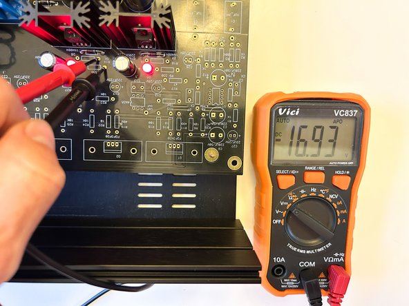

  30. With a DMM set for DCV, carefully place the black probe on the pad for R13 closest to C10.  Carefully place the red probe on the pad for R14 closest to C10.  It should read approximately -17VDC.  The polarity is important.
    • With a DMM set for DCV, carefully place the black probe on the pad for R13 closest to C10. Carefully place the red probe on the pad for R14 closest to C10. It should read approximately -17VDC. The polarity is important.
    • Photo 1 - Photo 1 - Notice the probe positions. Acceptable voltage at -16.93VDC
    • If for any reason you did not get correct voltage readings, STOP! Troubleshoot and/or ask for assistance before proceeding.

  31. Congratulations!  You have now completed the PSU section for your WHAMMY.
    • Congratulations! You have now completed the PSU section for your WHAMMY.
    • Do a little happy dance. We insist.
  32. If you have not already, print the schematic for the audio circuit. .pdf files are included in the documents section of the guide. Image 1 - PSU schematic.  There are still parts in the PSU circuit to install.
    • If you have not already, print the schematic for the audio circuit. .pdf files are included in the documents section of the guide.
    • Image 1 - PSU schematic. There are still parts in the PSU circuit to install.
    • Image 2 - Audio schematic. Note, for a standard build using the OpAmp provided, C2 and C7 are not necessary.
    • For those that choose to experiment with different OpAmps, it is wise to determine appropriate values for C2 and C7. Other modifications to the circuit may also be necessary. Proceed with knowledge and caution. It is strongly recommended to build the circuit as designed before doing any modifications
  33. Remember to measure the resistance for every part before installation and follow the validation / installation / inspection process. It is helpful to use a lead forming tool.  The pitch for the small resistors is 1/2"(13mm). Photo 1 - The code for Dale resistors uses a 3-digit + multiplier at values greater than 100ohm.  Below 100ohm, the "R" is the decimal. From top to bottom are 10K (100+2 zeros, 10000ohm) 1K (100+1 zero, 1000ohm) 100 ohm (100+0 zeros, 100ohm) 10.0 ohm (10R0, 10.0 ohm).  Do not only use the code. Validate with your DMM.  Photo Credit - 6L6
    • It is helpful to use a lead forming tool. The pitch for the small resistors is 1/2"(13mm).
    • Photo 1 - The code for Dale resistors uses a 3-digit + multiplier at values greater than 100ohm. Below 100ohm, the "R" is the decimal. From top to bottom are 10K (100+2 zeros, 10000ohm) 1K (100+1 zero, 1000ohm) 100 ohm (100+0 zeros, 100ohm) 10.0 ohm (10R0, 10.0 ohm). Do not only use the code. Validate with your DMM. Photo Credit - 6L6
    • Photo 2 - Using a lead forming tool, ensure that the resistor code is facing upward on the board when the part is installed. If you should ever need help troubleshooting, it will be EXTREMELY helpful. Photo Credit - 6L6
    • Install all remaining resistors on the PCB. Note - You should have two remaining 47R resistors for the pre-amp input wires. Don't misplace them.
    • Photo 3 - Your board should look something like this.

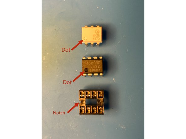

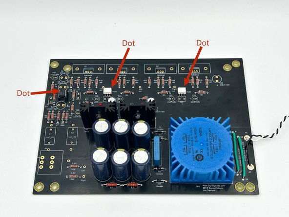

  34. Make sure to properly orient the Optocouplers, OpAmp Socket, and OpAmp.  Pin one is designated with a dot on the package of both the optocoupler and the opamp.  The notch on the OpAmp socket should align with the notch designated on the PCB silkscreen.  The OpAmp and the Optocouplers should be installed with the dot closest to the notch. Install the OpAmp socket ensuring that the notch on the socket matches the silkscreen.
    • Make sure to properly orient the Optocouplers, OpAmp Socket, and OpAmp. Pin one is designated with a dot on the package of both the optocoupler and the opamp. The notch on the OpAmp socket should align with the notch designated on the PCB silkscreen. The OpAmp and the Optocouplers should be installed with the dot closest to the notch.
    • Install the OpAmp socket ensuring that the notch on the socket matches the silkscreen.
    • Gently install (do not solder) the OpAmp, U1, into the OpAmp socket. Be gentle with the OpAmp pins.
    • Install both optocouplers, U4 and U5. Ensure the dot is closest to the notch marking on the silkscreen.
    • Photo 1 - Optocoupler (top), OpAmp (middle), and OpAmp Socket (bottom) all in the same orientation with the dots matching the notch.
    • Photo 2 - OpAmp Socket, OpAmp, and both optocouplers installed. Note the orientation.

    • Install C12, C17, C22, C25, C26, C27.
    • Install C13 and C23
    • Install C1 and C5
    • Install C3 and C4. Optionally, these may be installed on the bottom of the PCB to make room for larger op-amps.
    • Observant DIYers may have noticed the silkscreen and schematic note 50V caps. 25V is perfect for a standard build.
    • Install C9 and C28.
    • Photo 1 - All caps installed.
  36. Install the volume pot.  Ensure that it is sitting flush with the PCB.
    • Install the volume pot. Ensure that it is sitting flush with the PCB.
    • Remove the washer and nut from the volume pot and save them for later.
    • Photo 1 - Volume pot installed.

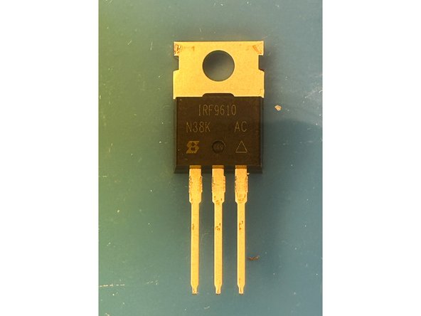

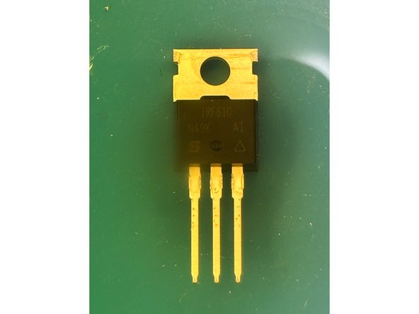

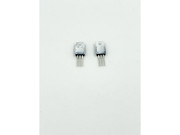

  37. It is critical to identify and separate the output MOSFETs. The 610 are the N-Channel MOSFETs.  They will be installed in the Q1 and Q3 locations.  Note - The boards are marked with FQP3N30.  These were the MOSFETs included in the original kits.
    • It is critical to identify and separate the output MOSFETs.
    • The 610 are the N-Channel MOSFETs. They will be installed in the Q1 and Q3 locations. Note - The boards are marked with FQP3N30. These were the MOSFETs included in the original kits.
    • The 9610 are the P-Channel MOSFETs. They will be installed in the Q2 amd Q4 locations. Note - The boards are marked with FQP3P20. These were the MOSFETs included in the original kits.
    • Photo 1 - 610 MOSFET. Apologies for the poor quality. View the photo in full screen.
    • Photo 2 - 9610 MOSFET. Apologies for the poor quality. View the photo in full screen.
    • Identify and separate your MOSFETs. Mark them with a gel pen or use whatever your favorite method may be to keep them easily identified and separated.

    • Photo 1 - MOSFETs installed.

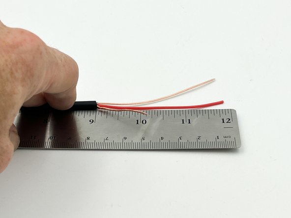

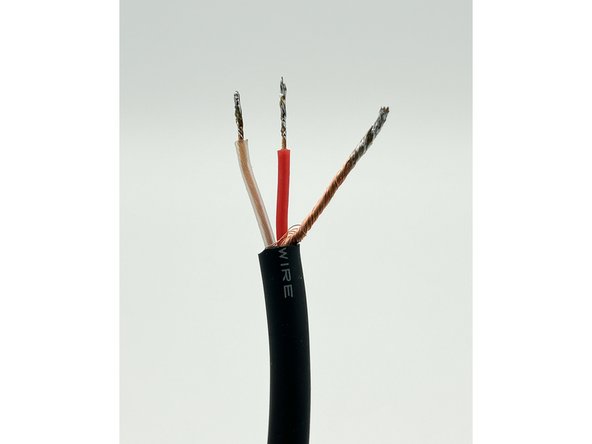

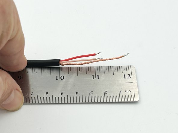

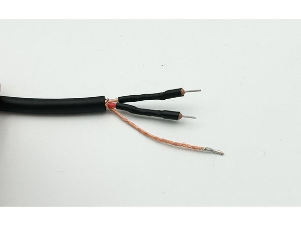

  39. Cut the Mogami signal wire into 3 pieces.  There is a little extra wire, but not much.  Measure twice, cut once.  Label the wires.  It is easy to mix them up before soldering.
    • Cut the Mogami signal wire into 3 pieces. There is a little extra wire, but not much. Measure twice, cut once. Label the wires. It is easy to mix them up before soldering.
    • Approximately 14" (35.5cm) for the pre-amp output wiring
    • Approximately 12" (30.5cm) for the input wiring
    • Approximately 10" (25.5cm) for the headphone output wiring

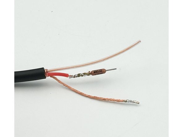

    • For the 10" and 14" cuts - Strip the outer insulation approximately 3/4" (2cm) and the insulation of the red / clear wires approximately 1/8" (3mm). Exact length is not critical.
    • Twist the bare copper shield wire tightly, and tin the ends of all wires.
    • Photo 1 - Wire prepped for installation.

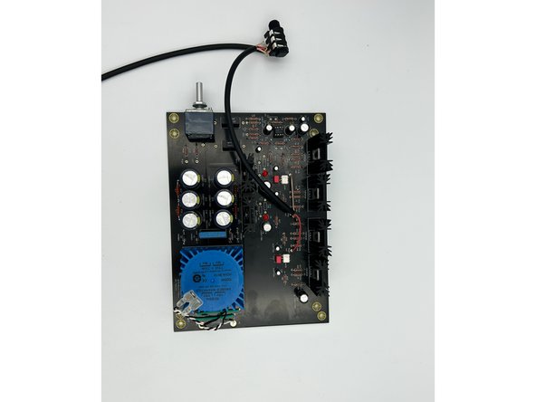

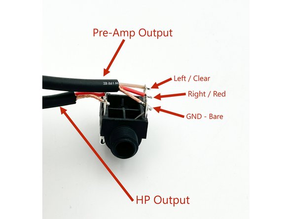

  40. The kit includes a switched Headphone Input Jack.  When no headphone jack is inserted, the output is sent to the pre-amp outputs.  When a male 1/4" TRS headphone jack is inserted, the output is sent to the headphone jack.  DO NOT plug in or unplug headphones or connect pre-amp outputs with the WHAMMY powered up.
    • The kit includes a switched Headphone Input Jack. When no headphone jack is inserted, the output is sent to the pre-amp outputs. When a male 1/4" TRS headphone jack is inserted, the output is sent to the headphone jack. DO NOT plug in or unplug headphones or connect pre-amp outputs with the WHAMMY powered up.
    • It is critical to wire the headphone output and pre-amp output appropriately.
    • Solder the 14" pre-amp out and 10" HP out wires to the headphone jack exactly as shown in the photo.
    • Photo 1 - HP Jack with wiring.

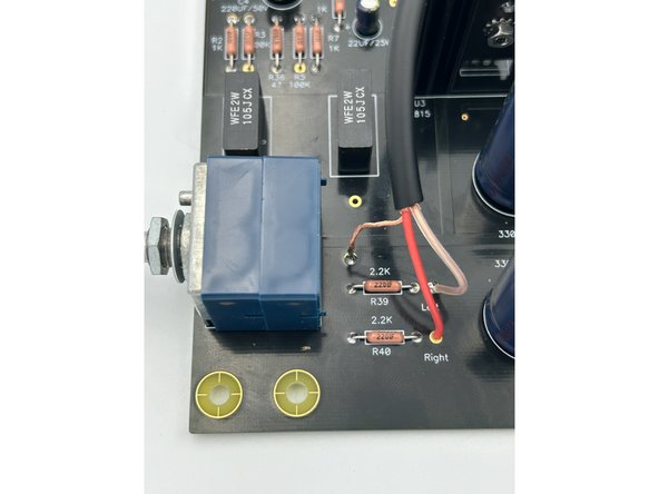

  42. For the 12" cut - Strip the outer insulation approximately 1.5"(4cm) and the insulation of the red / clear wires approximately 1/8"(3mm).  Exact length is not critical. Remove / trim roughly 1/3 of the strands of the exposed bare copper shield wire (it's too large for the PCB).  Twist the bare copper shield wire tightly, and tin the ends of all wires.
    • For the 12" cut - Strip the outer insulation approximately 1.5"(4cm) and the insulation of the red / clear wires approximately 1/8"(3mm). Exact length is not critical.
    • Remove / trim roughly 1/3 of the strands of the exposed bare copper shield wire (it's too large for the PCB). Twist the bare copper shield wire tightly, and tin the ends of all wires.
    • Photo 1 - Input wire tinned and ready to install.
    • Solder the Input wire to the PCB.
    • Red - Right
    • Clear - Left
    • Bare wire - Unlabeled pad next to R39
    • Photo 2 - Input Wiring Installed
  43. Strip approximately 2"(50mm) of the outer insulation from the non-connected end of the pre-amp input wire.  Twist and tin the bare-wire conductor.  Strip the red and clear insulated conductors leaving a few mm of insulation remaining. Wind the red (or clear) conductor around the leg of a 47R resistor keeping the winding close to the body of the resistor.  5 or 6 winds is fine.  The goal is a solid, but short, connection.  Solder the wire to the resistor.  Trim the remaining wire and the remaining resistor lead.  Trim the other end of the resistor leaving about 5mm.
    • Strip approximately 2"(50mm) of the outer insulation from the non-connected end of the pre-amp input wire. Twist and tin the bare-wire conductor. Strip the red and clear insulated conductors leaving a few mm of insulation remaining.
    • Wind the red (or clear) conductor around the leg of a 47R resistor keeping the winding close to the body of the resistor. 5 or 6 winds is fine. The goal is a solid, but short, connection. Solder the wire to the resistor. Trim the remaining wire and the remaining resistor lead. Trim the other end of the resistor leaving about 5mm.
    • Photo 1 - Resistor attached to red-insulated conductor.
    • Attach the other conductor (red or clear) to the remaining 47R resistor similarly.
    • Cut enough heatshrink tubing to cover the the body of the resistors, the soldered joints, and a little bit of the insulation. Use a heat gun or other appropriate method to shrink the tubing into place.
    • Photo 2 - Completed assembly for the pre-amp output wiring.

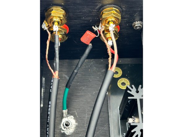

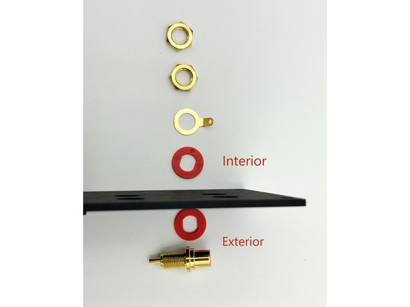

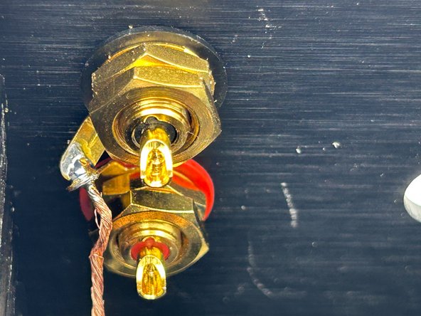

  44. The installation order is critical for the RCA jacks.  The jacks ship with the ground tab between the two insulators.  You must have the ground tab isolated from the chassis. Photo 1 - Correct orientation for RCA jack components.
    • The installation order is critical for the RCA jacks. The jacks ship with the ground tab between the two insulators. You must have the ground tab isolated from the chassis.
    • Photo 1 - Correct orientation for RCA jack components.
    • Install both the left and right pre-amp output RCA jacks. As shown in photo 2.
    • Insert the ground wire through both ground tabs. Slide the ground tab onto the lower (red) jack. Loosely install the first nut on the red jack. Slide the ground tab onto the upper jack (black) and install the first nut. Fully tighten the nuts ensuring that the solder cups for the jacks are oriented upward. Install and tighten the top nuts.
    • Solder the ground wire to both tabs.
    • Photo 2 - Pre-amp output jacks installed and ground wire connected to both jacks.

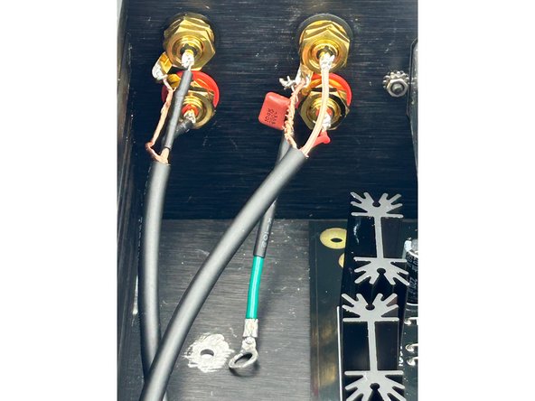

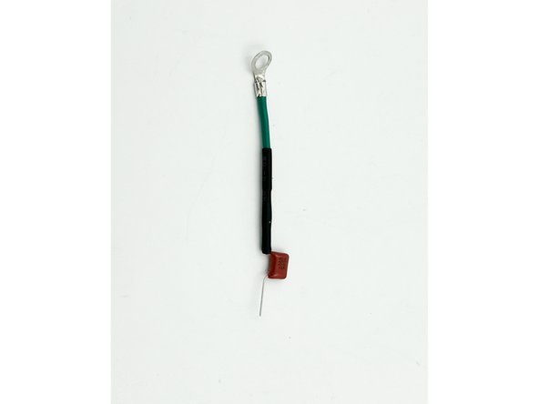

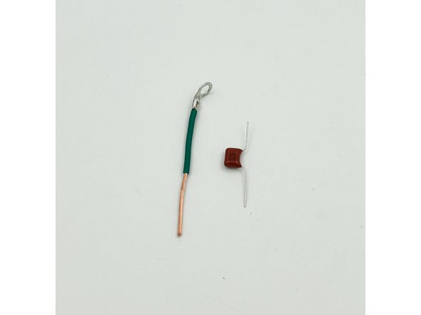

  46. Cut approximately 3"(8cm) of the green wire.  Install a ring connector to one end using the same process as the mains earth connection.  Strip a little over an inch of the insulation from the remaining end of the green wire. Bend the legs of the 0.1uF film cap as shown in photo 1. Slide a piece of heatshrink tubing over the green wire.  Gently wrap one leg of the capacitor around the wire keeping the cap in-line with the wire.  Solder the cap to the wire.  Trim the cap leg and any excess wire.  Shrink the tubing in place covering the joint.
    • Cut approximately 3"(8cm) of the green wire. Install a ring connector to one end using the same process as the mains earth connection. Strip a little over an inch of the insulation from the remaining end of the green wire. Bend the legs of the 0.1uF film cap as shown in photo 1.
    • Slide a piece of heatshrink tubing over the green wire. Gently wrap one leg of the capacitor around the wire keeping the cap in-line with the wire. Solder the cap to the wire. Trim the cap leg and any excess wire. Shrink the tubing in place covering the joint.
    • Photo 1 - Complete ground wire and cap assembly.
    • The cap allows any RF present on the input to go to GND. This improves performance and may prevent oscillation with some OpAmps.

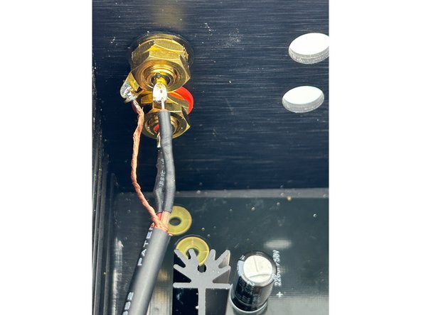

  47. Strip off approximately 2"(5cm) of the outer insulation from the input wire.  Cut off approximately 1"(2.5cm) of the red and clear insulated conductors.  Strip approximately 1/8"(3mm) from the red and clear insulation.  Twist and tin all wires. Photo 1 - Input wire prepped for soldering Install the RCA jacks and ground wire using the same method used for the pre-amp output wiring.  Slide the capacitor lead through one of the ground tabs and solder the assembly in place.
    • Strip off approximately 2"(5cm) of the outer insulation from the input wire. Cut off approximately 1"(2.5cm) of the red and clear insulated conductors. Strip approximately 1/8"(3mm) from the red and clear insulation. Twist and tin all wires.
    • Photo 1 - Input wire prepped for soldering
    • Install the RCA jacks and ground wire using the same method used for the pre-amp output wiring. Slide the capacitor lead through one of the ground tabs and solder the assembly in place.
    • Solder the red and clear insulated input wiring to the red and black input jacks respectively.
    • Photo 2 - Input wiring installed.

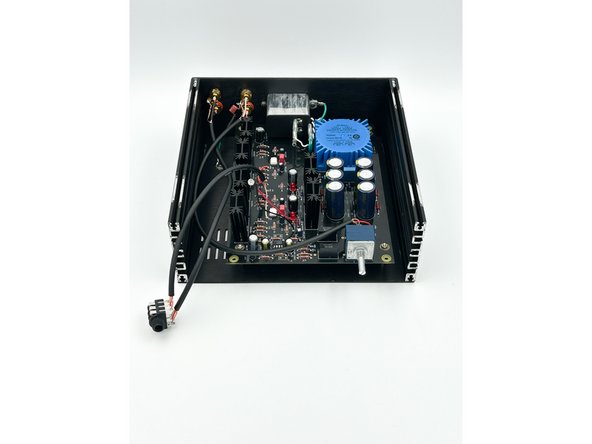

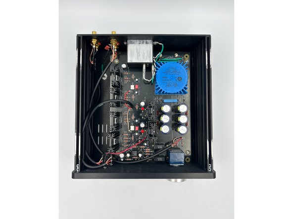

    • Securely connect the ground lug to the chassis using the black M3 x 8mm cap head screw and a keps nut.
    • Photo 3 - All back panel wiring complete.
  48. Trim approximately 1"(25mm) from the LED leads.  Strip and re-tin the wires. Install the LED wires on the pads for R9 and R10 as shown in photo 1.  The polarity is critical.  Check with a DMM prior to installation if you are unsure.
    • Trim approximately 1"(25mm) from the LED leads. Strip and re-tin the wires.
    • Install the LED wires on the pads for R9 and R10 as shown in photo 1. The polarity is critical. Check with a DMM prior to installation if you are unsure.
    • Photo 1 - LED wiring location.

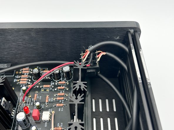

    • If you removed the standoffs from the chassis in step 44, reinstall the standoffs and secure the PCB to the standoffs using the M3 nuts.
    • Slide the mains wiring over the appropriate slots on the PEM and ensure that the the insulating boots completely cover the slots on the PEM and that the connection is secure.
    • Those that appreciate additional coverage and/or if it is required by local code may choose to add liquid electrical tape or other means to ensure no unintentional contact with mains voltage if the unit is being serviced.
    • Photo 2 - Congratulations! All the wiring is complete.
  49. Ensure that you have the M3 nuts inserted into the side rails for attaching the top panel. Using the black M4 cap-head screws included with your chassis, install the front panel.  The front panel should fit perfectly over the volume pot. Slide the headphone jack and the LED into place.
    • Ensure that you have the M3 nuts inserted into the side rails for attaching the top panel.
    • Using the black M4 cap-head screws included with your chassis, install the front panel. The front panel should fit perfectly over the volume pot.
    • Slide the headphone jack and the LED into place.
    • Photo 1 - HP Jack and LED in place.
    • Install the black washer and red (or black) nut onto the headphone jack. Install the washer and nut onto the volume pot. Install the volume knob, and route wiring as necessary.
    • Photo 2 - HP Jack Secured and Volume knob installed.
    • Photo 3 - Ready for testing.
  50. Listen to a few of your favorite songs and conduct any objective / subjective testing before installing the top panel.  Rumor has it, that it's bad luck to install the top panel before listening to a few songs. If it's not performing to expectations, pause and troubleshoot.
    • Listen to a few of your favorite songs and conduct any objective / subjective testing before installing the top panel. Rumor has it, that it's bad luck to install the top panel before listening to a few songs.
    • If it's not performing to expectations, pause and troubleshoot.
    • Ask questions and post your build photos in the WHAMMY thread on diyAudio.com
    • Install the large adhesive feet. These provide a little more clearance and are more stable than the feet included with the chassis. Be cautious. They cannot be moved (easily) after they are pressed into place.
    • Photo 1 - Feet installed. It is builder's choice for placement. It was easiest to install them on the 4 corners for alignment in this builder's opinion.
    • Install the top panel.
    • Photo 2 - Congratulations on completing your WHAMMY!
