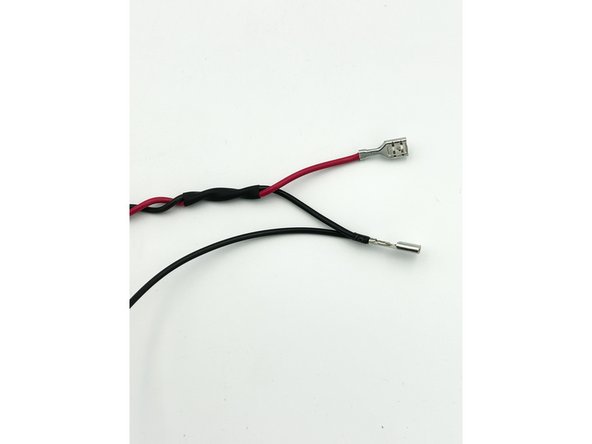

    • The builder must ensure all terminations are done properly for safe and trouble-free operation.
    • It is often discussed whether to solder and/or crimp or whether spade-type connections are worthy of a "good" build. In the author's opinion, a properly-crimped connection using high quality terminations and a proper crimper is an excellent choice. Adding a bit of solder can't hurt, but it will never "fix" an improper crimp.
    • The advantage is that many crimped terminations allow flexibility.
    • The disadvantage is that a proper crimp is only achievable when using a proper tool, and many people don't have a proper crimper for each type of termination.
    • The video linked does an excellent job of demonstrating various crimps. You are strongly encouraged to watch it. Excellent Crimping Video. Note - Neither the author nor DIYAudio have any affiliation with the video's creator.

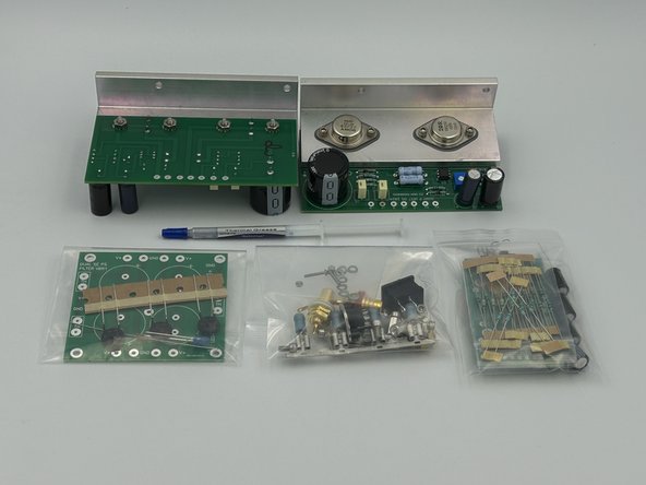

  4. Check to ensure you have all the primary bags / components / assemblies.  Do not open the bags at this time. Photo 1 - Contents of main box (1) - Note: your contents won't be identical.  Some updates were made after prototyping / before shipping. Photo 2 - Contents of main box (2) - Note: your contents won't be identical.  Some updates were made after prototyping / before shipping.
    • Check to ensure you have all the primary bags / components / assemblies. Do not open the bags at this time.

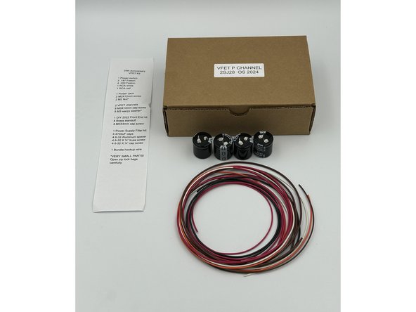

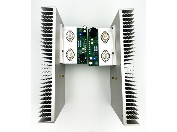

    • Photo 1 - Contents of main box (1) - Note: your contents won't be identical. Some updates were made after prototyping / before shipping.
    • Photo 2 - Contents of main box (2) - Note: your contents won't be identical. Some updates were made after prototyping / before shipping.
    • Photo 3 - Contents of Interior Box - Note: your contents won't be identical. Some updates were made after prototyping / before shipping.
    • Note - How cool is it that Nelson initialed the output stage boards?!
    • The output stage boards come fully assembled, tested, and adjusted to the "sweet spot" by Nelson Pass himself. Only the bravest (or perhaps most foolish) DIYers will touch P1. If you are among the brave, but intelligent, please wait.

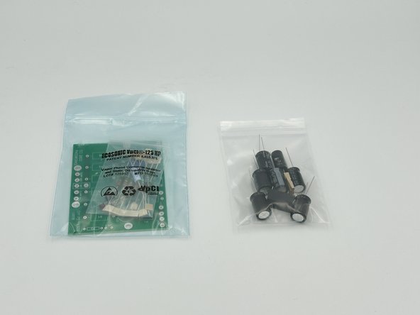

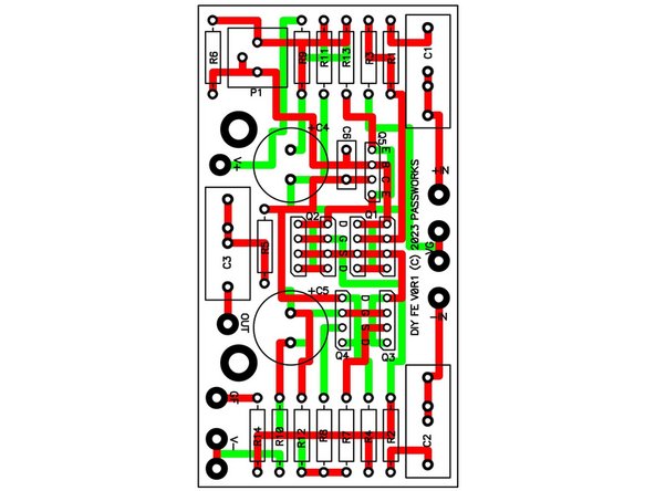

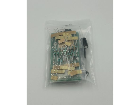

  5. Carefully remove the contents of the bag containing all the parts for your Front End into a bowl or onto a clean work surface. Photo 1 - FE 2022 Parts Bag
    • Carefully remove the contents of the bag containing all the parts for your Front End into a bowl or onto a clean work surface.
    • Photo 1 - FE 2022 Parts Bag

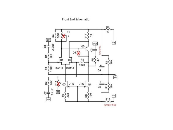

    • For a better understanding of this versatile circuit, read and/or print the FE2022 documents from the documents section of the guide and review the schematic and board layout. There are some important things to note during assembly that may not be intuitive to all builders.
    • C6, P1, and R14 are not installed.
    • Jumpers are required in the place of C3 and R10.

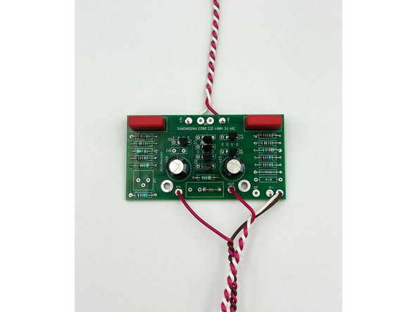

    • Photo 3 - FE2022 V0R1 Board Layout

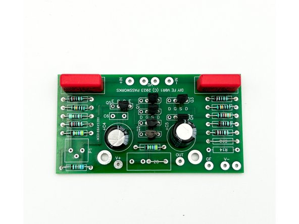

  6. Assemble the FE2022 boards.  A good assembly order might be: Resistors and jumpers.  Use spare resistor leads to jumper R10 and C3.
    • Assemble the FE2022 boards. A good assembly order might be:
    • Resistors and jumpers. Use spare resistor leads to jumper R10 and C3.

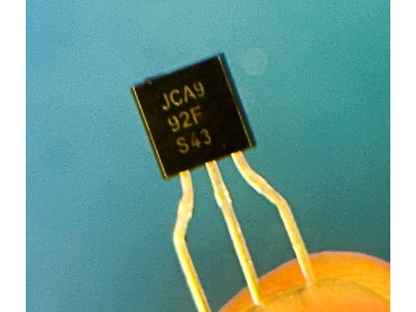

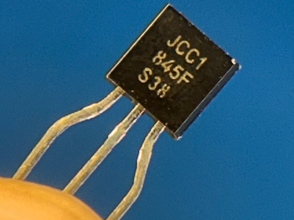

    • Transistors. Take specific note that the boards are cleverly designed to allow multiple pin orientations for various transistors.
    • Confirm for the pin-out of the transistors using your handy tester. The J113 are D,S,G (Pins 1,2,3). The KSA992 is E,C,B (Pins 1,2,3).
    • Make sure you install the parts using the proper pads. There are 4 pads for 3 legs. One is left empty. If you're unsure, test the parts ... or just copy the photo exactly.
    • Film capacitors and Electrolytic capacitors - Ensure proper orientation for the electrolytic capacitors. The silkscreen notes the (+) terminal.
    • Photo 1 - The front of your board should look a lot like this. Pay attention to the placement and orientation of the transistors. Note - The flux was promptly cleaned from the In+ and V- pads after the photo. ;)
    • Image 1 - Front End Schematic

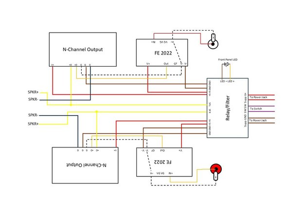

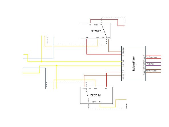

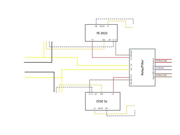

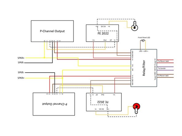

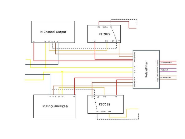

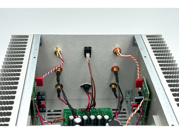

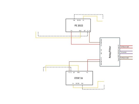

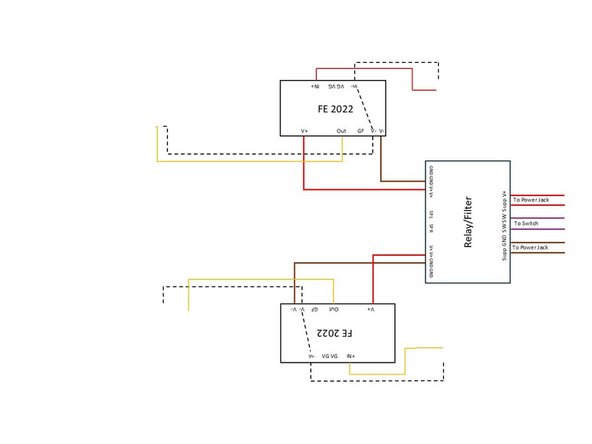

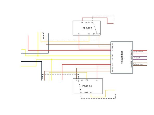

  7. Wiring the amplifier is likely to be the most challenging part of the build.  The sequence of steps shown resulted in success with no challenges to assembly.  Feel free to improvise. You likely will not have enough "thick" wire included in the kit to complete your build. In addition, the "thick" black and red (while perfectly suitable) may not be builders' ideal choices.  You're encouraged to use your favorite wire at any point and for any reason in your build.
    • Wiring the amplifier is likely to be the most challenging part of the build. The sequence of steps shown resulted in success with no challenges to assembly. Feel free to improvise.
    • You likely will not have enough "thick" wire included in the kit to complete your build. In addition, the "thick" black and red (while perfectly suitable) may not be builders' ideal choices. You're encouraged to use your favorite wire at any point and for any reason in your build.

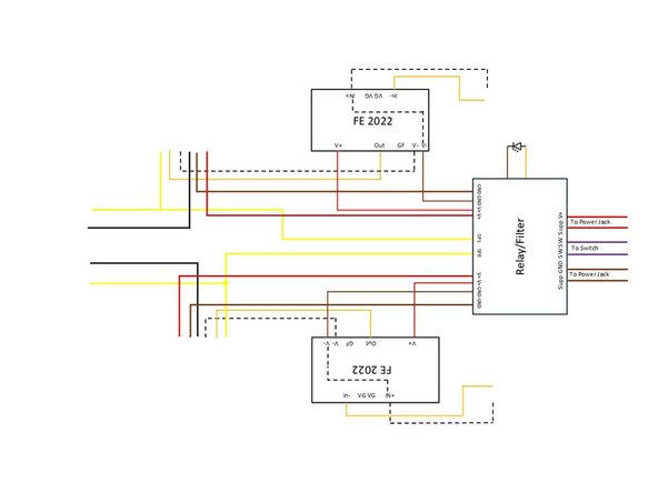

    • Image 1 - P-Channel wiring diagram. Colors are not representative of the build. Use this wiring diagram. The wiring diagram in the article has at least one wiring error.
    • Image 2 - N-Channel wiring diagram. Colors are not representative of the build.
    • It is strongly recommended to print out the appropriate diagram and check off each wire as you build, particularly for newer builders.

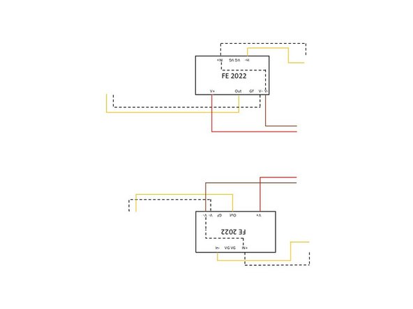

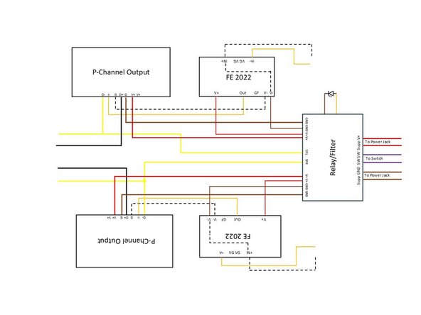

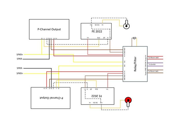

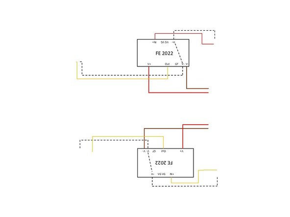

  8. THIS STEP IS FOR P-CHANNEL ONLY
    • THIS STEP IS FOR P-CHANNEL ONLY

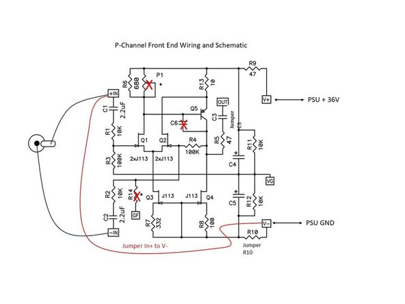

    • This wiring may seem odd at first, but if you've taken a look at the schematics and understand even a fraction of Nelson Pass' genius, there is a cool trick going on with this amplifier. It all starts with inverting the signal from the source to the front end. V- is GND in this circuit.
    • Image 1 - P-Channel Front End Schematic with notations for proper jumpers and input polarity.

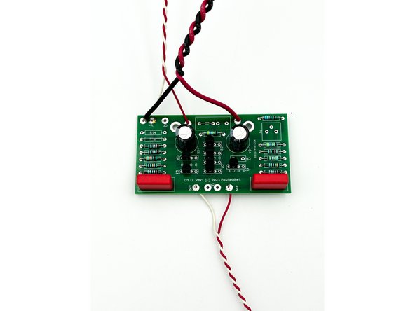

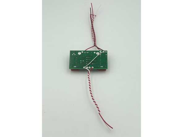

  9. THIS STEP IS FOR P-CHANNEL ONLY This wiring may seem odd at first, but if you've taken a look at the schematics and understand even a fraction of Nelson Pass' genius, there is a cool trick going on with this amplifier.  It all starts with inverting the signal from the source to the front end. 7 Inch lengths of thin wire were used for the input wiring (to the RCA jacks).  9 inch lengths of thin wire were used for the output wiring (to the output stage).  8 inch lengths of wire were used for the power wiring (to the PSU board).

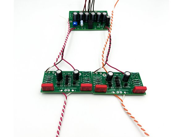

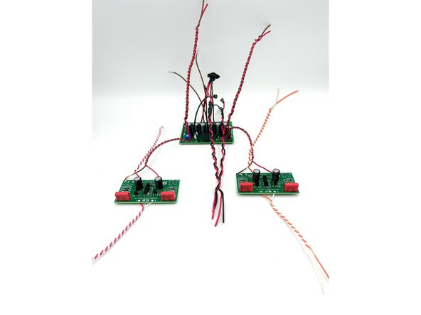

    • 7 Inch lengths of thin wire were used for the input wiring (to the RCA jacks). 9 inch lengths of thin wire were used for the output wiring (to the output stage). 8 inch lengths of wire were used for the power wiring (to the PSU board).
    • A cordless drill is handy for twisting wires, but choose your favorite method.
    • Photo 1 - Front of a board. It was properly cleaned after the photo.
    • Photo 2 - Back of a board. This photo is mainly to demonstrate the jumper from In+ to V-. Feel free to put the jumper on the front of the board if you prefer.
    • Wire your FE Boards as shown. Note - It does not matter which V- pads are shared.

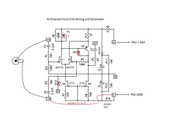

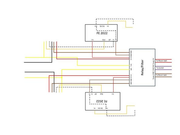

  10. THIS STEP IS FOR N-CHANNEL ONLY
    • THIS STEP IS FOR N-CHANNEL ONLY
    • The wiring is fairly straight forward. V- is GND in this circuit.
    • Image 1 - N-Channel Front End Schematic with notations for proper jumpers and input polarity.

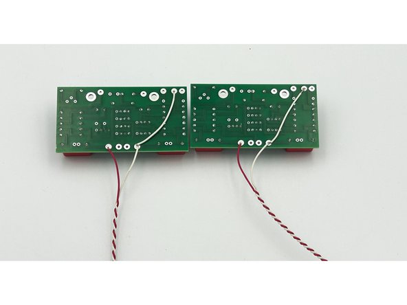

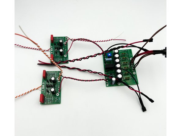

  11. THIS STEP IS FOR N-CHANNEL ONLY! 7 Inch lengths of thin wire were used for the input wiring (to the RCA jacks).  9 inch lengths of thin wire were used for the output wiring (to the output stage).  8 inch lengths of wire were used for the power wiring (to the PSU board). A cordless drill is useful for twisting wires, but choose your favorite method.
    • THIS STEP IS FOR N-CHANNEL ONLY!
    • A cordless drill is useful for twisting wires, but choose your favorite method.
    • Photo 2 - Back of 2 boards. Note, this photo was taken before the output signal and DC supply wiring was added. It's mainly to demonstrate the jumper. Feel free to put the jumper on the front if that makes you more comfortable.
    • Image 1 - Existing Wiring

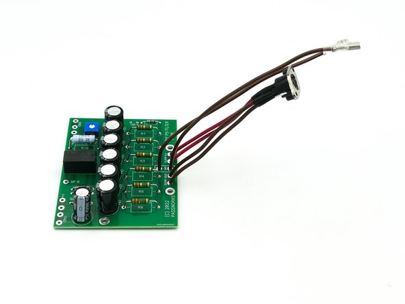

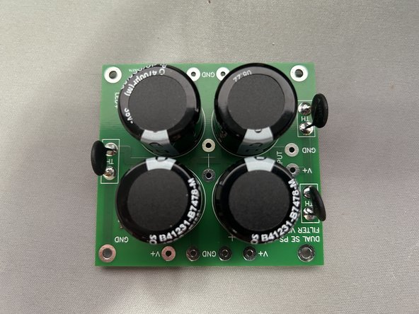

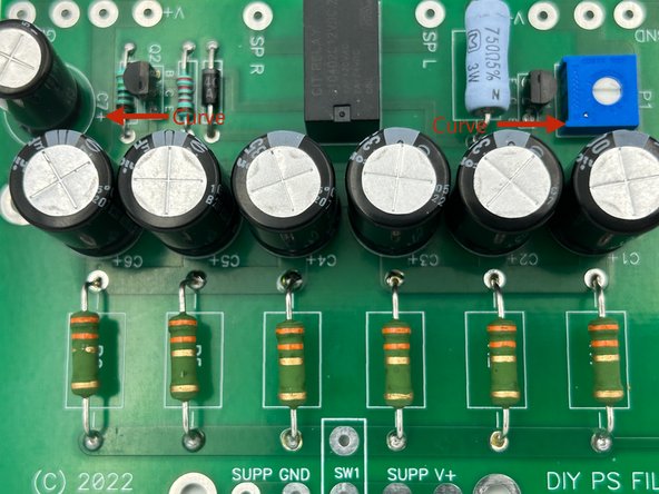

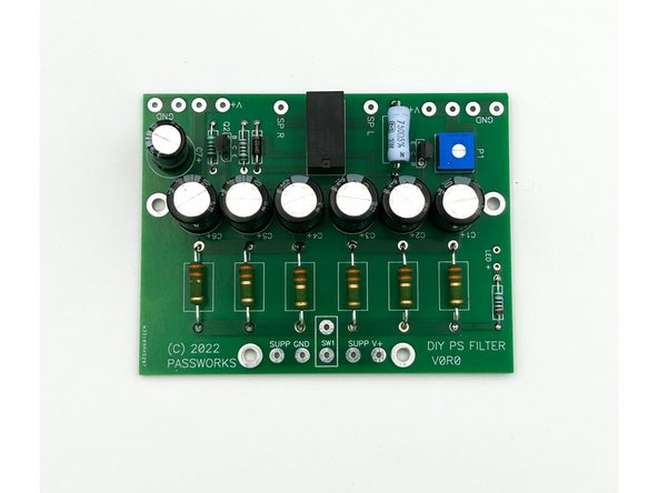

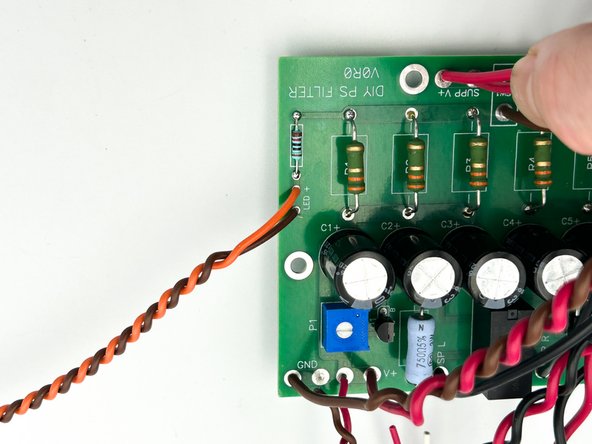

  13. This board has two functions.  Reduce turn on-off thump and filter the PSU.  A control circuit delays the relay turn-on but quickly shorts the output of the source when the supply voltage starts to drop. P1 is used to adjust the sensitivity of the turn-off Photo 1 - These are the parts you need for this step. Make certain you identify and separate the PNP and NPN transistors.  If you install them in the wrong locations, your amplifier will not work.
    • This board has two functions. Reduce turn on-off thump and filter the PSU. A control circuit delays the relay turn-on but quickly shorts the output of the source when the supply voltage starts to drop. P1 is used to adjust the sensitivity of the turn-off
    • Photo 1 - These are the parts you need for this step.
    • Make certain you identify and separate the PNP and NPN transistors. If you install them in the wrong locations, your amplifier will not work.
    • Photo 2 - PNP - Q1 - KSA992 (Apologies for the quality)
    • Photo 3 - NPN - Q2 - KSC1845
  14. Do Not Install the LED Yet Stuff the boards per the schematics.  A good sequence may be:
    • Do Not Install the LED Yet
    • Stuff the boards per the schematics. A good sequence may be:
    • Small Resistors, Diode, and Potentiometer. The pot should be just fine at mid point.
    • Transistors. Again, ensure you have properly identified Q1 and Q2. Orient them properly!
    • Photo 1 - Transistor Orientation
    • Large resistors (raised a few mm off the board) and the Relay
    • Caps
    • Photo 2 - Your board should look a lot like this.

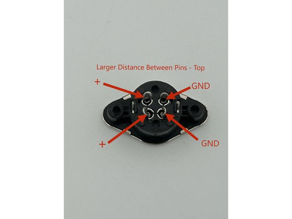

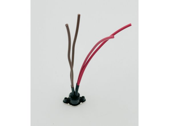

  15. 2 x 4 Inch pieces of thick red wire and 2 x 4 Inch pieces of thick brown wire were used for wiring It is critical that you identify the positive and ground pins of the jack based on how it connects to the PSU.  You can hook it to the PSU and measure, you can check the data sheet of the PSU, and/or you can follow exactly what was done here.
    • 2 x 4 Inch pieces of thick red wire and 2 x 4 Inch pieces of thick brown wire were used for wiring
    • It is critical that you identify the positive and ground pins of the jack based on how it connects to the PSU. You can hook it to the PSU and measure, you can check the data sheet of the PSU, and/or you can follow exactly what was done here.
    • Photo 1 - The proper connection points.
    • Wire the power inlet. Take particular care to not melt the jack. Pre-filling the solder cups and tinning each wire is helpful.
    • Photo 2 - It should look something like this. If you like, add a little shrink tubing to make you feel extra good that the pins won't short and to hide any joints you're not particularly proud of.
    • It is recommended that you connect the PSU, aka the "power brick", to ensure that you have +36V properly at the inlet. Do this carefully, and take care to not short the PSU. Don't touch the red to the brown with the PSU plugged in. The PSU will hold power in the capacitors for quite some time after it has been unplugged.
    • Twist the red wires together. Twist the brown wires together. Ensure the red and brown pairs are separated. Connect "crocodile clips" or equivalent to the red and brown pairs. Red DMM lead to Red and Black DMM lead to Brown. Ensure that there is no continuity (O.L. resistance) between the red and brown pairs. If not, STOP and fix your work.
    • Set your DMM to DCV. Make sure the PSU is not plugged into mains. Plug the PSU into the power inlet. Ensure you have +36V. If not, STOP and fix your work.

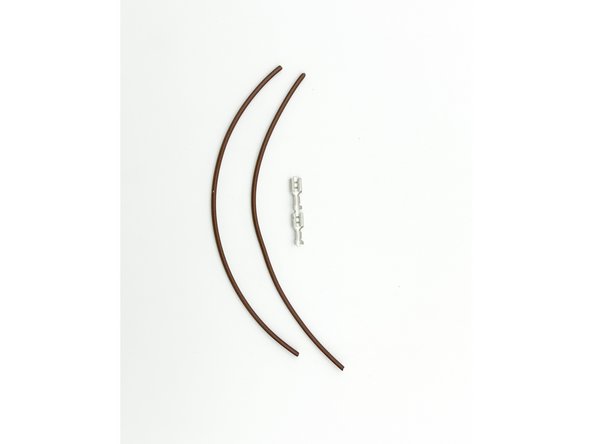

  16. 6" of the thick brown wire was used for the switch wiring. Photo 1 - 2 x 6" lengths of thick brown wire and two small female Faston-type connectors.
    • 6" of the thick brown wire was used for the switch wiring.
    • Photo 1 - 2 x 6" lengths of thick brown wire and two small female Faston-type connectors.
    • Terminate each switch wire and solder them to the Relay Filter Board.
    • Solder the Power Jack Assembly to the Relay / Filter Board.
    • Photo 2 - Your assembly should look something like this. It's nice to use heat-shrink tubing or covers for the female Fastons, but it's not necessary.
  17. Solder the power wiring for the Front End Boards to the Relay/Filter board. Photo 1 - Your Assembly should look a little like this. Image 1 - Existing Wiring - P channel.
    • Solder the power wiring for the Front End Boards to the Relay/Filter board.
    • Photo 1 - Your Assembly should look a little like this.
    • Image 1 - Existing Wiring - P channel.
    • Image 2 - Existing Wiring - N channel

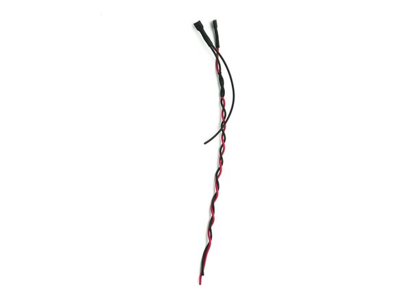

  18. A 6" piece of thick black wire and a 12" twisted pair of black and red wire were used for this assembly. If you have enough wire and/or are using your own wire, you may choose to reverse the colors based on preferences.  Ultimately, the connection from the filter board / non-ground signal wire will connect to the "red" binding post in order to maintain the desired negative 2nd harmonic and maintain phase.
    • A 6" piece of thick black wire and a 12" twisted pair of black and red wire were used for this assembly.
    • If you have enough wire and/or are using your own wire, you may choose to reverse the colors based on preferences. Ultimately, the connection from the filter board / non-ground signal wire will connect to the "red" binding post in order to maintain the desired negative 2nd harmonic and maintain phase.
    • The 6" Black wire will connect to the Relay / Filter board. The twisted pair will connect to the output stage boards.
    • Note - The 'blue' crimp female Fast-On Type connectors included in the kit are not suitable for crimping only with the wire gauges included in the kit. It is strongly recommended to replace them with "red" crimp connections. Builders can strip away the blue insulation in order to crimp then solder as an option.
    • Photo 1 - The business end of the wire assembly.
    • Photo 2 - Full Assembly. Heatshrink tubing is very nice to have, but it is not strictly necessary.
    • Build two speaker wire assemblies
  19. Solder the 6" speaker wires to the relay-filter board.  SP L and SP R Photo 1 - We're getting there.  Once again, ignore the colors. Image 1 - Existing Wiring.  P-Channel
    • Solder the 6" speaker wires to the relay-filter board. SP L and SP R
    • Photo 1 - We're getting there. Once again, ignore the colors.
    • Image 1 - Existing Wiring. P-Channel
    • Image 2 - Existing Wiring. N-Channel
  20. Create two 8" twisted pairs of thick wire and solder them to the Relay-Filter Board.  V+ and GND. Image 1 - Existing wiring: P-Channel. Image 2 - Existing Wiring: N-Channel
    • Create two 8" twisted pairs of thick wire and solder them to the Relay-Filter Board. V+ and GND.
    • Image 1 - Existing wiring: P-Channel.
    • Image 2 - Existing Wiring: N-Channel

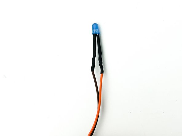

  21. Create a 14" twisted pair of the thin wire. Solder the LED to the wires:  the long lead (+ Anode) and the short lead (- Cathode) Photo 1 - A little heat-shrink tubing or a piece of wire insulation is excellent for ensuring that the leads do not short together and to add a bit of integrity to the assembly.  The test builder still loves blue LEDs.  The red LED in the kit is equally beautiful.
    • Create a 14" twisted pair of the thin wire.
    • Solder the LED to the wires: the long lead (+ Anode) and the short lead (- Cathode)
    • Photo 1 - A little heat-shrink tubing or a piece of wire insulation is excellent for ensuring that the leads do not short together and to add a bit of integrity to the assembly. The test builder still loves blue LEDs. The red LED in the kit is equally beautiful.
    • Solder the LED wires to the Filter-Relay Board. Ensure the polarity is correct. A quick diode check with a DMM is strongly recommended.
    • Photo 2 - Complete
    • Image 3 - Wiring so far. This is the P-Channel, but the LED wiring is exactly the same for the N-channel.

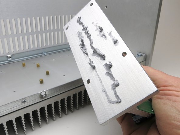

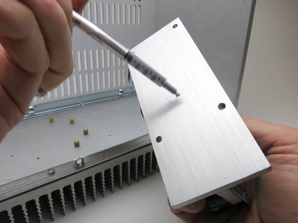

  22. Peel the label from the syringe of thermal paste so you can monitor the volume.  Empty 1/2 contents of the syringe onto each T-bracket. Smear it all over.  Try achieve a smooth even covering over the entire surface.  Some users like to use a straight razor blade or a plastic spreader to even out the material. This interface does not need to be electrically isolated.  The thermal goop is electrically conductive, hence the metallic color.  Be careful that you do not get it on your PCBs or other surfaces.
    • Peel the label from the syringe of thermal paste so you can monitor the volume. Empty 1/2 contents of the syringe onto each T-bracket.
    • Smear it all over. Try achieve a smooth even covering over the entire surface. Some users like to use a straight razor blade or a plastic spreader to even out the material.
    • This interface does not need to be electrically isolated. The thermal goop is electrically conductive, hence the metallic color. Be careful that you do not get it on your PCBs or other surfaces.
    • Photos 1-3 - Application and spreading sequence
    • Note - Photos conveniently borrowed from the 2021 VFET guide. Thank you @6L6!

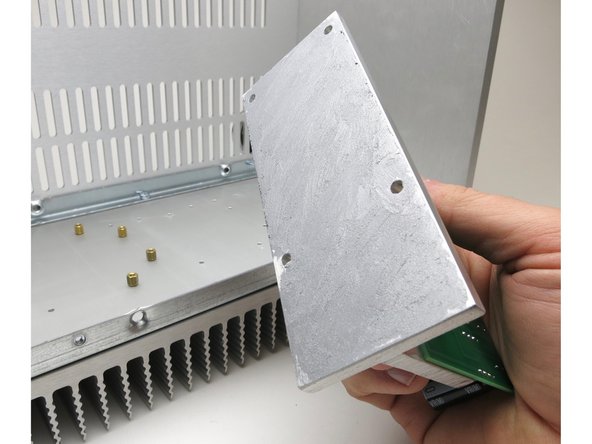

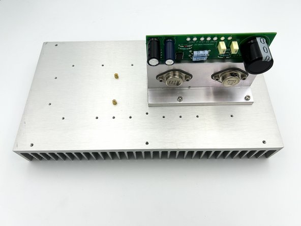

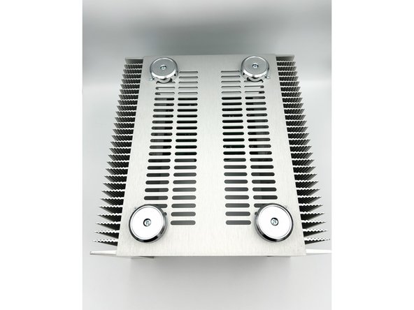

  23. Attach both output stages to the heatsinks as shown using the longer M3 Allen Head Cap Screws and the "curvy" washers. Install two brass standoffs as shown.  Finger tight is perfectly fine.
    • Attach both output stages to the heatsinks as shown using the longer M3 Allen Head Cap Screws and the "curvy" washers.
    • Install two brass standoffs as shown. Finger tight is perfectly fine.
    • Photos 1 and 2 - OS Mounted and standoffs installed.
    • You've now established the top, bottom, front, and back of the heatsinks.

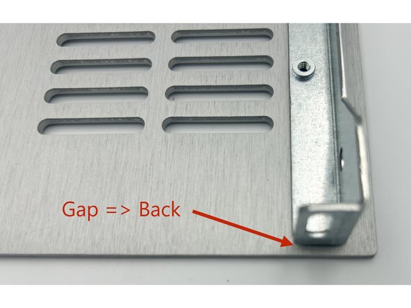

  24. Some photos were lost along the way, but the sequence is fairly simple.  Two sets of brackets are included in the chassis box.  You must ensure that you use the 4 pieces of the 'old' style brackets vs. the 'new' rectangular brackets. Install the chassis rails to both heatsinks using the short M4 button head Phillips screws provided with the chassis. Temporarily install the bottom panel to the heatsinks with one or two screws.  Check to see which end of the panel has a ~3mm overhang past the edge of the heatsinks.  This side MUST go to the back of the chassis.    If it does not.  Turn the panel around.  The back of the chassis is the end away from the output stage.
    • Some photos were lost along the way, but the sequence is fairly simple. Two sets of brackets are included in the chassis box. You must ensure that you use the 4 pieces of the 'old' style brackets vs. the 'new' rectangular brackets.
    • Install the chassis rails to both heatsinks using the short M4 button head Phillips screws provided with the chassis.
    • Temporarily install the bottom panel to the heatsinks with one or two screws. Check to see which end of the panel has a ~3mm overhang past the edge of the heatsinks. This side MUST go to the back of the chassis. If it does not. Turn the panel around. The back of the chassis is the end away from the output stage.
    • Photo 1 - Note the gap between the edge of the chassis rail (thus the heatsink) and the edge of the bottom panel. The gap must go to the back of the chassis.
    • Install the bottom panel to the heatsinks using the longer M3 cap head Allen screws provided with the chassis. Triple check that the gap / overhang is at the BACK of the chassis => on the opposite end of the output stage boards.
    • It is recommended to install the front panel now. You won't see the front panel installed for a few more steps (to make photos easier). Use 4x short M4 button head Phillips screws. The screws are the same type used for mounting the chassis rails.

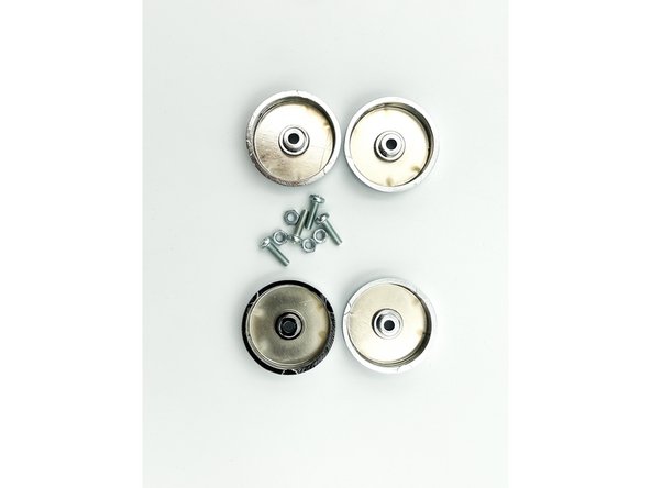

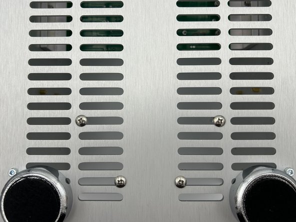

    • Install the feet to the bottom panel. using the longer M4 button head Phillips screws and nuts provided with the chassis.
    • Photos 2 and 3 - Final framework with feet.

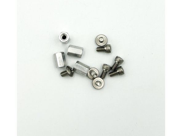

  25. Parts Needed - 4 imperial button head screws, 4 standoffs, and 4 imperial (7/64" Allen head) cap head screws.  These are in the VFET kit. Loosely mount the standoffs to the bottom panel as shown in photo 1.
    • Parts Needed - 4 imperial button head screws, 4 standoffs, and 4 imperial (7/64" Allen head) cap head screws. These are in the VFET kit.
    • Loosely mount the standoffs to the bottom panel as shown in photo 1.
    • Some builders have found that installing the standoffs to the PCB first and then installing the board / standoff assembly to the bottom panel was easier. Poe-tae-toe : Poe-tah-toe.
    • Photo 1 - Mounting Location

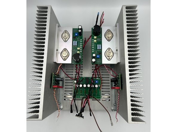

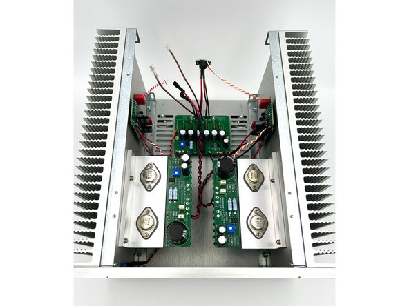

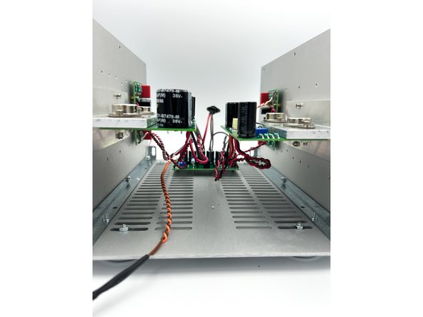

  26. Mount the Filter-Relay board to the standoffs using the imperial allen-head cap screws.  Tighten securely. Mount the FE boards to the standoffs on the heatsinks using the short M3 allen-head cap screws.
    • Mount the Filter-Relay board to the standoffs using the imperial allen-head cap screws. Tighten securely.
    • Mount the FE boards to the standoffs on the heatsinks using the short M3 allen-head cap screws.
    • Photos 1 and 2 - It's starting to look like an amplifier.

    • Image 1 - Sooooo close! Existing Wiring: P-Channel
    • Image 2 - Sooooo close! Existing Wiring: N-Channel

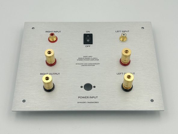

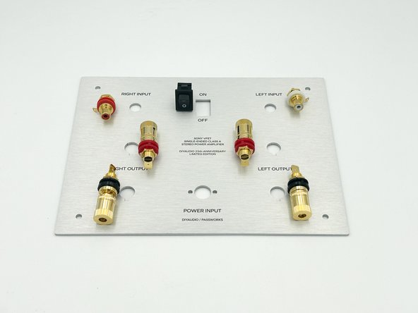

  28. Photo 1 - Back Panel, input jacks, power switch, and binding posts. The RCA jacks in the kits ship with the ground tab between the two plastic washers.  The ground tab should be moved to between the interior plastic washer and the mounting nut, thus isolating it electrically from the chassis.
    • Photo 1 - Back Panel, input jacks, power switch, and binding posts.
    • The RCA jacks in the kits ship with the ground tab between the two plastic washers. The ground tab should be moved to between the interior plastic washer and the mounting nut, thus isolating it electrically from the chassis.
    • The power switch would be terribly hard to remove once installed. It is a very tight press-fit. ENSURE THAT YOU ORIENT THE POWER SWITCH PROPERLY.
    • You may find it easier to solder your input wiring if your orient the solder cups to face the top of the chassis and orient the ground tab toward the top of the chassis.
    • Install the input jacks, binding posts, and power switch onto the back panel.
    • Photo 2 - All components installed.
  29. Install the back panel.  Connect the binding posts.  Connect the switch.  Install the power jack. Ensure that the wire from the filter board and its accompanying wire are connected to the RED binding post.  This will maintain the proper phase relationship that Nelson Pass intends. Solder your Input wires from the FE boards to the RCA jacks.
    • Install the back panel. Connect the binding posts. Connect the switch. Install the power jack.
    • Ensure that the wire from the filter board and its accompanying wire are connected to the RED binding post. This will maintain the proper phase relationship that Nelson Pass intends.
    • Solder your Input wires from the FE boards to the RCA jacks.
    • Photo 1 - All wiring Complete
    • Image 1 - Final Wiring: P channel
    • Image 2 - Final Wiring: N Channel
    • Triple Check Every Wire Using the Provided Wiring Diagram.
    • The OS boards come pre-tuned from Nelson Pass. Unless you are well-versed in distortion measurement, and/or want to try tuning both channels by ear, it is likely best to not turn the pots on the OS boards.
