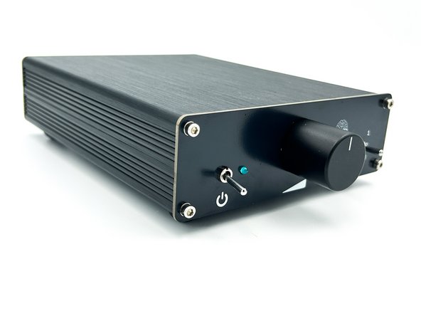

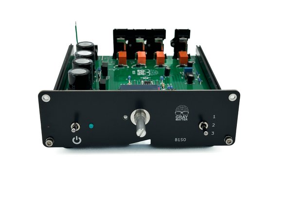

This guide covers the assembly of Gray Matter's B1 Special Operations (B1SO) Pre-Amplifier.

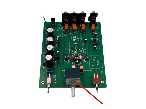

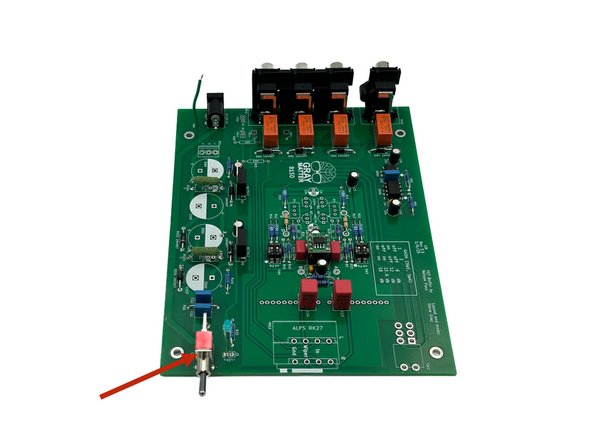

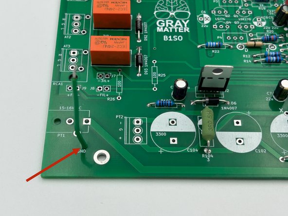

  1. Click on the image to enlarge and read the warnings carefully.
    • Click on the image to enlarge and read the warnings carefully.

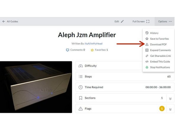

    • Image 2 - Note that you can download this guide as a .pdf and print it. Click the options button in the upper right.

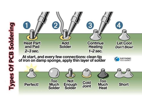

    • Image 1 - A basic soldering sequence and examples of both good and poor joints. Taken from the Rayming PCB & Assembly Guide linked above.
    • The key variables to soldering are the type of solder chosen, the tip used, and the tip temperature. These all vary widely between users and are inter-related. If you are new to electronics, the best solution is practice. Scrap electronics and inexpensive parts are a wonderful way to learn.
    • Leaving the iron tip on the joint for longer than around 5 seconds is not a substitute for too small an iron tip or too low a temperature. If you need to reflow a joint, or if the solder isn't flowing, flux is your friend.

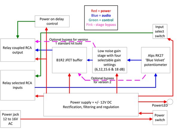

    • The B1SO can be built in three configurations
    • Version 1 - Amplifier with gain. The JFET buffer is omitted and bypassed. This is the version fully demonstrated in this guide. The parts included with kits from diyAudiostore.com are for Version 1.
    • Version 2 - JFET buffer only. The gain stage is omitted and bypassed. See the Addendum in the documents section for instructions
    • Version 3 - Both the amplifier with gain and the JFET buffer. See the Addendum in the documents section for instructions
    • Choose which version you will build and ensure you have the appropriate steps noted.
  4. Image 1 - This is a block diagram of the overall circuit.
    • Image 1 - This is a block diagram of the overall circuit.

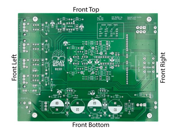

  5. Throughout the guide, the top, bottom, left, right, front, back, or combinations will be referenced.  Here is a quick overview. Look over your boards and get familiar with the parts placement.
    • Throughout the guide, the top, bottom, left, right, front, back, or combinations will be referenced. Here is a quick overview.

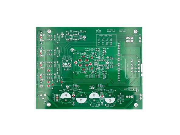

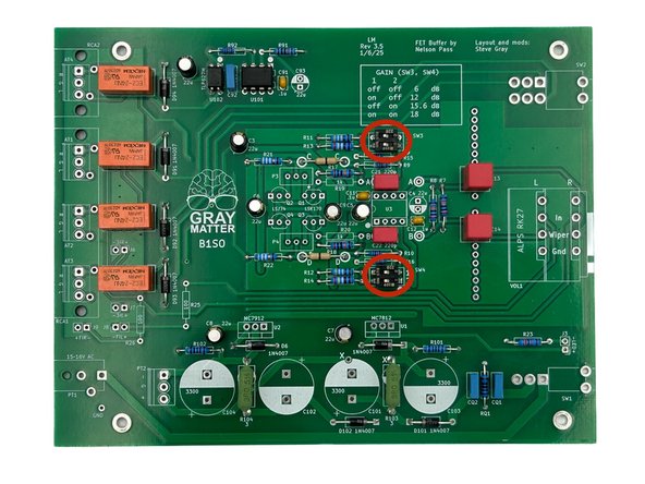

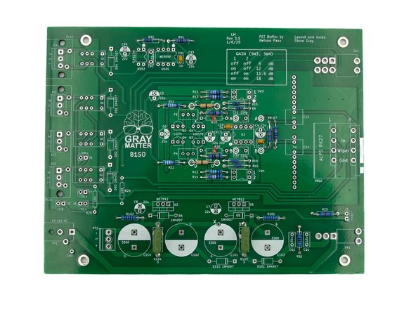

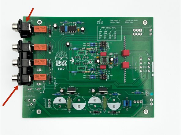

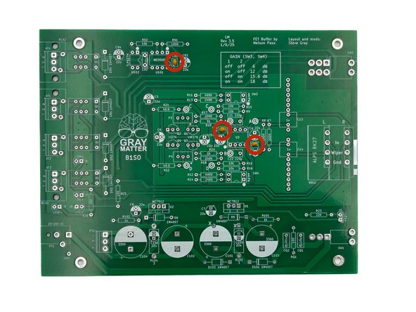

    • Look over your boards and get familiar with the parts placement.
    • Photo 1 - Front view of the PCB.
    • Photo 2 - Not all parts will be stuffed. This guide demonstrates the build of "version 1". Amplifier with gain. The JFET buffer is omitted and bypassed. The AT pads can be used for terminal blocks if you choose to mount the board in a different chassis.
    • The PCB will not be exactly as shown. A very slight revision was made moving the mounting point of the potentiometer. This will not affect your build.

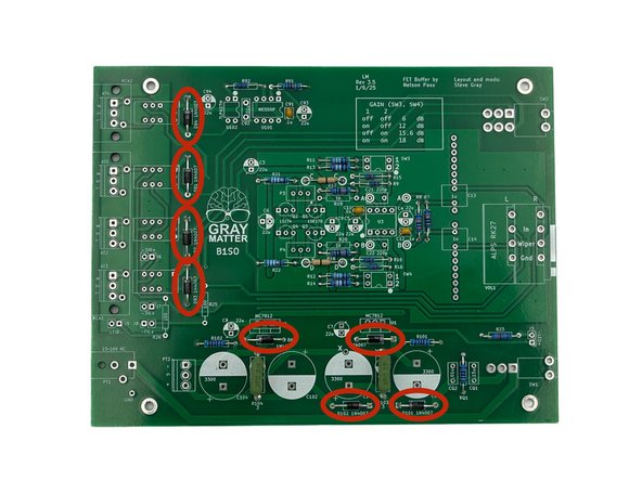

  8. Ensure that you orient the diodes properly!
    • Ensure that you orient the diodes properly!
    • Diode polarity is indicated by the gray band at one end. Ensure that you match the band on the diode to the white band on the PCB silkscreen.
    • Install D5, D6, D91, D92, D93, D94, D101, and D102
    • Photo 1 - PCB with Diodes Installed

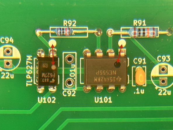

  9. The orientation of U101 and U102 is critical! They are also more challenging to remove and correct if they are installed incorrectly. Please triple check the orientation before soldering.
    • The orientation of U101 and U102 is critical! They are also more challenging to remove and correct if they are installed incorrectly. Please triple check the orientation before soldering.
    • Photo 1 - The dot on the parts indicates pin 1 and should be next to the dot on the silkscreen and the square pad. Do no use the orientation of the lettering to determine the orientation of the part.
    • Install U101 and U102

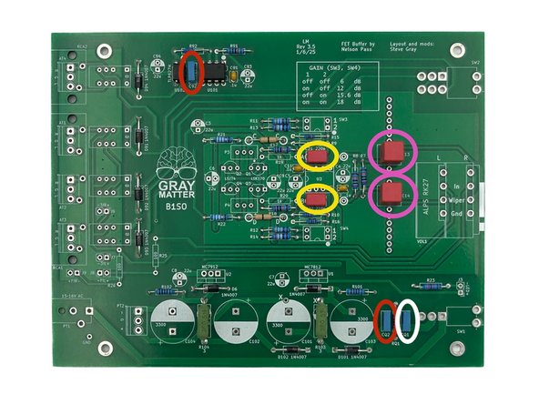

  10. The kit contains 4 different values of film capacitors. They should be easy to separate and install properly. Ensure they are installed in the correct places.
    • The kit contains 4 different values of film capacitors. They should be easy to separate and install properly. Ensure they are installed in the correct places.
    • Install CQ1. Make sure that it is the single 0.15uF capacitor. It looks a lot like CQ2 and C92. Marked in white - photo 1
    • Install CQ2 and C92. Marked in red - photo 1
    • Install C21 and C22. Marked in yellow - photo 1
    • Install C13 and C14. Marked in pink - photo 1
    • Photo 1 - All film caps installed

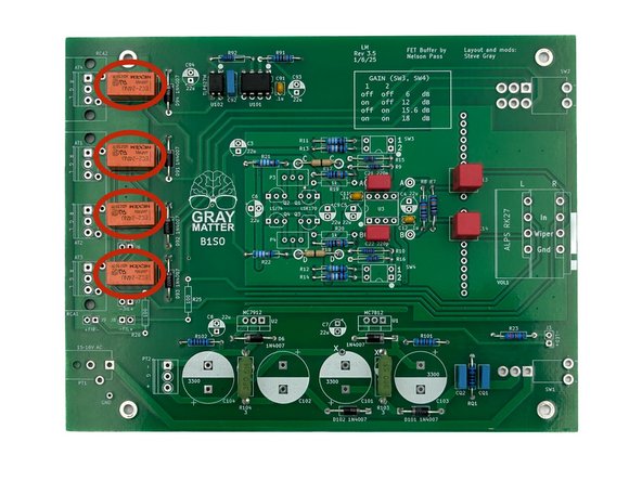

  11. The relays are keyed, so they can only be installed one way. Use a piece of tape if necessary to hold them in place while soldering.
    • The relays are keyed, so they can only be installed one way. Use a piece of tape if necessary to hold them in place while soldering.
    • Install K1, K2, K3, and K201.
    • Photo 1 - Relays Installed

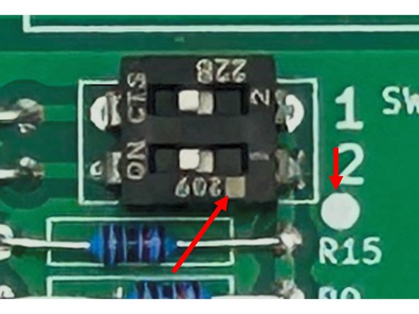

  12. Please be sure to read the instructions carefully to ensure proper orientation of the DIP switches. The DIP switches have a dot to note the orientation / pin one. Ensure that the dot on the switch aligns with the dot on the PCB silkscreen.
    • Please be sure to read the instructions carefully to ensure proper orientation of the DIP switches.
    • The DIP switches have a dot to note the orientation / pin one. Ensure that the dot on the switch aligns with the dot on the PCB silkscreen.
    • Photo 1 - Ensure you match up the dots for both switches. Do not use the number on the switches and silkscreen as a guide. The switch numbers on the board are reversed from the legend on the switches themselves.
    • Install SW3 and SW4
    • Photo 2 - DIP Switches Installed

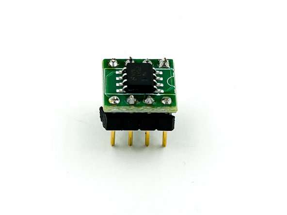

  14. Kits may be provided with the OpAmp (U3) in the SOIC package or in the DIP-8 package. They perform identically. The parts are sourced based upon availability. If your kit has the DIP-8 version, it will look like Photo 1. Skip to Step 24
    • Kits may be provided with the OpAmp (U3) in the SOIC package or in the DIP-8 package. They perform identically. The parts are sourced based upon availability.
    • If your kit has the DIP-8 version, it will look like Photo 1. Skip to Step 24
    • If your kit has the SOIC version, you will have the components in Photo 2. Move on to Step 23.
    • Photo 1 - DIP8 OpAmp
    • Photo 2 - SOIC OpAmp

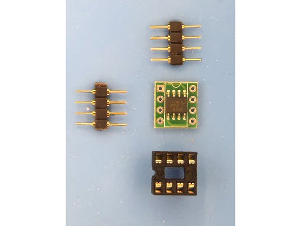

  15. Gather U3 (installed on the small PCB), the two sets of pin headers, and the DIP socket. Photo 1 - U3 on PCB. Pin headers, DIP socket
    • Gather U3 (installed on the small PCB), the two sets of pin headers, and the DIP socket.
    • Photo 1 - U3 on PCB. Pin headers, DIP socket
    • Install the pin headers into the DIP socket and place the PCB over the pins to keep them spaced properly. I prefer the flat side of the pins to sit against the PCB.
    • Solder the PCB to the pin headers at all 8 points. Remove the U3 assembly from the DIP socket.
    • Photo 2 - U3 PCB Installed on Pin Headers.
    • The op-amps chosen for this circuit are excellent. If you choose to roll op-amps, do so at your own risk. For those that have DIP-8 op-amps, and know they will not roll op-amps, you may choose to solder the op-amp directly to the PCB.
    • Solder the DIP-8 socket for U3 to the main PCB or solder U3 directly to the PCB. Align the groove in the socket with the 'groove' noted on the PCB silkscreen.
    • Do Not Install U3 into the socket yet. The DIP-8 OpAmps can be a challenge to remove and re-insert without bending the pins. You'll install it after basic voltage checks.

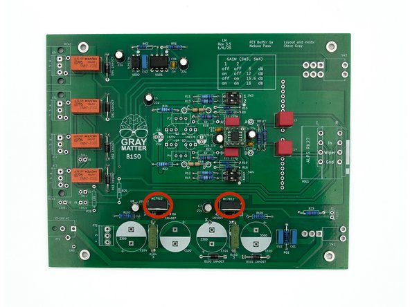

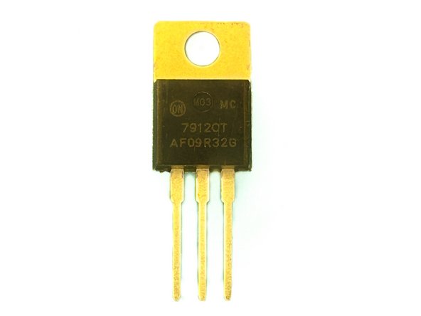

  16. Check the markings on the regulators to be sure the 7912 and 7812 are inserted in their correct locations. The locations are clearly marked on the PCB silkscreen. Photo 1 - MC7912 Photo 2 - MC7812
    • Check the markings on the regulators to be sure the 7912 and 7812 are inserted in their correct locations. The locations are clearly marked on the PCB silkscreen.
    • Photo 1 - MC7912
    • Photo 2 - MC7812
    • The metal side of the regulator aligns with the three rectangles on the silkscreen. The metal side of the regulators will face the big caps.
    • Install U1 and U2.
    • Photo 3 - Regulators Installed
  17. Strip approximately 1/8" (3mm) from each end of the green multistrand wire and tin both ends.
    • Strip approximately 1/8" (3mm) from each end of the green multistrand wire and tin both ends.
    • Solder the wire to the pad marked GND in the bottom left of the PCB.
    • Photo 1 - GND wire installed.
  18. The connectors should snap in.  Be sure they are flush against the PCB before soldering.
    • The connectors should snap in. Be sure they are flush against the PCB before soldering.
    • Install RCA1 and RCA2
    • Photo 1 - RCA Connectors Installed

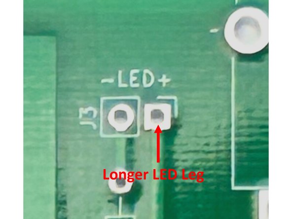

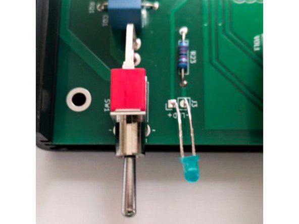

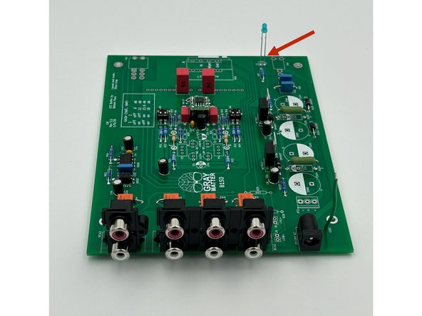

  19. It is important to install the LED in the correct orientation and at the correct length. Please review carefully. Photo 1 - The longer lead is the positive lead. The longer lead is inserted into the square pad marked with a (+).
    • It is important to install the LED in the correct orientation and at the correct length. Please review carefully.
    • Photo 1 - The longer lead is the positive lead. The longer lead is inserted into the square pad marked with a (+).
    • Slide the LED into the holes until the distance between the PCB and the bottom of the LED is about 1" (25mm). Solder the LED into place and trim the leads.
    • The LED leads will be bent later to fit the front panel.
    • Photo 2 - LED Installed.

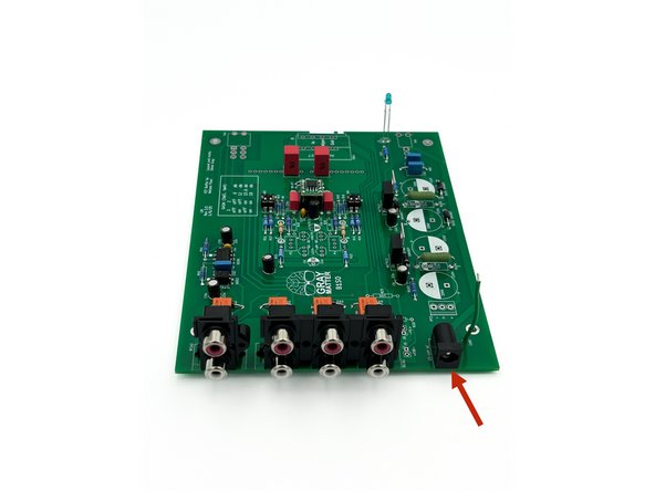

  20. Ensure the 2.1 x 5.5 barrel connection is sitting flush with the PCB prior to soldering.
    • Ensure the 2.1 x 5.5 barrel connection is sitting flush with the PCB prior to soldering.
    • Install PT1
    • Photo 1 - DC Power Jack Installed
  21. Ensure the switch is sitting flush with the PCB and square to the edge of the board. The holes for the switches are slightly larger than needed. Be sure they are held properly in place when soldering
    • Ensure the switch is sitting flush with the PCB and square to the edge of the board. The holes for the switches are slightly larger than needed. Be sure they are held properly in place when soldering
    • Install SW1
    • Photo 1 - Power Switch Installed

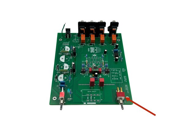

  22. Ensure the switch is sitting flush with the PCB and square to the edge of the board. The holes for the switches are slightly larger than needed. Be sure they are held properly in place when soldering
    • Install SW2
    • Photo 1 - Input selection switch installed

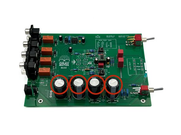

  23. Be careful to observe proper polarity for electrolytic capacitors. The side with the wide stripe is the side with the ‘-‘ lead. The ‘-‘ lead itself is also indicated by its shorter length.
    • Be careful to observe proper polarity for electrolytic capacitors. The side with the wide stripe is the side with the ‘-‘ lead. The ‘-‘ lead itself is also indicated by its shorter length.
    • Install C101, C102, C103, and C104.
    • Photo 1 - Large Caps Installed.
  24. Ensure the pot is sitting flush with the PCB and is aligned squarely with the edge of the PCB before soldering.
    • Ensure the pot is sitting flush with the PCB and is aligned squarely with the edge of the PCB before soldering.
    • A piece of tape and/or holding the pot in place while soldering a single pin to ensure alignment before soldering the remainder of the pins is helpful. If alignment is off, simply reheat the single joint and re-align.
    • Install the Alps Blue Velvet potentiometer in VOL1
    • Photo 1 - Volume Control Installed

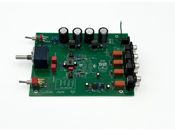

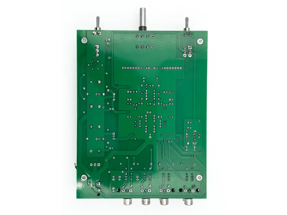

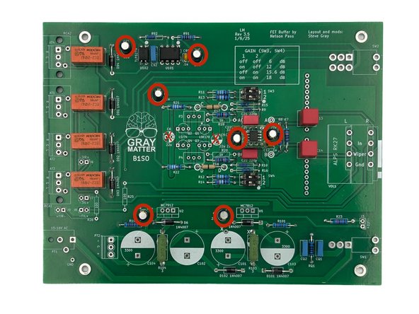

  25. Cleaning the PCB is not strictly necessary unless you are using a solder with a flux or resin specifically noting that it requires cleaning. However, it is strongly advised to clean your PCB if you have not been doing it consistently after soldering each joint. It makes final inspection much easier. Plus, it looks nice. A highly concentrated Isopropyl alcohol is known to work well and has been tested on these PCBs. However, the choice of solvent varies based upon the solder you use. Other chemical flux removers can be more effective with various solders. Consult the spec sheet for your particular solder. If you choose to use a commercial flux remover, check a small portion of the board to ensure it will not lift the solder mask.
    • Cleaning the PCB is not strictly necessary unless you are using a solder with a flux or resin specifically noting that it requires cleaning. However, it is strongly advised to clean your PCB if you have not been doing it consistently after soldering each joint. It makes final inspection much easier. Plus, it looks nice.
    • A highly concentrated Isopropyl alcohol is known to work well and has been tested on these PCBs. However, the choice of solvent varies based upon the solder you use.
    • Other chemical flux removers can be more effective with various solders. Consult the spec sheet for your particular solder. If you choose to use a commercial flux remover, check a small portion of the board to ensure it will not lift the solder mask.
    • Clean the back / solder side of the PCB using your preferred method. You should not need to clean the top of the board. Do not "flood" the board. Do not put it under running water. Many of the parts including the relays, switches, and the pot are not sealed. Be careful that you don't get liquid inside any of the parts.
    • Photo 1 - A nice, clean PCB.
    • Go over the board back and front and inspect the parts and joints. Use magnification and good lighting. Pay particular attention to diode orientation, proper insertion of the regulators, and the orientation of all electrolytic capacitors. Check every area for bridges / shorts.
    • Photo 2 - Make sure none of these parts are installed. If they are, another part in another location is missing (if you're using the parts provided in the kits)
    • Photo 3 - Your board should look like this.

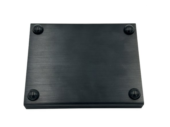

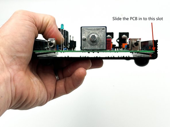

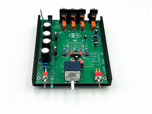

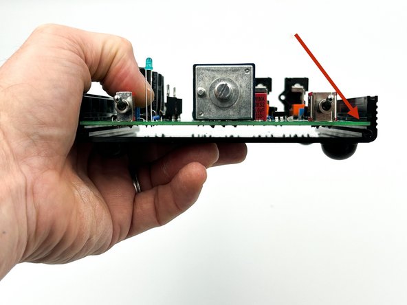

  26. Choose one half of the clamshell chassis and install the 4, stick-on feet at each corner. Placement is not critical, but the feet should not be removed and replaced, so be careful with your alignment. The side with the feet is now the bottom of the chassis. Note - Feet may be a different style and vary in color based on availability. In the bottom chassis half, slide the PCB into the middle slot in the  side rails with the components facing toward the top. See photo 2.
    • Choose one half of the clamshell chassis and install the 4, stick-on feet at each corner. Placement is not critical, but the feet should not be removed and replaced, so be careful with your alignment. The side with the feet is now the bottom of the chassis.
    • Note - Feet may be a different style and vary in color based on availability.
    • In the bottom chassis half, slide the PCB into the middle slot in the side rails with the components facing toward the top. See photo 2.
    • Photo 1 - Feet installed on the bottom of the chassis.
    • Photo 2 - Slide the PCB into this slot.
    • Photo 3 - Top view.
  27. Gently bend the legs of the LED so that the tip of the bulb extends beyond the edge of the chassis. It does not need to be perfect. The LED should sit about 1/4" (6.5mm) above the PCB.
    • Gently bend the legs of the LED so that the tip of the bulb extends beyond the edge of the chassis. It does not need to be perfect. The LED should sit about 1/4" (6.5mm) above the PCB.
    • Ensure that the two legs of the LED do not touch / short together.

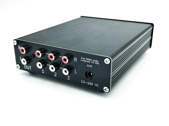

    • Slide the back panel over the RCA jacks. Ensure the jacks are properly aligned within their holes on the panel.
    • Use two silver, Phillips-head machine screws to attach the panel to the bottom clamshell.
    • Photo 1 - Back panel installed on bottom clamshell

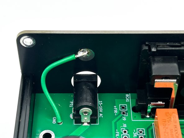

  30. If you haven't already, tin the end of the green GND wire.
    • If you haven't already, tin the end of the green GND wire.
    • Solder the green GND wire to the circular pad on back panel, as shown.
    • Photo 1 - GND wire soldered to back panel.

    • If you haven't followed previous instructions, gently remove U3 from the socket
    • Measure the voltage between GND (black DMM probe) and pin 8 (red DMM probe) of the op-amp socket. You should measure +12VDC +/- 10mV
    • Measure the voltage between GND (black DMM probe) and pin 4 (red DMM probe) of the op-amp socket. You should measure -12VDC +/- 10mV
    • Flip the input selection switch to all positions. You should hear the relays click faintly.
    • Turn off the power switch and disconnect the power supply.
    • If both voltages measure correctly, and if the relays are functioning, install U3. Double-check the orientation. Ensure that the 'notch' on the PCB for the SOIC version aligns with the notch on the primary PCB silkscreen (and the socket). Ignore the dot on the part.

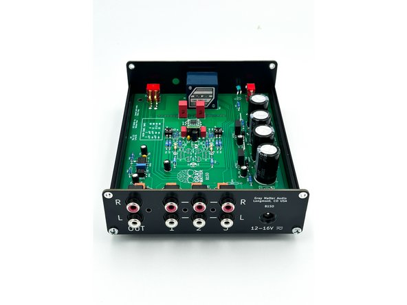

  31. Place the top clamshell onto the bottom clamshell. They are keyed and will only install one way. Use the two remaining hex-head machine screws to attach the front panel to the top clamshell.
    • Place the top clamshell onto the bottom clamshell. They are keyed and will only install one way.
    • Use the two remaining hex-head machine screws to attach the front panel to the top clamshell.
    • Use the two remaining silver, Phillips-head machine screws to attach the back panel to the top clamshell.
    • Install the the large nut on the potentiometer shaft. Do not over tighten but be sure a good electrical connection is made between the nut and the pad on the front panel. This grounds the knob, which prevents hum when you touch the knob.
    • Install the three, Phillips-head, sheet metal screws to anchor the RCA connectors to the back panel. The screws may be black or silver. Do not over-tighten. (Photo shows black screws).
    • Attach the volume knob to the potentiometer shaft using the included 1mm hex key.
    • Photos 1 and 2 - Looks fantastic!
